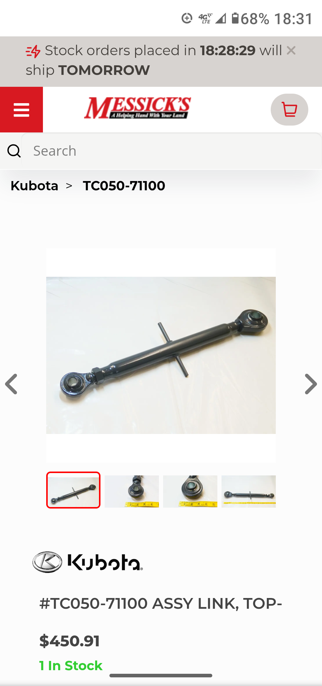

I leave the hydraulic lift link on all the time. To compensate for bleed down, I use a manually adjustable lift link on the opposite side. I adjust it to match the length of the fully extended hydraulic link
I use a similar tactic when I am working with something where I need to find level on the side links quickly: I have the manual link on the left and my hydraulic link on the right. I adjust the manual link so that the implement is level when the hydraulic link is as short as it will go. If the hydraulic link leaks down (or if I've adjusted it down to crown a road or something) I just hit the remote lever, retract the hydraulic link all the way, and the implement is level.
