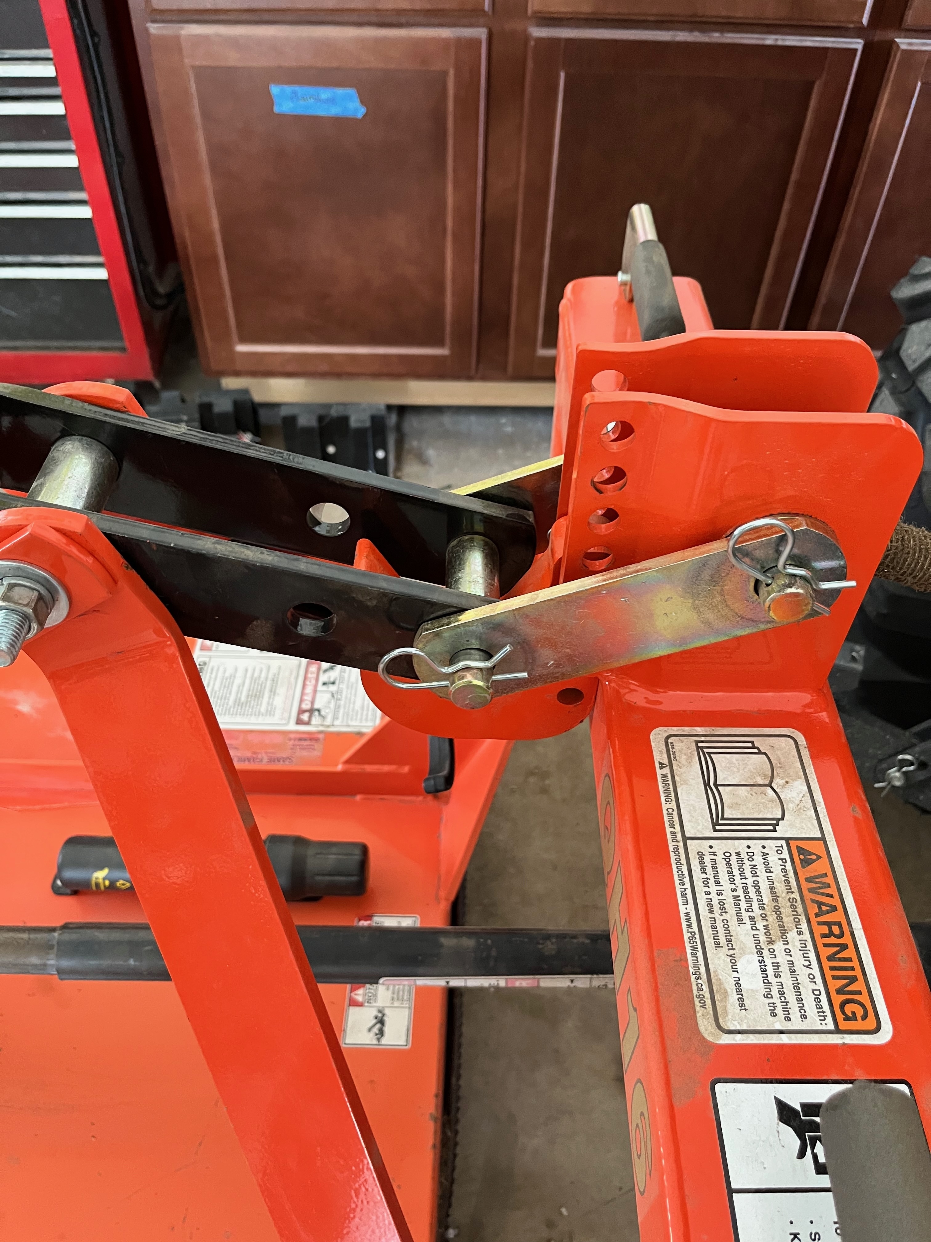

I'm not familiar with that floating toplink, but it looks like it would work better with the QH hook removed. As it is now, the rear of the deck can't go any higher. the pin is already bottomed out in the hook. The rear could drop very slightly (only enough to get the link pieces straight).

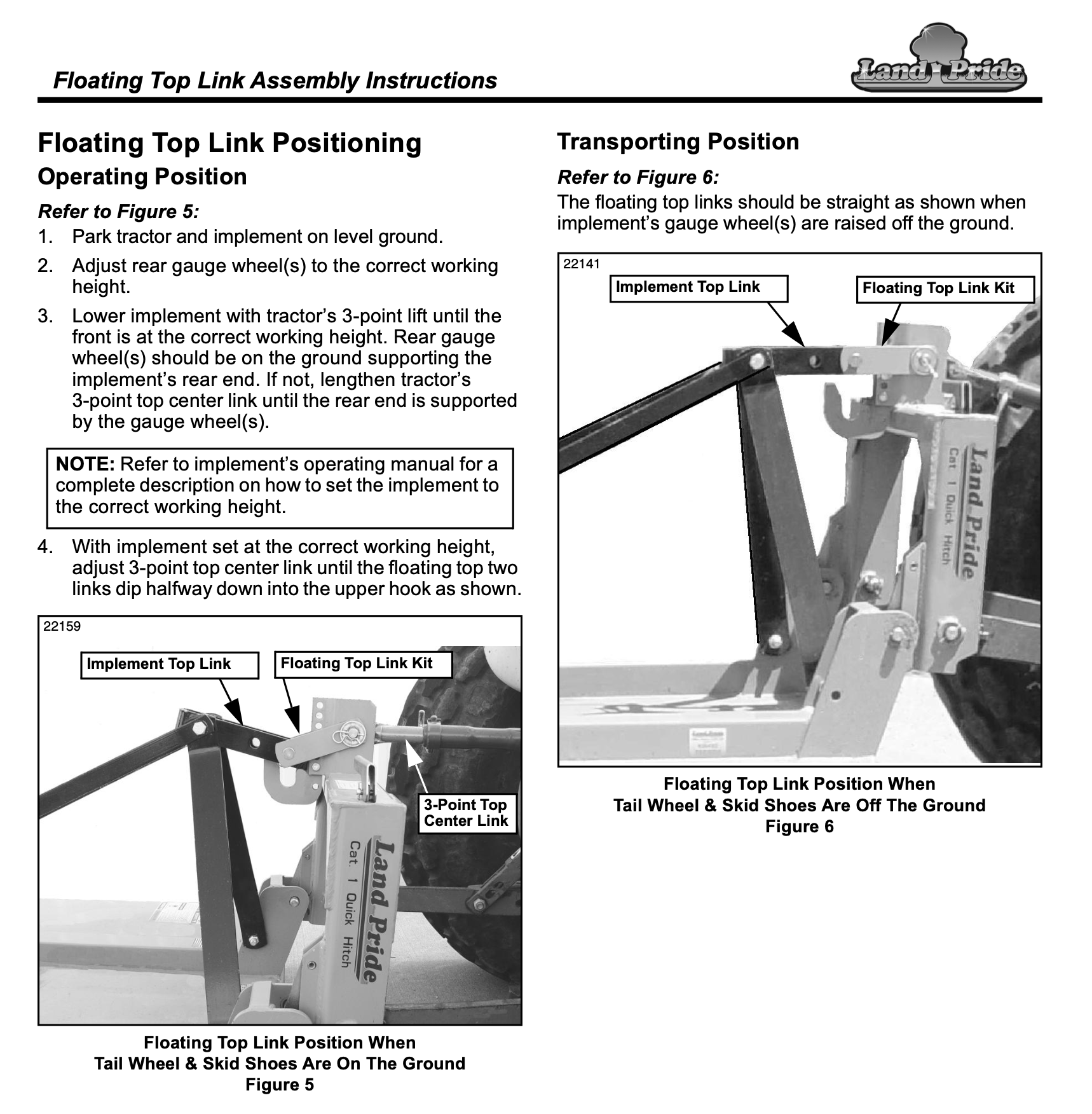

Good call. Although I went through the setup procedure, I didn't get it completely dialed in. Here's the setup instruction set (kinda weak):

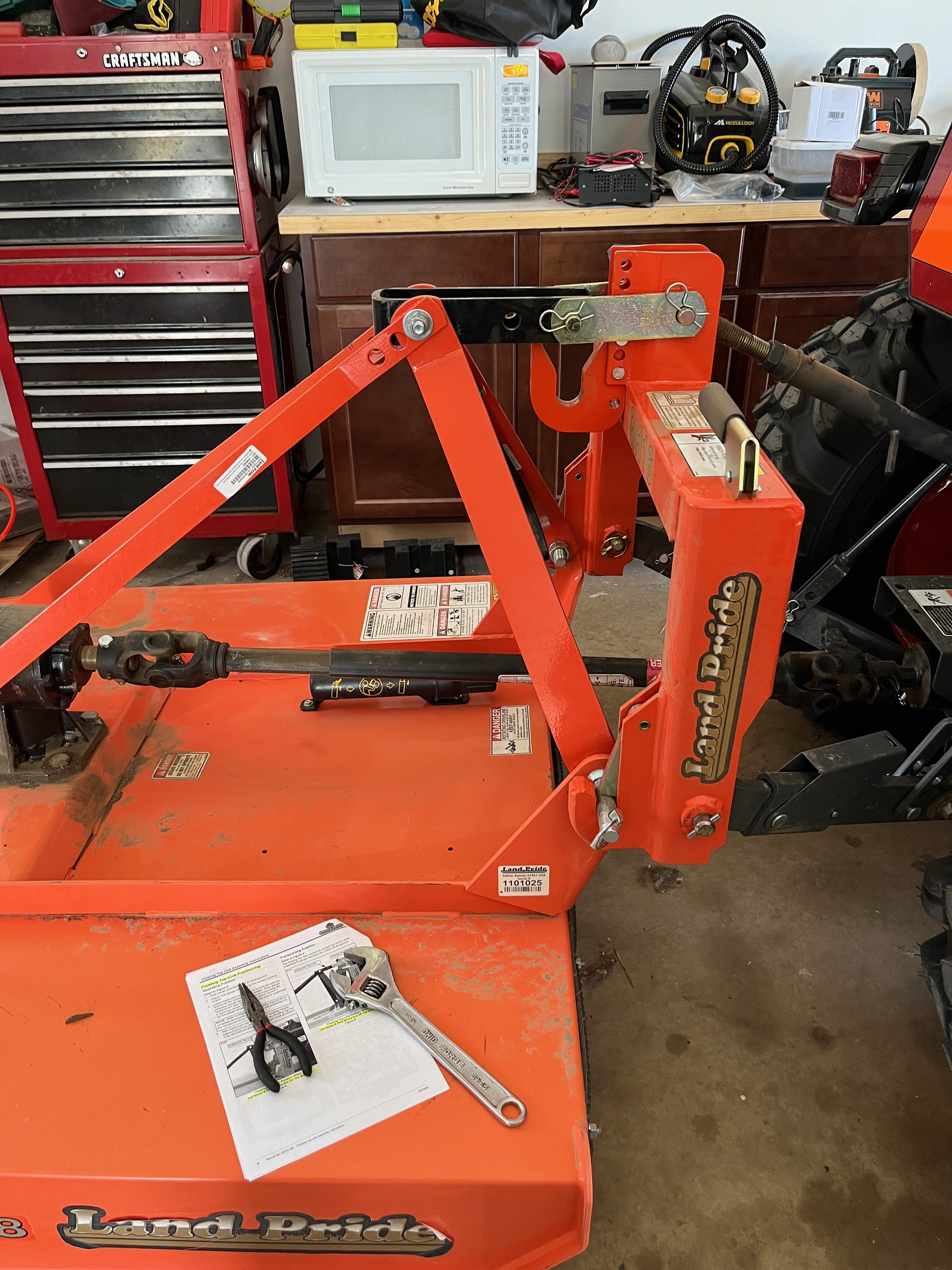

And here are my results...Just as shown and much more flex at the top link:

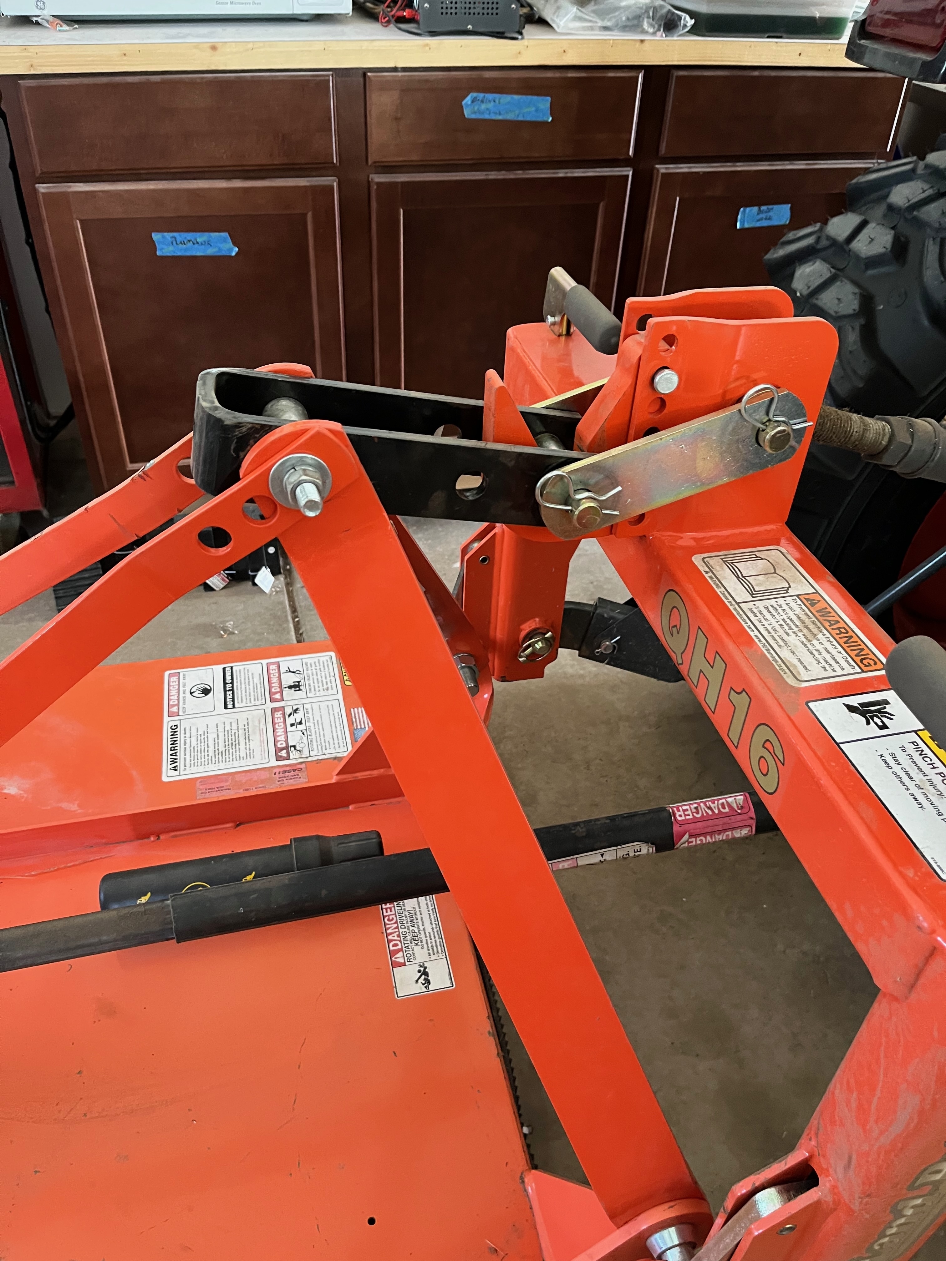

And this is the off-ground condition:

Your second picture with the hook lowered looks better.
