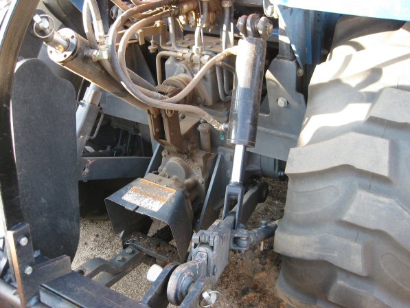

Here is some more info regarding my "TnT" setups. Both of my tilt cylinders are set so that the hydraulic is at mid stroke when implement is level.
My cat 1 has a 2x4 cylinder. I get 8 degrees of angle in each direction. With a 66" wide implement that is about 8" of movement in each direction on the cylinder side.
My cat 2 has a 3x8 cylinder. I get 11 degrees of angle in each direction.
With an 81" wide implement that is about 12 3/4" of movement in each direction on the cylinder side.
I guess what I don't understand is why do you guys want to be able to cut a steeper cut? It's not like you are going to get a 22 degree cut 18" deep in one pass. :confused: And for those of us that have rear blades with tilt, between the side tilt on the 3pt and the rear blade tilt, we can get close to 45 degrees if need be. So with just the 3pt, if you put your tire in the first cut ditch, then the second time you can get around double the angle of the first cut. And most likely you will need to make at least 2 passes anyway.
I am probably missing the obvious, but would one of you explain the desire to have such extreem tilt.

Also - - what are the sizes of the cylinders you used for top and side. You said that the cylinders were "with check valves" - not sure I understand this either.
Thanks for the help,
Reggie
Reggie,
I almost forgot to get you the cylinder sizes.
Both cylinders are 2" diameter.
Top link in the closed position. Center of pin to center of pin is 21"
Side link closed is 17 1/2"
The check valves on top and tilt cylinders Keep the cylinders from leaking/drifting down.
I originally tried top &tilt cylinders without check valves and my tilt cylinder would always drift down and not be level.
I later switch to top & tilt cylinders with check valves. I recommend them, they never drift off.
