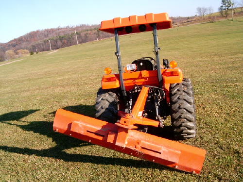

#69
The top link and tilt cylinders are from CCM with check valves.
Vince, with your 3pt set up like it is in the picture, does your tilt cylinder tilt your blade down to the left and right? From the pic, it looks like it only will only tilt the right side down. :confused: Can you please confirm this.

/ How many "TnT" owners #71
My hydraulic tilt cylinder will tilt down the right side.
I have a manual adjustable link on the left side if I need it. But so far I haven't really needed it.

Brian, that is how mine is set up most of the time, allows me to cut a ditch at a sharper angle. You can see why I wan't to use two cylinders for tilt to allow tilting either side as pictured above.

I tried having my ram at the half way point so I could tilt both ways.
I just didn't like it there, seemed like I lost to much lift hight in my 3 point. Also felt I had to quess where level was when resetting the ram back to center.
