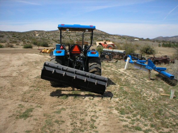

MtViewRanch,
No problems with full tilt, this is with the left adjuster wound up short and the hydraulic cylinder on the right fully extended. Here are some old pics of my boxblade in the full tilt position, normally I would use the rear blade in this configuration.
/ How many "TnT" owners
#25
Steve,(is that ok?) what is your normal configuration, how do you have your side links set? I think that Rob has 8" or 10" stroke cylinders, I wonder if he has any problems. Here is a pic of mine in full tilt with the side links set at the 1/2 way point for the hydraulic. I'm guessing that I have a total range of movement a little over 2' in this configuration.

/ How many "TnT" owners #26
Brian,
I have the plane on my tractor right now and will take some pictures in the daylight tomorrow with the adjustable links in the various positions for you. It is a little to dark right now.
