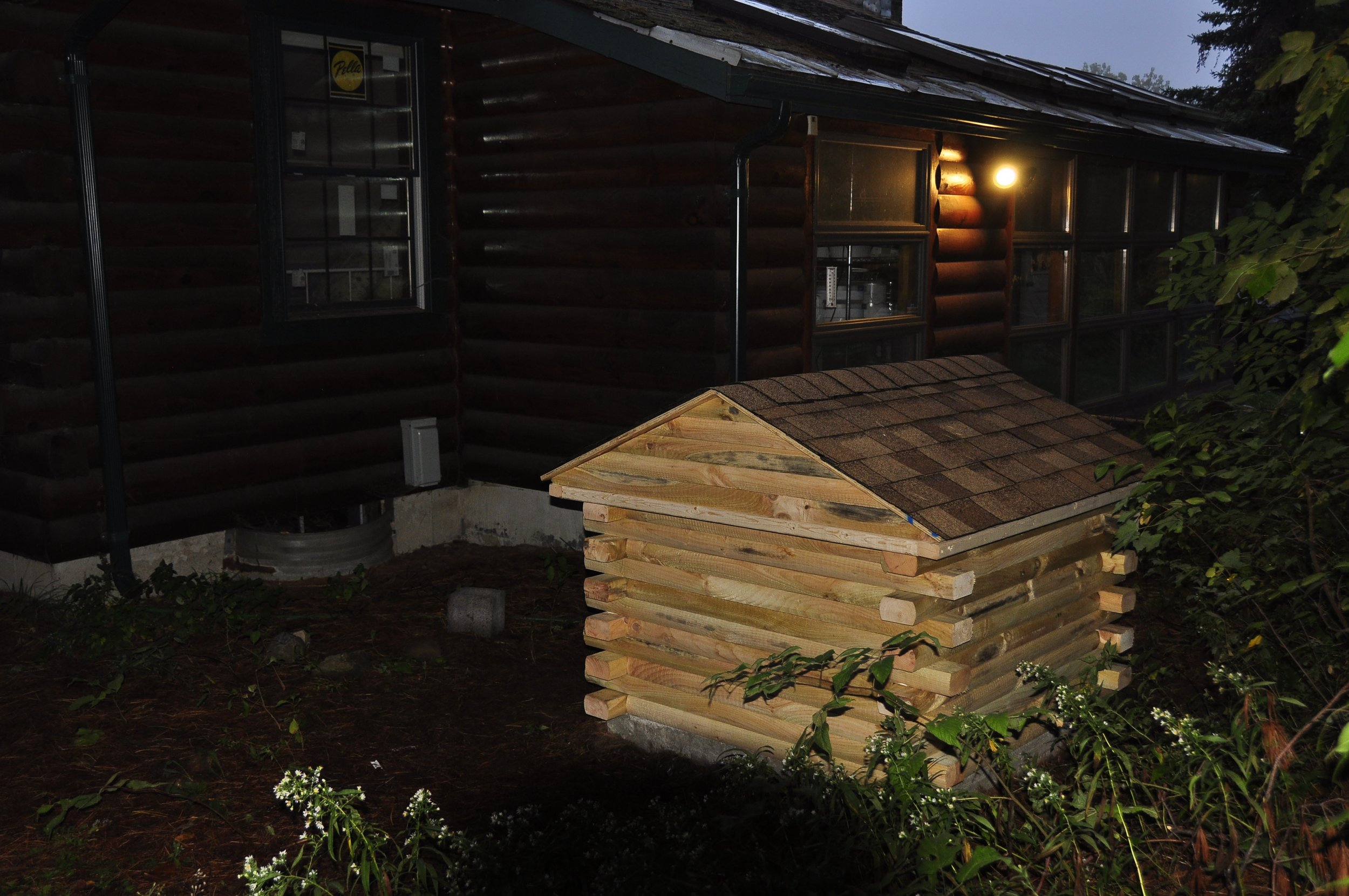

I built a log shelter to put mine in, matches the log house. Added pressure struts to assist in lifting the roof so I can access the generator. I have an exhaust pipe extension that attaches to the generator's tailpipe to get the exhaust out of the shelter, and the eaves are open to allow for fresh air intake.
