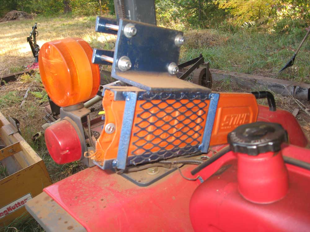

Made a scabbard for the saw screwed a couple brackets on the back of it to hang on the piece I welded together and bolted on the tractor where there was already accommodation on the loader post.

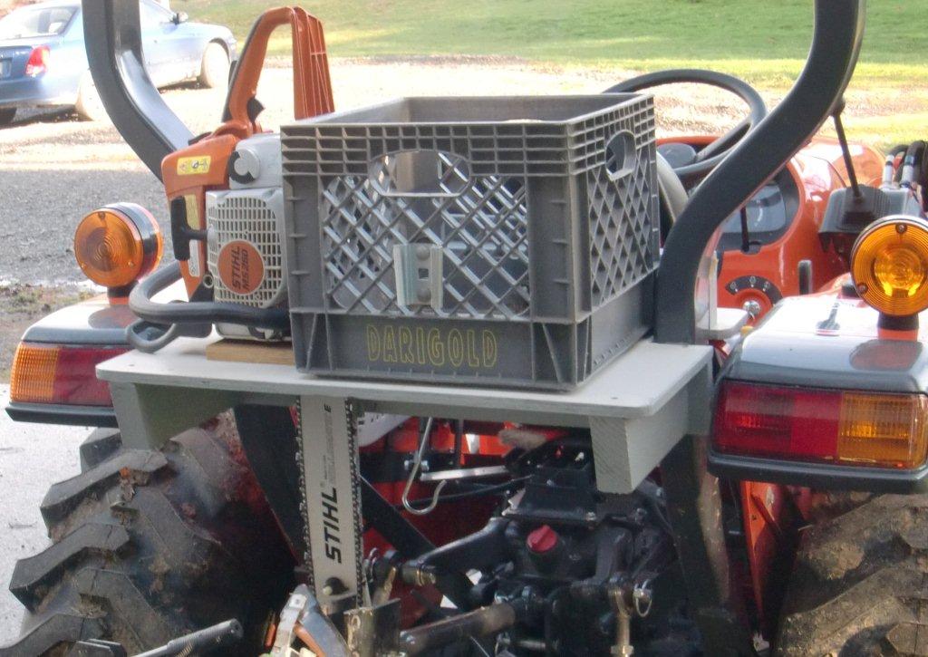

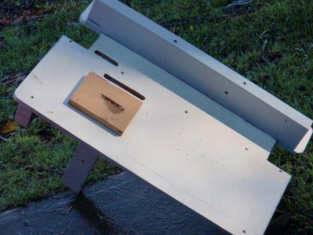

Gordon,
That looks very functional. How is the box attached to the large plywood base? Also the large plywood looks attached to 2 plywood "feet" that sit on the tractor sheet metal.
How are those attachments made, and do you have any rust at the metal to plywood interface?
/ How do you carry your chainsaw ? #72
"Functional" is a good way to describe it.
I put a cross support between the rops. Couple pieces of light angle with a PresureTreated wood spacer.
Then I have a plywood shelf that just lays in there. The rops locks it in place in a dado cut on the bottom of the plywood. There is no rust on the fenders because I use it every day but the paint is wearing off a little. You could glue a piece of indoor/outdoor carpet on the plywood to slow down the ware.
Then the box just sits on top also locked in place between the rops with a couple wood cleats on the side of the box. There are no fasteners so I can take it all off except the cross support w/o any tools.
gg

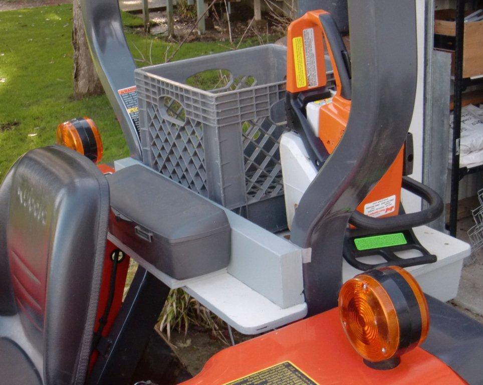

It is nice to have a thread with all these good saw carrying ideas in one place. Something for everybody.
Here are the two saws on my M5640. One on the loader post - pretty common. The other in back with a tool box.
