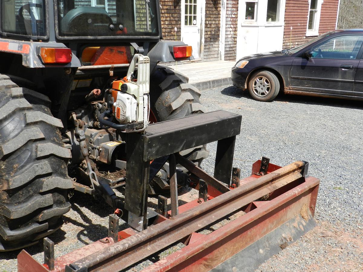

Just had 35 acres logged and have a mess in the woods to clean. I know I can throw the chainsaw in the RTV 1100 box and go but I also use the TC55 NH for clean up ( when the saw gets the best of me and I need a break ). I don't want to drill holes in the loader mounts and it won't fit well on the Bradco backhoe. I would like to fashion something removable... maybe attach to the ROPS with a bracket. Before I go off the deep end in thought I would like some tried and ture solutions. Thanks in advance..
/ How do you carry your chainsaw ? #3
4" or 6" pipe pending on size of the bar/chain. attach pipe to tractor somehow, and then drop chain saw bar down into the pipe. may not be best approach but *shrugs*
/ How do you carry your chainsaw ? #4
I have a cab tractor and couldn't figure a good place to attach a scabbard. However, I have a scabbard on my carryall and one on my box blade and am planning on attaching one to the chute of my chipper as well. All are made from two pieces of PT 1X6 decking with thin plywood spacers along each edge.

I found a plastic drum about 12" in diameter that is about 28" long. I'm thinking of cutting the bottom open to slide the saw, gas, oil, and tools in mounting it at an angle. The top has a handle which will also make a good anchor point. For now its going on the box blade. The thought process continues for the backhoe. Certainly better than trying to hang on to it while driving..

Here's a pic of the one I fabbed up for my JD 790. It's a dual purpose bracket that holds the chainsaw and a fire extinguisher. I have a complete thread on this, but if you want to see more, you'll have to search for it, or I can find it for you.

Stewie1 if ya have a minute could you post a couple more pics
from other angles of that CS hanger please? Nice Job!
/ How do you carry your chainsaw ? #17
Artisan, here are a couple more shots I have on the computer......
Apart from wrapping bicycle inner tube sections around the ROPS, everything including the long clamping bolts were in the box!
Another freshly installed shot
And a couple in the field
The chainsaw bar is clamped between 2 foam pads and the body of the saw rests on a third - the saw will not come loose even if you roll over....
You can also tightly close the clamp when ther is no saw in it
Hope this helps, I can take specific shots if there is something specific you would like to see.
