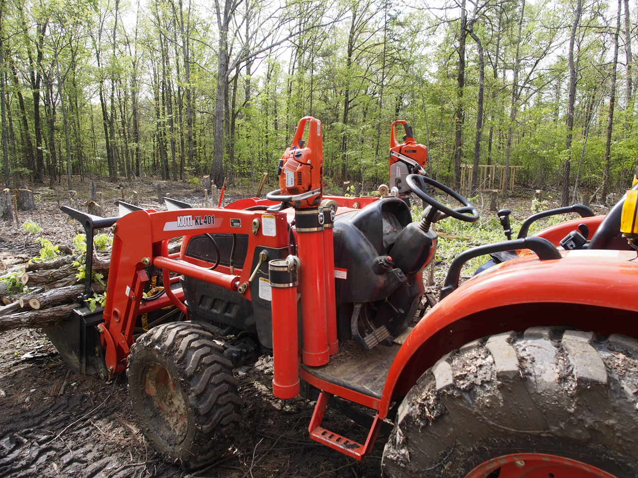

I have a piece of 4" pcv vertically attached to my tractor. I used to carry a Stihl MS170 in it now carry a Dewalt 20 volt chainsaw. I bungy ball the handle to the frame so it wont flop around or bounce out. Its very handy for cutting the little surprizes laying around. Both will nicely cut through a 8-12" fallen tree to move ot off the driveway if needed.

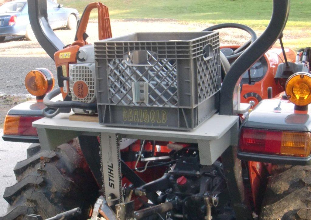

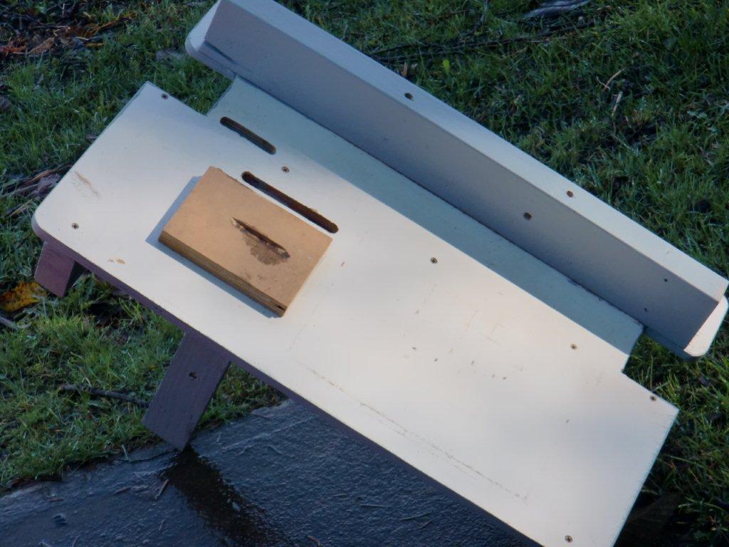

I just built a ballast box/carry-all and mounted my chainsaw on the side, test drove it down the fence/wood line and it seemed to ride ok mounted there, time will tell, might put some metal brackets around the top and bottom of the scabbard.
