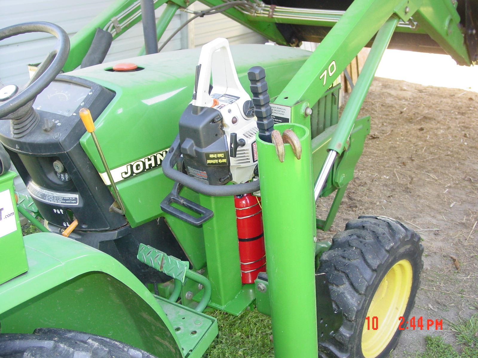

I put a sleeve on the side of my weight box for the saw, gas, oil & tools in the top of the box.

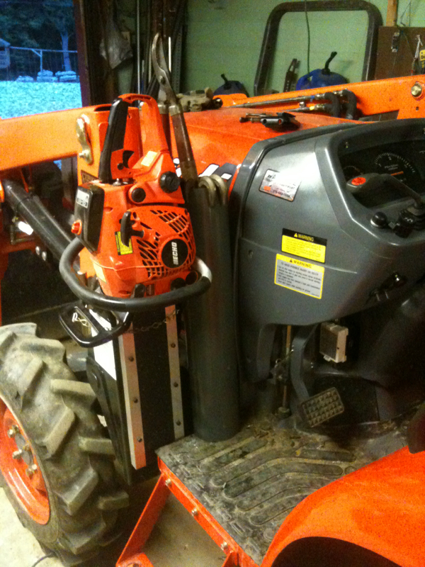

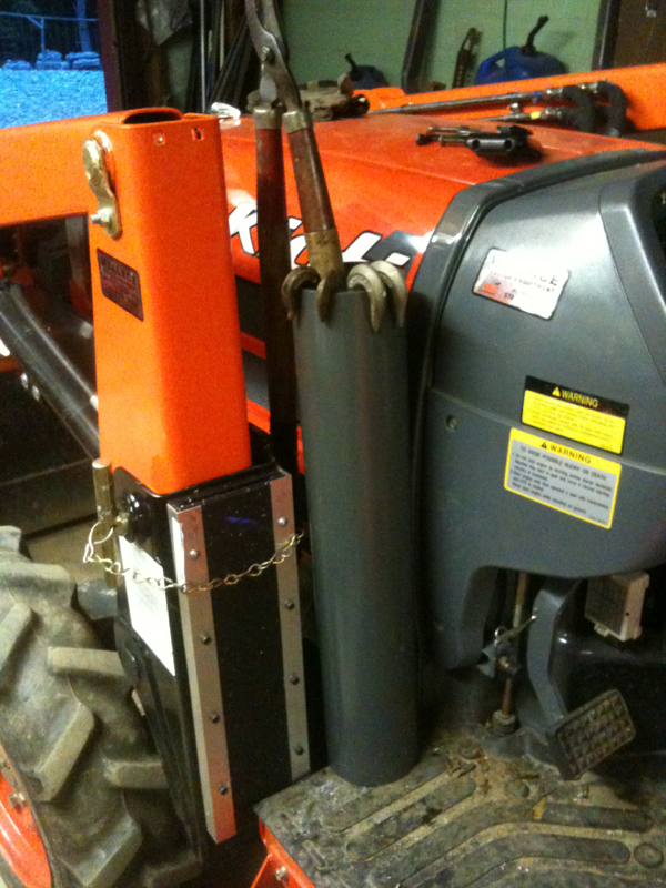

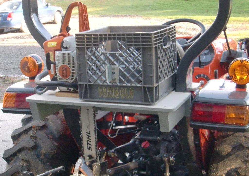

I was afraid of bending my bar due to the ground I usually operate on so I created this setup. While its not pretty it secures the saw and I don't worry about bending the bar.

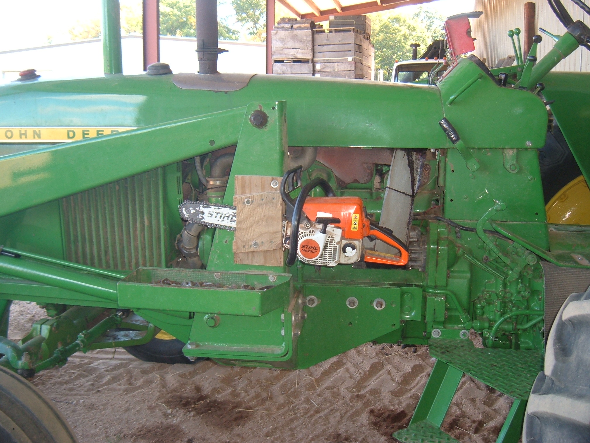

Here's mine all from scrap... The plastic bar cover was part of a case that the local hardware store lost so they gave me the other half for free. The bottom of the bar cover was cut out to avoid water /debris accumulation. The assembly mounts with a single 5/16" bolt and "clamps" around the splash guard 1" steel pipe on the tractor.

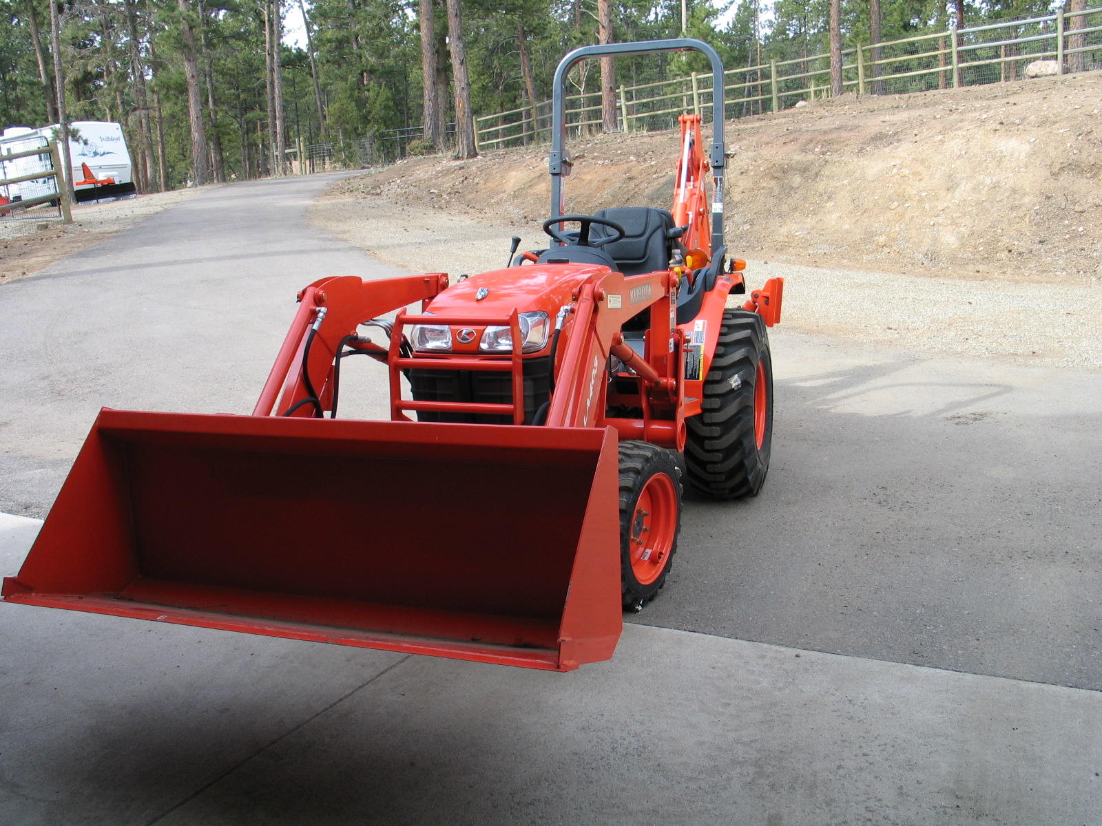

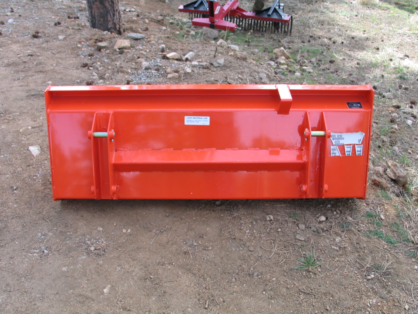

I carry mine in this handy attachment. It's been painted to match the machine color, and is also easily removed and attached to the tractor with a "Quick Attach" system. It is large enough to fit 2 chainsaws, a fuel jug, a couple containers of bar & chain oil, my safety gear that I wear when using the saw, rope, come-a-long, racheting straps, and a cooler for non-alcoholic drinks.
Pics are when it was shiny new.
:D

It works great to haul the saw until one forgets the saw is in the bucket. Ask me how I know:)

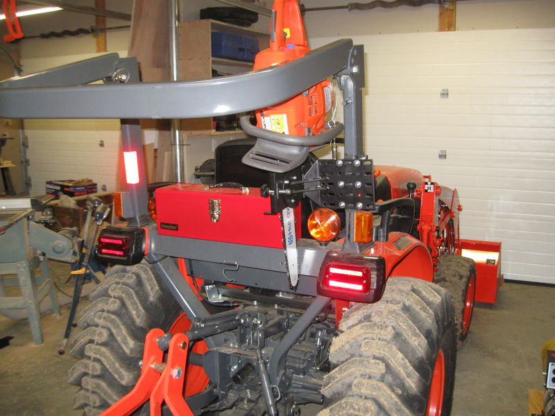

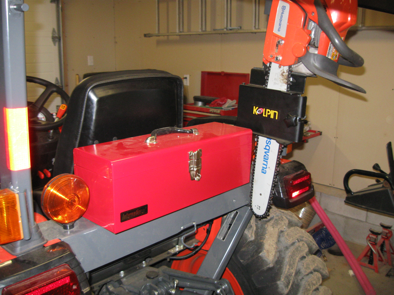

I finally got around to painting my carry all and took some pictures. I've been using it all summer and it works well. Surprisingly strong - I stood on it as a test. One downside is it obstructs the rear view some.
/ How do you carry your chainsaw ? #38
<img src="http://www.tractorbynet.com/forums/attachment.php?attachmentid=291812"/><img src="http://www.tractorbynet.com/forums/attachment.php?attachmentid=291813"/><img src="http://www.tractorbynet.com/forums/attachment.php?attachmentid=291814"/>
That looks awesome, and no more having to look under the seat for the toolbox!
Now that's an innovative way to hook it onto the ROPS!
Did you use any hardware at all to attach it, or is it just wedged and "gravitized" into place?
/ How do you carry your chainsaw ? #39
No hardware to attach. The crossbar that held the toolbox keeps it from sliding down, but the lever action against the rops serves to carry the weight. It lifts right off when its empty.
/ How do you carry your chainsaw ? #40
That's what I thought, but I had to ask for sure. :confused:
That's one of the things what I like best about it- no futzing with bolts, straps, or other stuff, just get it on and go. :thumbsup:
When you need it off for some reason, unload and go. :cool2:
