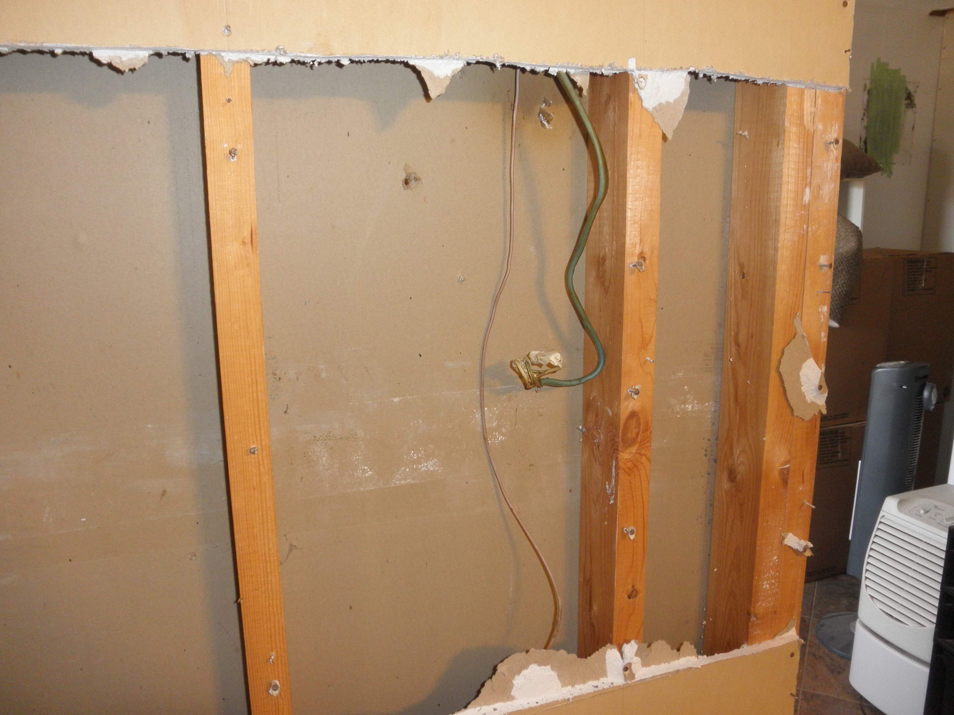

Found this when I opened up the walls when doing my kitchen remodel. Also found similar "issues" behind a closet wall and in the attic.
/ House wiring rant #45
AHA !!! I could recognize grsthegreat's handiwork anyplace.....:laughing:
dammmm , you cough me :laughing:
I have a nifty side cutter that removes the crimp sleeves in 1 second flat....

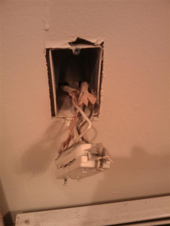

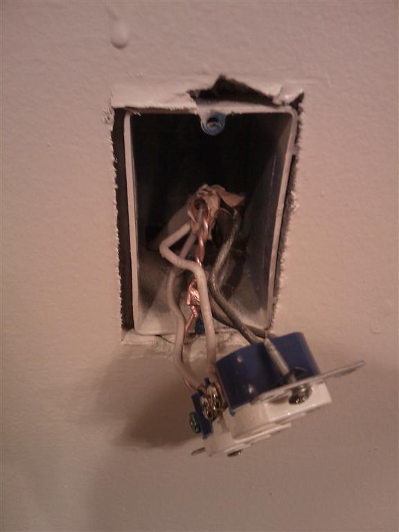

I was working on the outlets in the kitchen/dining room tonight.
I twisted the grounds together (so that they were tight enough to not wiggle) and added a crimp sleeve.
I then replaced the white decora outlets with almond regular outlets.
After:

Generally, I pigtail the switch/receptacle grounds to the box ground and the equipment grounding conductor. Up to 6 12 awg grounding conductors in a 4 gang box. I use a gray wire nut, one rated for the number of conductors being bonded. I never heard of a green one in multiple sizes.
Are these crimp sleeves rated for this purpose? (multiple conductors?) I've never used one.
