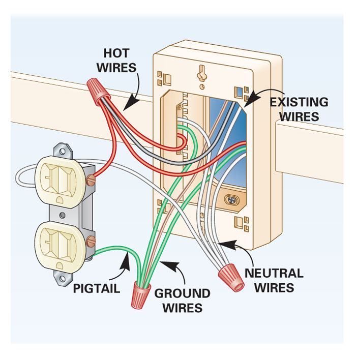

This is probably not typical, but I'd say a better grounded method - providing the initial ground (green) lead is properly terminated/grounded. I'd wrap the wire nuts with tape too.
/ House wiring rant
#13
That or using a crimp sleeve in place of the wirenut is how I was taught to do it and now most professional electricians I have seen do it.
It is a personal preference, but I like to use the Ideal brand "wing" wirenuts (like: http://www.lowes.com/pd_26049-12704-30-441JL_0__?productId=3128373) as I feel that they are less likely to come loose when packed into a box than the ones without the wings on the sides.
Also, Ideal makes a driver for their "wing" wirenuts (like I linked) that lets you spin them on and twist the wires together with a drill (great when joining 12 several gauge wires). A regular 6 point socket will also fit (5/16" IIRC).
Aaron Z
/ House wiring rant #14
What I don't like about the method illustrated is that it creates a LOT more wires to cram back into the box, and there is the possibility of a bare ground wire touching the hot terminals. When we hired a guy to wire our addition, he left so much excess wire, even with the deep blue plastic boxes, he was using the wood handle of his hammer to compress and severely kink all the excess wire back into the box before screwing in the switch or outlet.

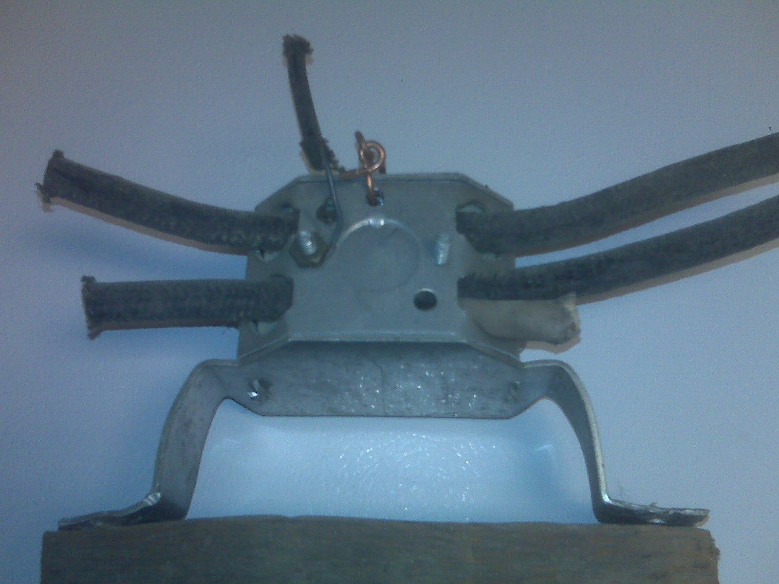

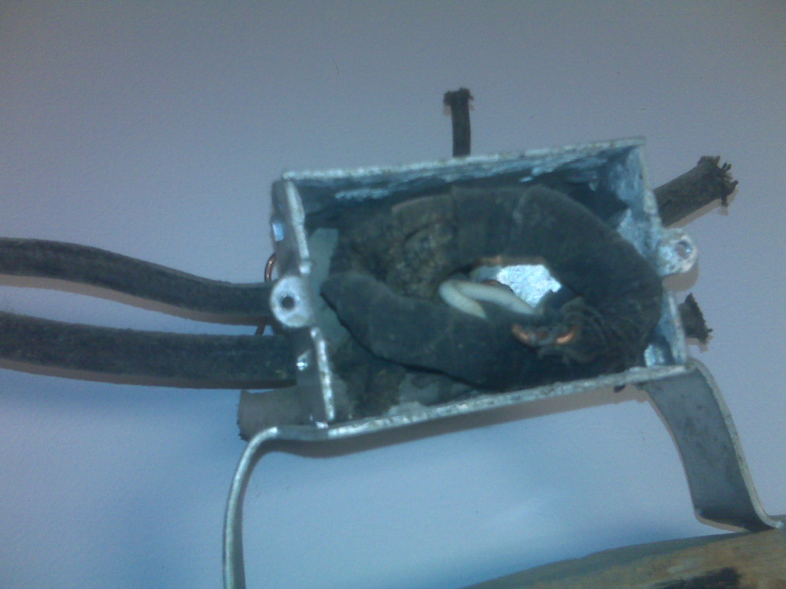

Knob and tube doesn't scare me as bad as this attachments do. Back in '88 I purchased a 1949 vintage kit house, the prior owner had hired someone to come in and install a new medicine cabinet, wall outlet, and switch back in '78. In late 2001 I wanted to rewire the bath so I could install a ceiling vent, took the medicine cabinet off, and found this junction box...ALUMINUM, 2X3 inches outside,with all the wiring crammed in. The guy who did the job back in '78 simply ran the beige romex 14 gage inside the splices to add another circuit...when I saw this ugly thing it almost gave me a heart attack. The bare ground wire at the top is what I use to hang it over my workbench, and the rubber covered single wire at the top ran into the basement where it was clamped to a cold water pipe (galvanized)

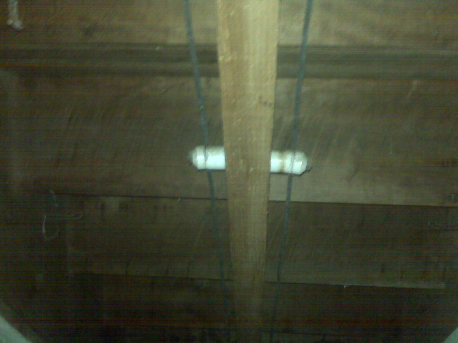

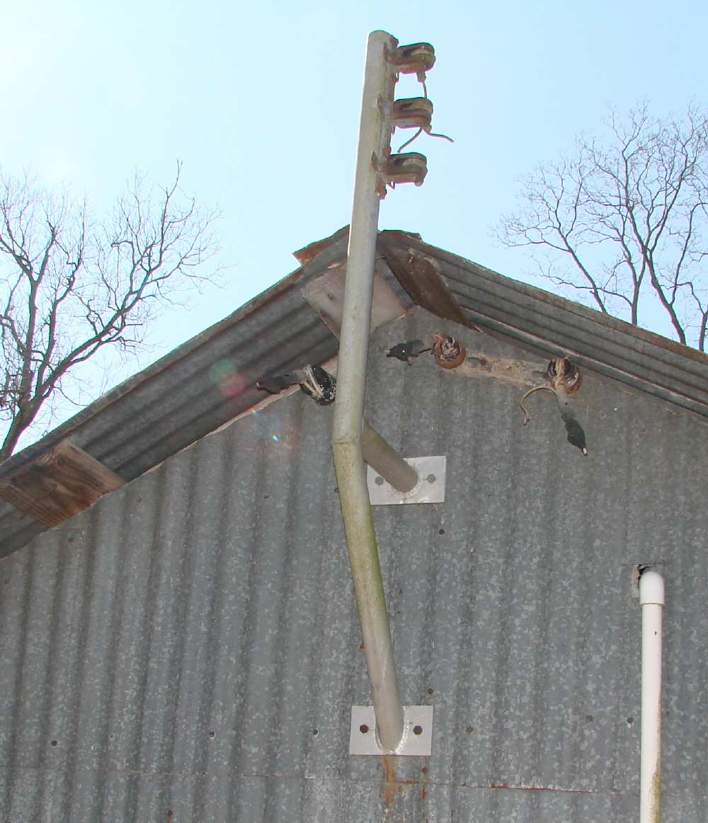

Knob and tube wiring was the standard way that unattached garages and outbuildings were wired to homes in our area up until the 1940s.
It is not unusual to still see k&t wiring outside homes today. Wiring on this shed was up but not connected to power until Katrina.
