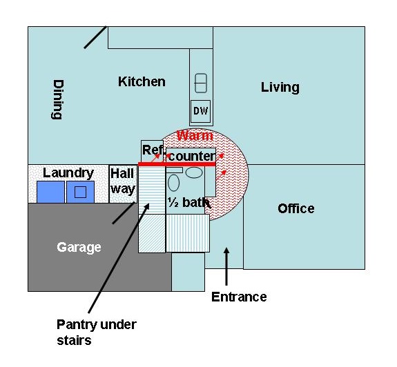

I'm adding a very rough sketch of the downstairs layout with the stairs going up to the 2nd floor. I've used a dark red line to show where the wall is that is leaking from under the baseboard. the red circle shows how far the water ran out and soaked the entrance carpet, some of the office, and some of the living area. I tried to show the location of the dishwasher and where the warm floor is located.

The mystery is over. The leak has been located. The detection company pressurized the hot water line with air and could hear it hissing under the pantry room where water was coming out from under the baseboard. They believe water was travelling down around the hot water line going to the kitchen and that it found a place to pool under the tile in the kitchen walkway. It also seems that the hot water line did not leak until it heated up. Therefore, water had to be used in the kitchen to bring the temperature of the pipe up high enough to bring on a leak. Since water to the upstairs bathrooms and other locations did not flow through this line, the pinhole leak did not form. The reason no water ran at the meter was that the dishwasher and kitchen sink had to be running to heat up the pipe and bring on the leak. My daughter said you could clearly hear their leak with the equipment when they pressurized the line.
Now they have to drill down through the floor to make a repair. It's too far from the edge of the house to tunnel in. They aren't sure if the leak is going to be in a slab foundation beam. If it is, it will cost much more to fix. Also, there is a method called "E-Patch" which injects epoxy into a line without having to open the floor. This method has a 5-yr guarantee and they are checking if it is allowed by code. It would be the cheapest and least disturbance if it is allowed.

What stands out to me in the drawing is that the clothes washer is really removed from the wet area. And that the dishwasher does not have wet carpet right next to it.
Then there is that wall with the bathroom. It seems like the bathroom vent and/or plumbing are in that wall. Is there a bathroom on the second floor that might be using the same wall for the vent and/or plumbing runs? Is the shower the kids are using near that wall?
Maybe the warm tile floor is a red herring regarding the leak....
Later,
Dan
