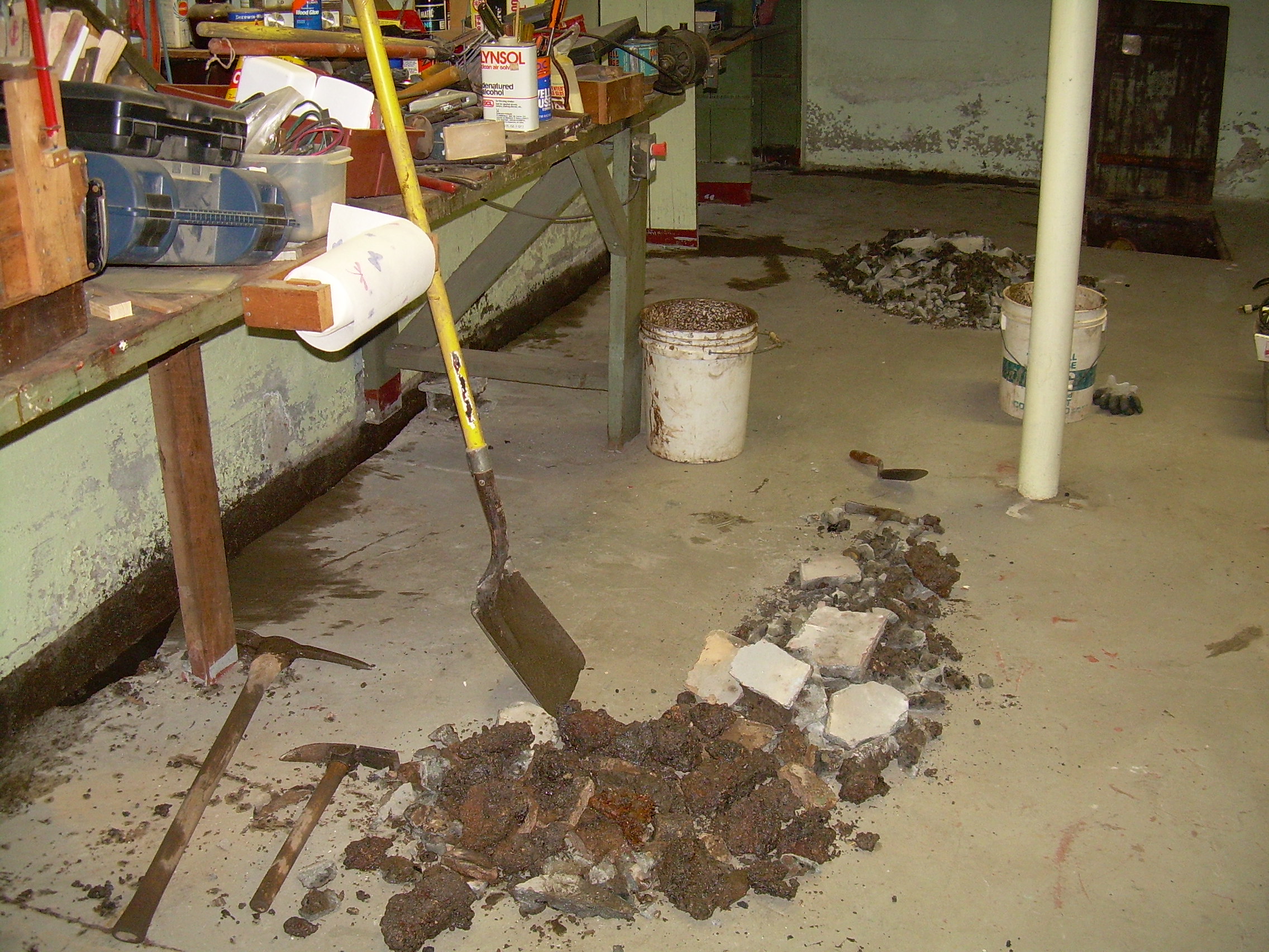

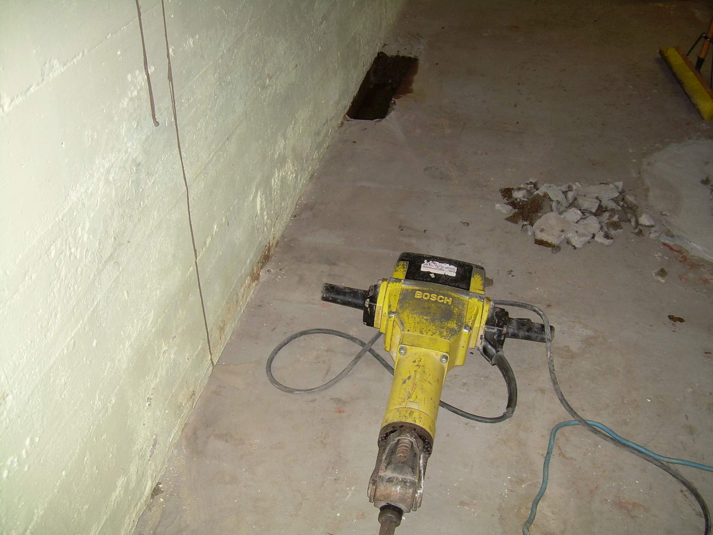

What those guys will be doing today with the jack hammering and digging under the floor is what I'm usually doing with the waterproofing work.
I'm in the basement but a good percentage of those are in finished spaces. It does cause alot of disruption when you have to use a jack hammer in a finished room :eek:
JB.
