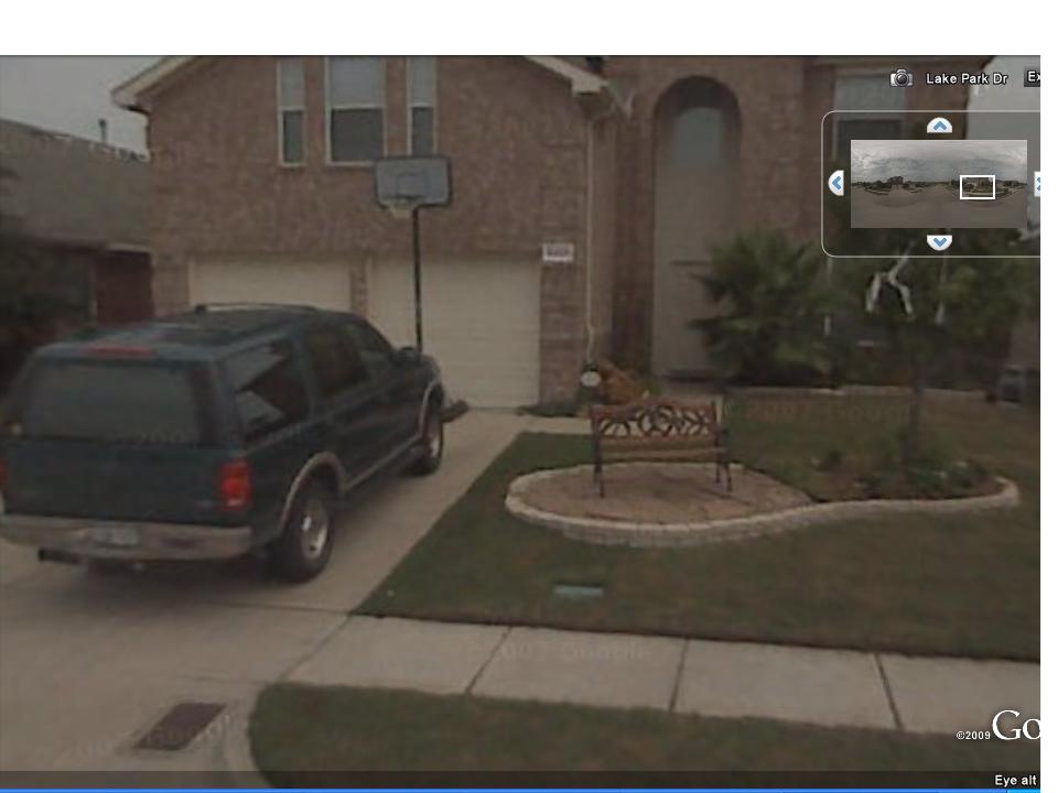

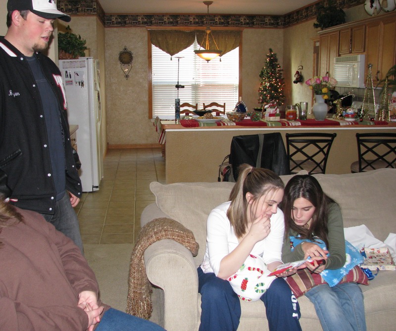

You guys are all asking questions that I've gone over and over in my mind. That's good, because it means that there is not something I've missed.
I don't live near my daughter (about 80 miles away) and that's caused me to advise and ask questions mostly over the telephone. We did go by her house last Saturday afternoon when the plumber was there and that's when I did all my hands-on checking. For what he could do, I thought the plumber was very thorough in his checks. He had a flashlight and was looking and feeling in all the correct spots. The water had been on, but nothing used in the house for over 1 hour and the meter at the street showed absolutely no movement. This is not a pressure leak. It has to be associated with a drain. At least that's what it shows by the water meter. The plumber assured me that any slow leak would show on the meter, especially after 1 hour, but the meter was dead steady and not moving. My son-in-law had opened the wall behind the downstairs bathroom sink and also in a small coat closet in the entryway. Of course, that baseboard and bottom plate inside the wall was moist from the night before, but it was not very wet nor flowing.
They did find one 3" PVC drain that showed shoddy work. Sometimes the rough-in of drains is not exactly in the right spot. I'm told that there is a sleeve you can put around the PVC and use electric current to heat up the pipe so that it is soft and can be slightly manipulated. What we found was that they had instead used a propane torch to heat up the PVC and bend it slightly about 6" above the slab. The pipe had burn marks all around its perimeter where it was heated with the torch. Even so, with repeated flushings and shower drains from above, that PVC never leaked a drop. However, if it turns out that this is the drain pipe leaking beneath the house, I think my daughter surely has a claim against the builder.
Everyone has the right idea here. First, you make sure there is no pressure leak and then look for drain leaks. I think we are well into the 2nd phase of this and probably the scan will show results. I believe my daughter told me that they would not be able to get to her house until today or tomorrow.
What I know about this leak is it seems to be delayed. From what we can tell, it occurs only after the dishwasher has run or maybe after my teenage grand daughters take long showers. I believe the water is not backing up the drains because it is pooling beneath the slab and then slowly seeping up and into the house through some tight cracks or feedthrus. I know the dishwasher ties into the kitchen sink drain at about 2' above the level of the slab. The washer drain is also about 30" above the slab behind the washer. There are no downstairs showers or tubs for water to rise into. Actually, when my daughter called the plumber last week, they thought it was a downstairs toilet and replaced the wax sealing ring. That turned out not to be the problem and it is not leaking around the commode at all.
My daughter's carpet was soaked and she went through a dozen towels building a dam to stop the flow of water coming from under the wall. It sure seems like a lot of water to just come from leaking drains that are seeking level before draining on away down the pipe. perhaps the pipe is broken and offset, leading to a clog or partial clog with mud/dirt under the slab. That's what I'm thinking they will find. I just cannot get beyond that warm floor I felt in the kitchen. I remember looking at my daughter and asking if she had floor heat before realizing how silly a question that is in Texas. The next day, she had the flood.
Bird, you asked about the age of the house. My guess is about 10 years. This is a fairly new addition just east of the Bell Helicopter Plant in Hurst, TX. I've included a snapshot from the Google Earth Street View below. I've also included a snapshot of the inside of the house showing the bar/counter between the kitchen and living room. On the hidden side of the counter at the end is where the dishwasher is. The sink is about in the middle of this counter. The floor at the end of the counter is where it was very warm. Beyond the refrigerator is the hallway to the garage and the laundry room. Behind the refrigerator is a pantry room where most of the water seems to start running. Above the pantry is the water heater in a 2nd floor closet.
The air conditioner/heat pump evaporator is in the attic, but it has been on heat pump for over a month, so there is no condensation and its pan is dry.

I was gonna bring that up, but looking at the pic of the house it looks crowned on the lot (slab is above grade), so don't think it could be ground water, unless the house is built into a hill on the back.
Another thing it could be if there was alot of rain is the weather boot at the plumbing vent stack on the roof, we do see that often and the leak sometimes does not show up till down lower in the house.
I'm sure you've considered the location of the HVAC outlets. If I walk barefoot to our kitchen, there's a very noticeable warm area on the floor, but in our case, it's because the ceiling heat outlet is right above it.
A warm floor in the kitchen, with the water heater upstairs, does seem very odd.
