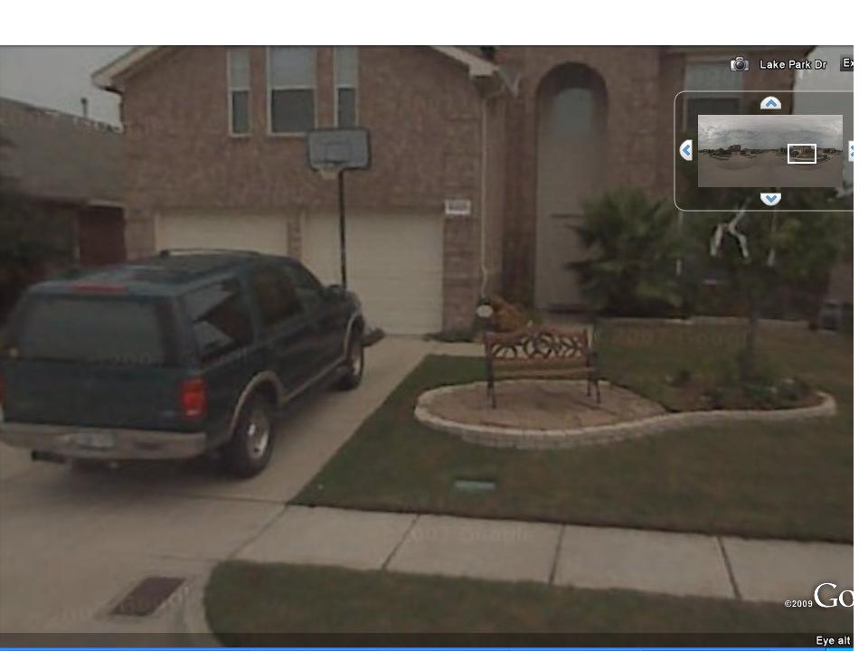

This is a long shot but possible. If the water is only showing up downstairs it is possible it is seeping in from the outside. I noticed from the pictures it looks like there are houses close by. It could be the water is comming from a neghibors house. A busted drain line underground from another house or her house, be it gutter drain or gray water. It could be seeping through the foundation wall or floor. You could take a long piece of rebar and push it down outside the house around the foundation close to the leak and see how soft the ground is. If your not findiing any water leaks inside from pipes or drains I would start checking outside underground. Good Luck.

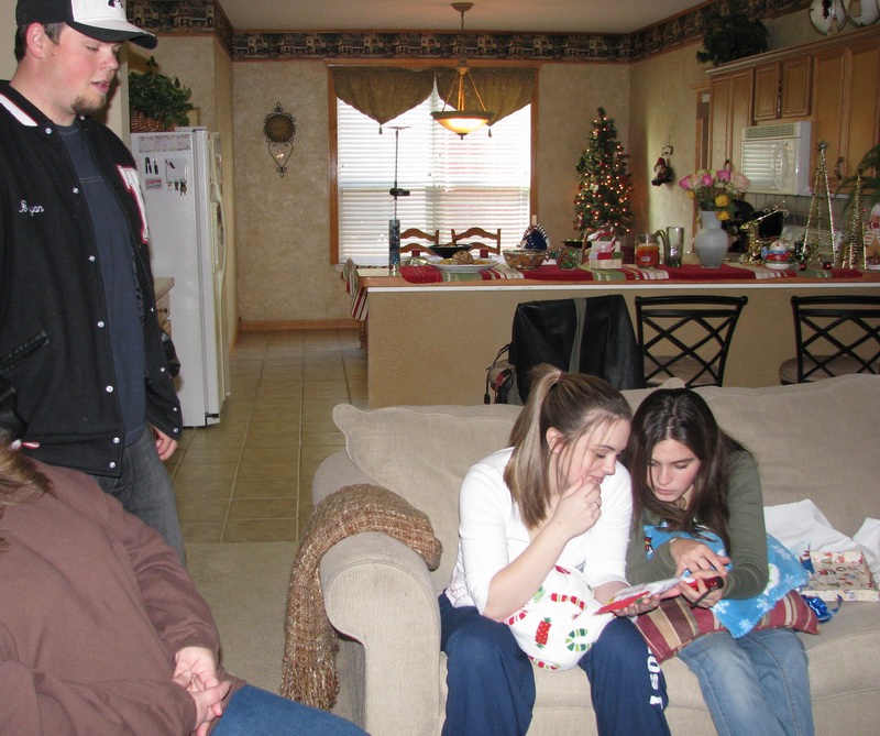

I'm still not clear where you are finding the water. Was the water itself warm? or just the floor tiles in one spot? The picture shows the kitchen, but I don't see whre the carpet is that's getting wet.

Eddie, when you look at the picture of the kitchen, you can just see where the living room carpet begins. The carpet also goes to the left in the picture toward the entryway. That entry breezeway carpet is wet and so is the living room carpet out to about 4' in front of the counter/bar. The water is coming from the wall behind the refrigerator. My daughter turned off all water to the house and got it stopped and dry. Then, she turned the water on and started running showers and sinks upstairs. Nothing leaked. Only after doing a load of dishes in the dishwasher did the leak begin. It started in a pantry behind the refrigerator about 1/2 hour after the dishwasher stopped. The water started out cool, but my daughter says my son-in-law detected that it seemed to warm up. All the while, the floor between the end of the counter beside the dishwasher was warm. It was completely dry there and under the dishwasher with only water coming out from the baseboard behind the refrigerator. That's why this is so puzzling. The leak seems to be 10' away from the source.
Steve, the tiles in the kitchen were wet when the leak was first discovered, but after mopping up the water, the tiles dried and there is no oozing of water between the tiles. The warmth seems to be radiating upwards from the slab beneath the tile.
