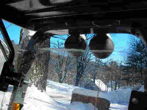

I also have a Femco on my B-7500 and what I did for the back was to buy a piece of Plexiglas and cut it into to strips and mounted it on the rops. The upper piece goes all the way up to the top of the rops and butts up to the sunshade. Then I left a 6" gap and added the second piece to the lower section of the rops. I drilled holes into the plexiglas and used tie-wraps to secure the pieces to the rops.
This left enough room to reach through to rotate the handle on the chute. Really cut down on the amount of snow that enters inside from the rear.

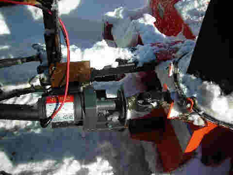

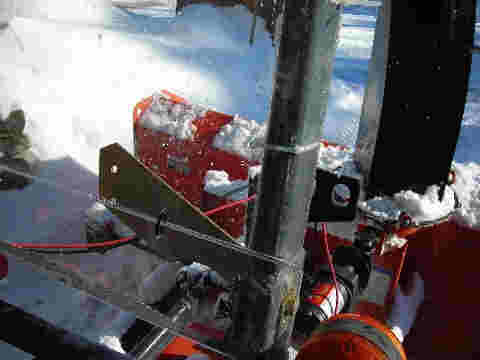

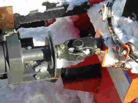

Yesterday I added a 12-vdc motor to the chute and then closed off the section on the back with another piece of Plexiglas. The motor came off from a cheap winch I had hanging around (bought off from Ebay) so we mounted it on a plate and connected directly to the chute union joint on the woods blower. Then I mounted the winch controller inside the cab. Not the prettiest looking setup, but it does seem to work nicely.

Jerrami, you've done such a nice job installing the weather break and the tractor is nearly new I am not sure if you would want to do what I did. I have two bolts on the top side of my ROPS, which I used to attach the plexiglass. Then about half way down I drilled two holes in the plexi and ran a tiewrap through the holes and around the rops. Did this on both sides to hold the glass up against the rops.
I ran the plexiglass all the way up until it was touching the sun shade. I then added a second piece below leaving room to reach through to adjust the chute. Now I have connected the two after adding the electric chute rotator.
My tractor is an 02 and I have added other things to it, but it certainly doesn't look new.

Thanks Wayne, how bad does the snow stick to the plexi? Or does it stay relatively clean?
/ hope to be warmer now #11
I haven't had any problem with the snow sticking to the plexiglass, but there has been some condensation on the inside of the glass and the weather break windshield. I think the heat coming back from the engine is the main cause along with body heat.
After blowing snow for a number of years with an open tractor, this is certainly an improvement. Yesterday we have around a foot of snow and I was out there for about two hours blowing out areas without any problem with getting wet.

Oh, I picked up the plexiglass at a local electronics discount / surplus outlet and paid like $12 for a piece 1/4" thick x 4' x 3' so with the tiewraps I maybe have $12.50 invested!
