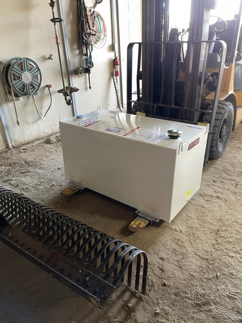

I have a home based business operating on a small ranch. My first forklift was a propane powered Toyota dually with 3k capacity. Older machine found on CL $1500 delivered. I was immediately sold on the functionality of having a forklift around for deliveries and construction projects involving pallets of materials. But it was a clutched machine without sideshift. Fast-forward 1 yr I sold it and bought a newer 5k CAT with sideshift and automatic trans for $10k. This probably the most used piece of equipment on the ranch. 90% of it's use is on sloped gravel. I swapped dual use solid tires out for pneumatic tires, this propane powered machine is the bomb.
I found it at a forklift dealer who included free delivery. That was about 5 yrs ago. The machine has about 5k hrs on it. I use it weekly and I won't wear it out or replace it in my lifetime. Today I will be loading and unloading the 100 gal fuel tank for a red diesel run.
