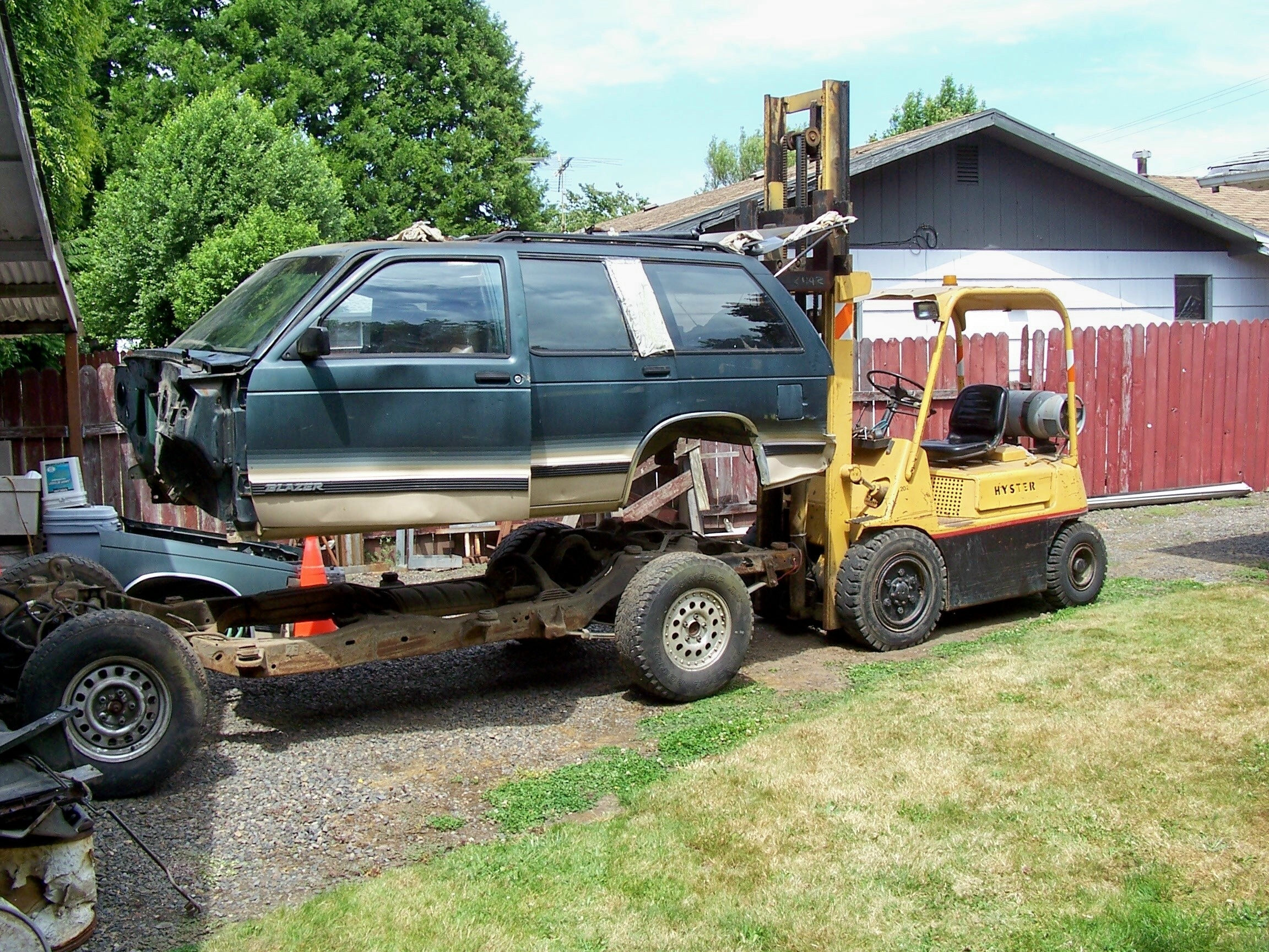

Definitely need the pneumatic tires for gravel and working on the lawn. Here's my Hyster H50 that I got from work for $500, they were going to ship it off to the auction.
I made a set of 8' fork extensions for more versatility, along with a man basket.
Only drawback is documentation is hard to find and parts are relatively expensive, I had to spend $175 for a water pump rebuild kit earlier this year, only option I could find.
Had it for over sixteen years now, no regrets.

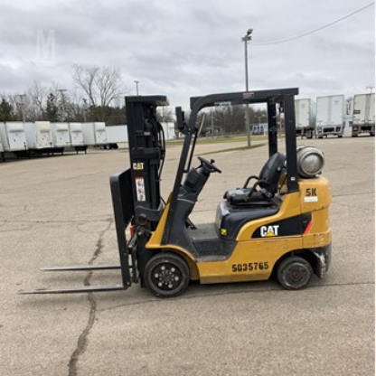

Problem I'm noticing is that most pneumatic tired models all have over seven foot mast. It won't fit into my garage...
There are models with 3 stage lifts vs 2 stage that are much shorter. My 3 stage 5k lift will fit in a shipping container. This looks like mine but I have bigger pneumatic tires.
I'm trying to find specs on a 5K Cat forklift but only thing that comes up is a crawler model.
   / Homeowner Forklift #29
I thought there was a 5K model, you must be saying weight class.
Right, 5000 pound lift capacity. It may be more than you need but a pallet of cement or block is more than 3k pounds. Anyway it's worked good for me. It's a name I can always get parts for ( we did brakes and axle seals last year). It fits in the container or barn. There are as others have mentioned lots of options out there.
