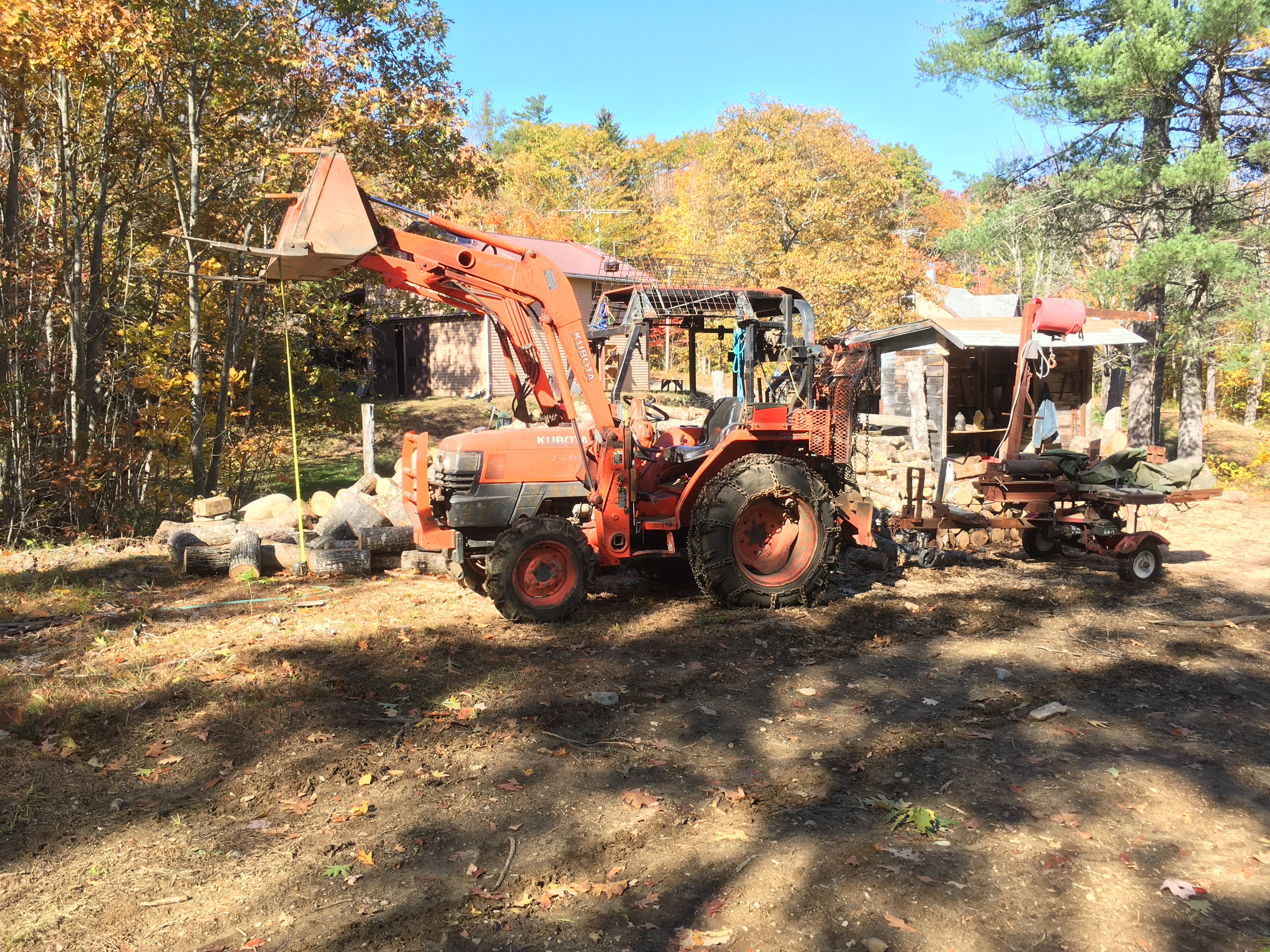

I almost forgot to measure my FEL til I raise it up moving my wood splitter in position, I took couple measured pics, my bucket wont quite curl as much as yours and dont quite have the height either, guess I owe you cup of coffee......
First pic is 9' +or- 1"@vertical bucket edge @ level-ish position, 2nd is 7' +or-1" @ cutting edge @ level-ish position.

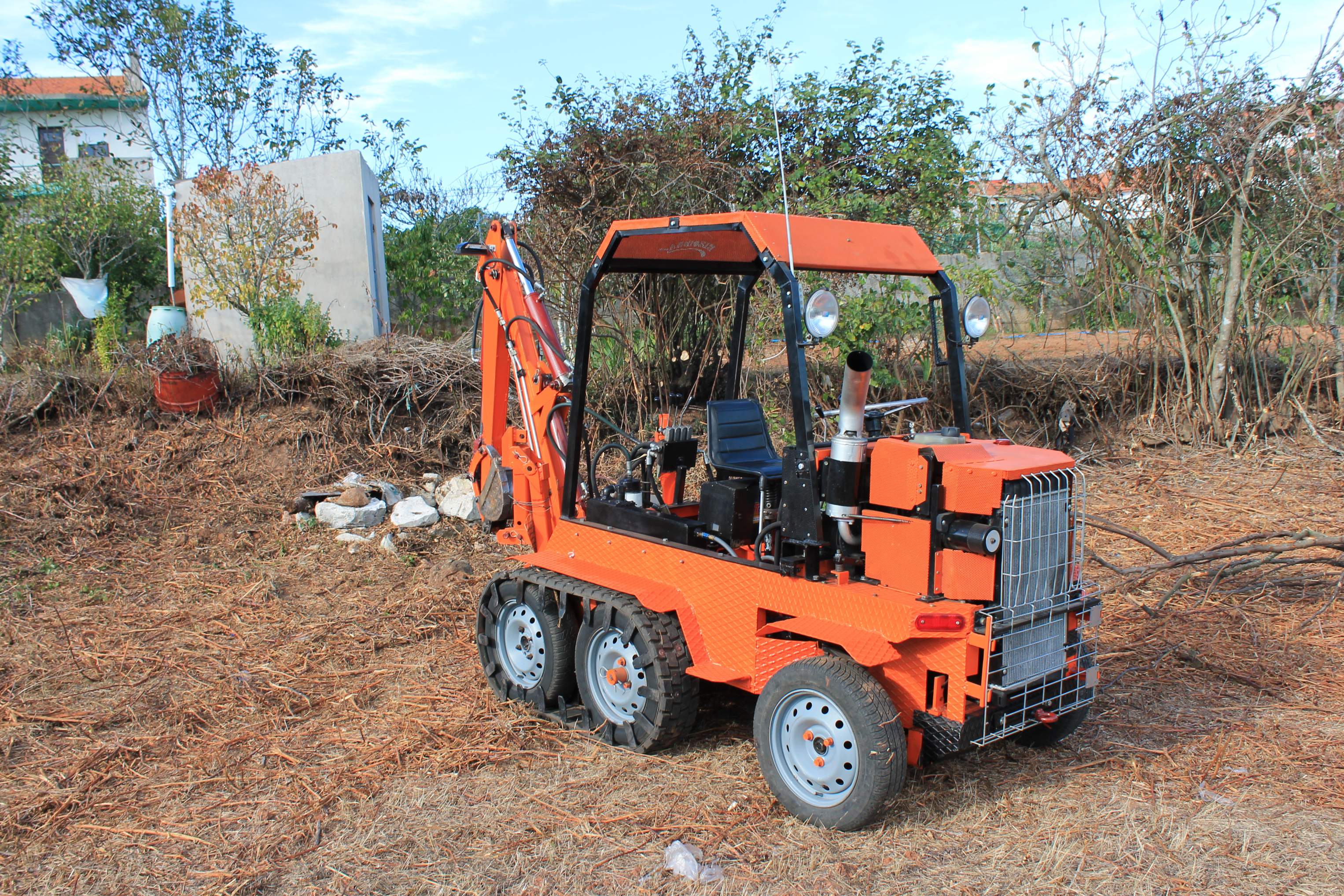

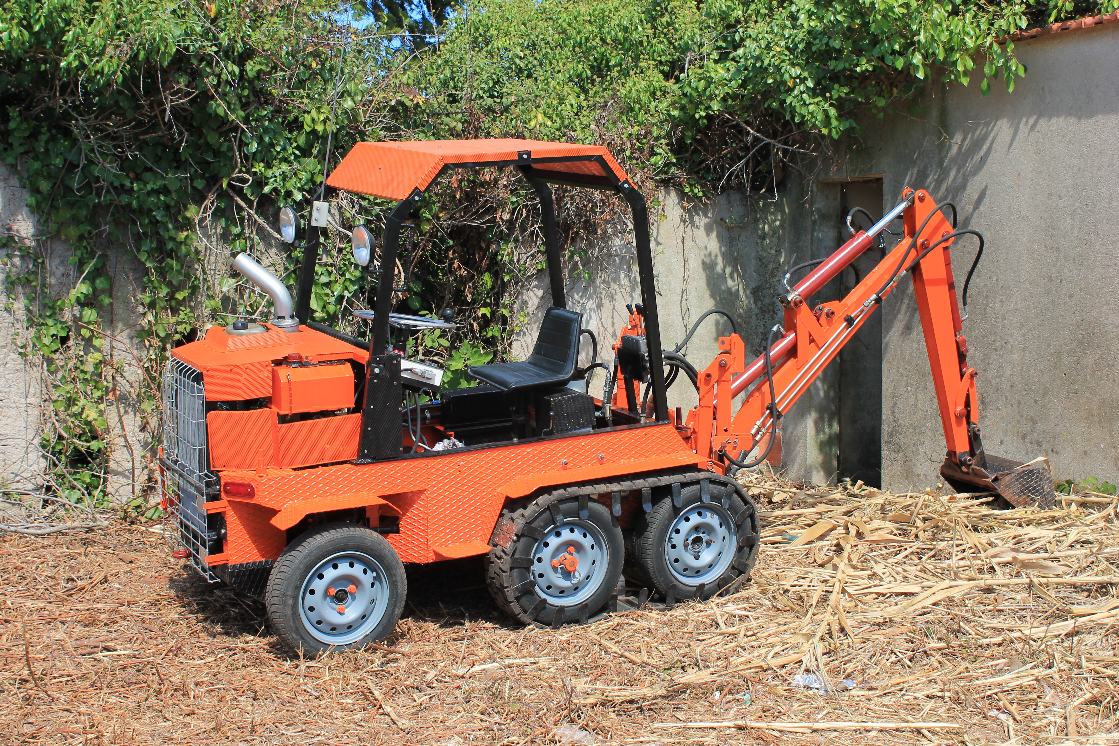

The backhoe is already made and going strong. Started building it at 10 years old with my dad, finished at 18 years old. I'm now 25. It's a self propelled half-track machine with a 17 HP Kubota engine. Hydraulic drive and made entirely out of scrap.

I don't really have a thread on the machine. I'll post some pictures here.

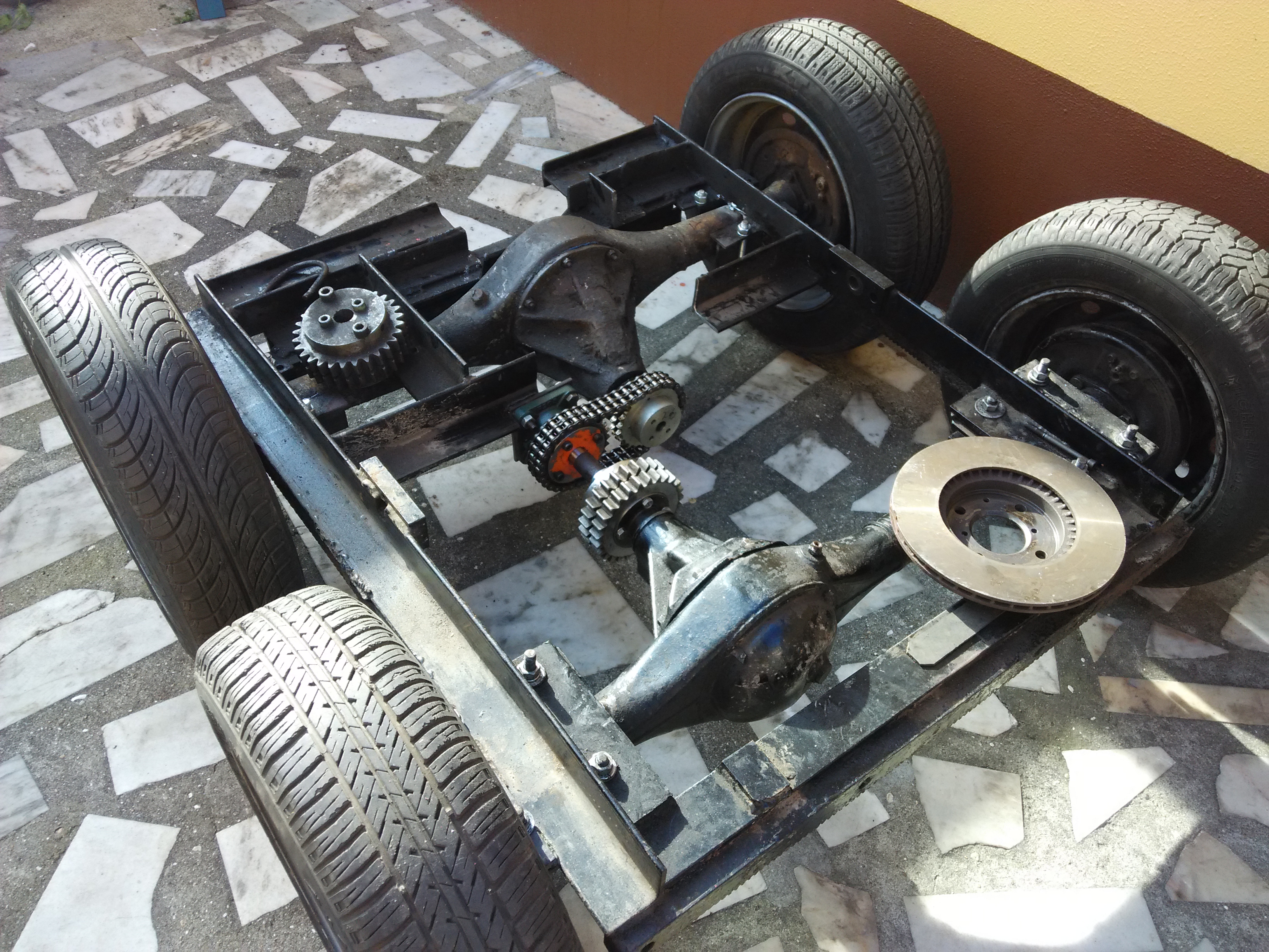

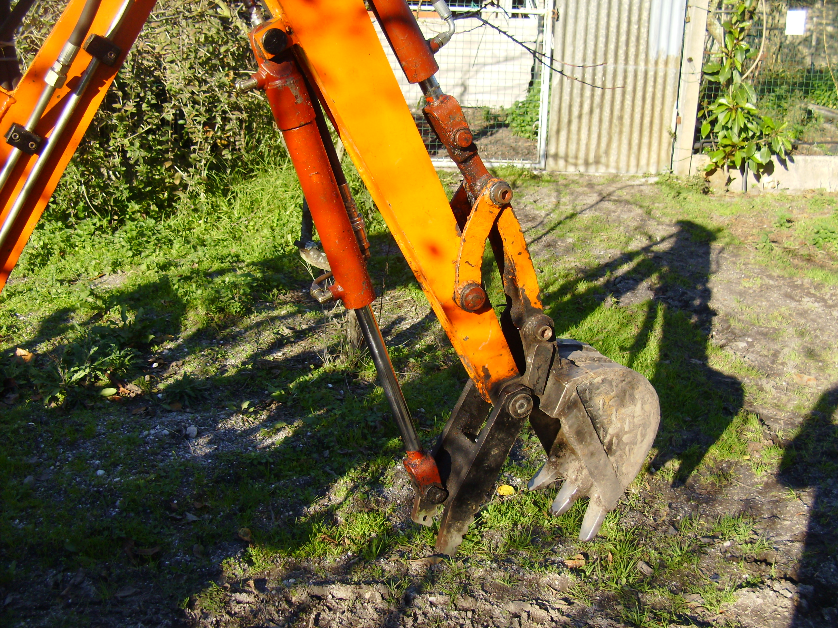

It started as a 6x2 but it's now a 6x4. The two rear axles are tied together with a chain drive and are mounted on a sub frame, so it will pivot in the middle. The diffs are different so the chain drive also makes for the ratio difference between the two diffs. It has an hydraulic thumb controlled by a pedal. I converted the 4 stick valve to joystick. It has been through a lot of changes over the years.
It has two 4 speed gearboxes. Since I have low speed and lots of torque with the hydraulic motor, I opted to power the output side of the first gearbox so I can get some speed. Then what would be the input side of the first gearbox, is attached to the input shaft on the second gearbox. This way I can get some speed on the machine that would be otherwise very slow.

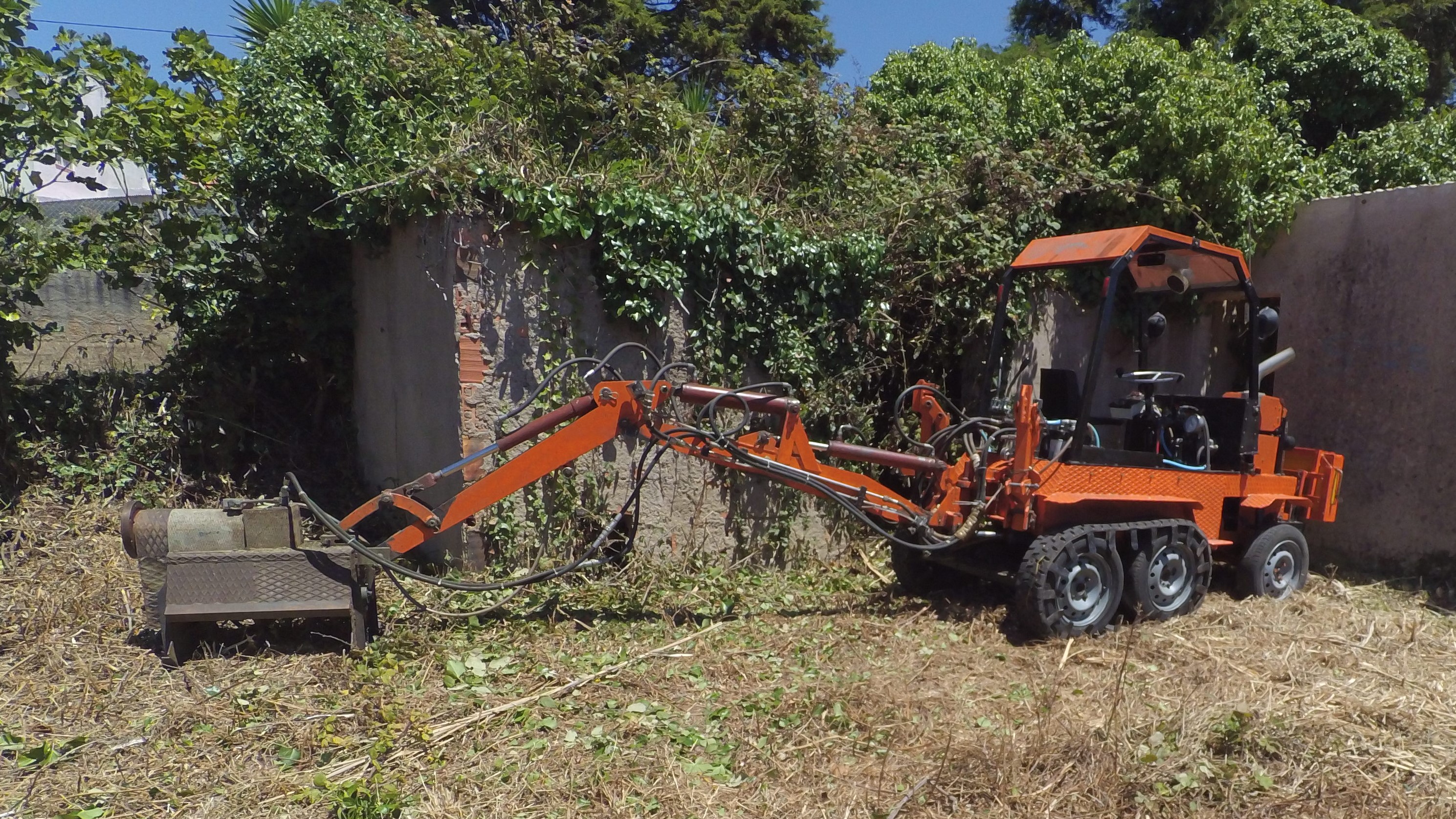

The engine is a 17HP Kubota D640 powering two pumps: 0,39ci for auxiliary circuit (thumb and flail mower) and a 1.037 ci for the backhoe and drive.

You even have a antenna on it, must be for remote control digging................ I'm trying to figure out how two rear-ends facing each other turn the wheels same direction, to do that to me instead of chain connection, the gears would have to mesh together, or does turning the the front axle upside down do the same thing? Then theres that front gear not connected to anything, maybe power take-off add on?
