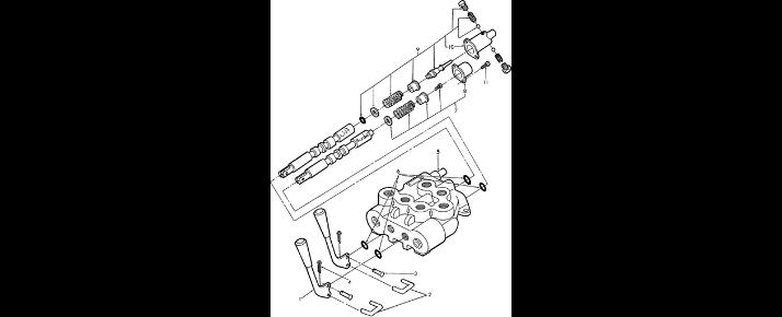

Curious how the float position is expected to act on a 770 loader.
I've noticed when using the loader that raising and lowering it is a bit scary because the float position can easily be reached and causes the bucket to jump or drop quickly if I'm not careful.
Should the float position be easy to get to or should it take some force? I've got an old Bolens garden tractor and I have to hit the lever pretty hard to "pop" it into the float position.

The float position on many spools have a detent in the spools where the little steel balls drop into and lock.
Perhaps there is crud and rust buildup on the detent ..
You might be able to rotate the spool 180 for another part of the detent.
Remove the can on the bottom and inspect and clean and replace anything necessary.

Float position is a detented position used for grading , back blading, otherwise the bucket follows the conture of the ground.
All ports on that spool are open to tank.
Not all tractors have it .
If you should go to float inadvertently, it could cause problems.

I went out and checked it again. Can barely feel the detent position, but it is definitely there. Guess I've always worn gloves when using the loader so might explain why I haven't "felt" it while using it.
Thanks for the info J_J, I'll pull the cap and check things out (and spin the spool if needed).
mostly_gas, the diagram in the first post is the control valve I have. The left (boom) lever has a longer cap on it than the bucket lever. It also has more forward lever movement than the right. If both sides have a short cap on them, then probably no float position(?).

I just bought a Ford 1910 with the 770 loader on it. I know it has the float position because the previous owner showed me and I used it for the first week.
Problem is, now the float position doesn't work anymore. I noticed that when I parked the tractor last, that I left the loader in float position. Was that a bad thing to do?
What kind of troubleshooting do I need to go through to figure out the problem. All other functionality of the loader works fine (as far as I can tell).

I'd make sure the hydraulic fluid is full. And maybe GENTLY tap on the loader control housing while operating the loader controls.

Are you sure you pushed the lever past the detent. On my 1700 it was very hard to get past it and back. It should not hurt it to leave it in float.

What I've seen doing a little looking today is that the control valves and float detent can get gunked up or rusted. Might need taken apart, cleaned up and lubed. I didn't even know it wasn't lubed by the hydraulic system.

If this works, here is a link to the parts breakdown for that controller. You should feel a definite notch when you put it into float.

Broken/weak detent spring in the valve , or stuck detent ball ? Maybe the ball got stuck/rusted in the bore when you left it parked in float ?
