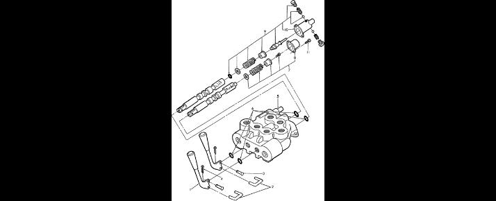

Curious how the float position is expected to act on a 770 loader.
I've noticed when using the loader that raising and lowering it is a bit scary because the float position can easily be reached and causes the bucket to jump or drop quickly if I'm not careful.
Should the float position be easy to get to or should it take some force? I've got an old Bolens garden tractor and I have to hit the lever pretty hard to "pop" it into the float position.
If this works, here is a link to the parts breakdown for that controller. You should feel a definite notch when you put it into float.

   / Ford 1700 - 770 loader - float position #14
On my 768, it's not easy to accidently go to float. Not difficult, either, just takes a conscious effort.

   / Ford 1700 - 770 loader - float position #16
Broken/weak detent spring in the valve , or stuck detent ball ? Maybe the ball got stuck/rusted in the bore when you left it parked in float ?
