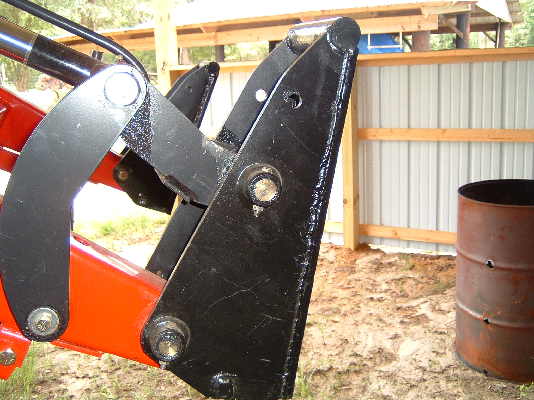

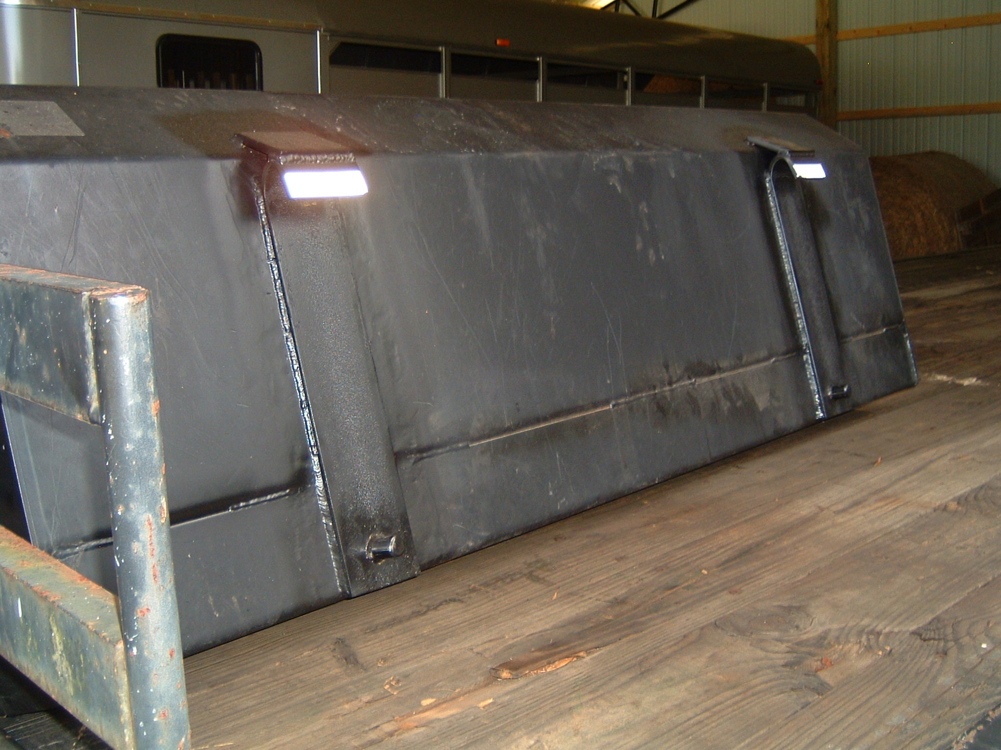

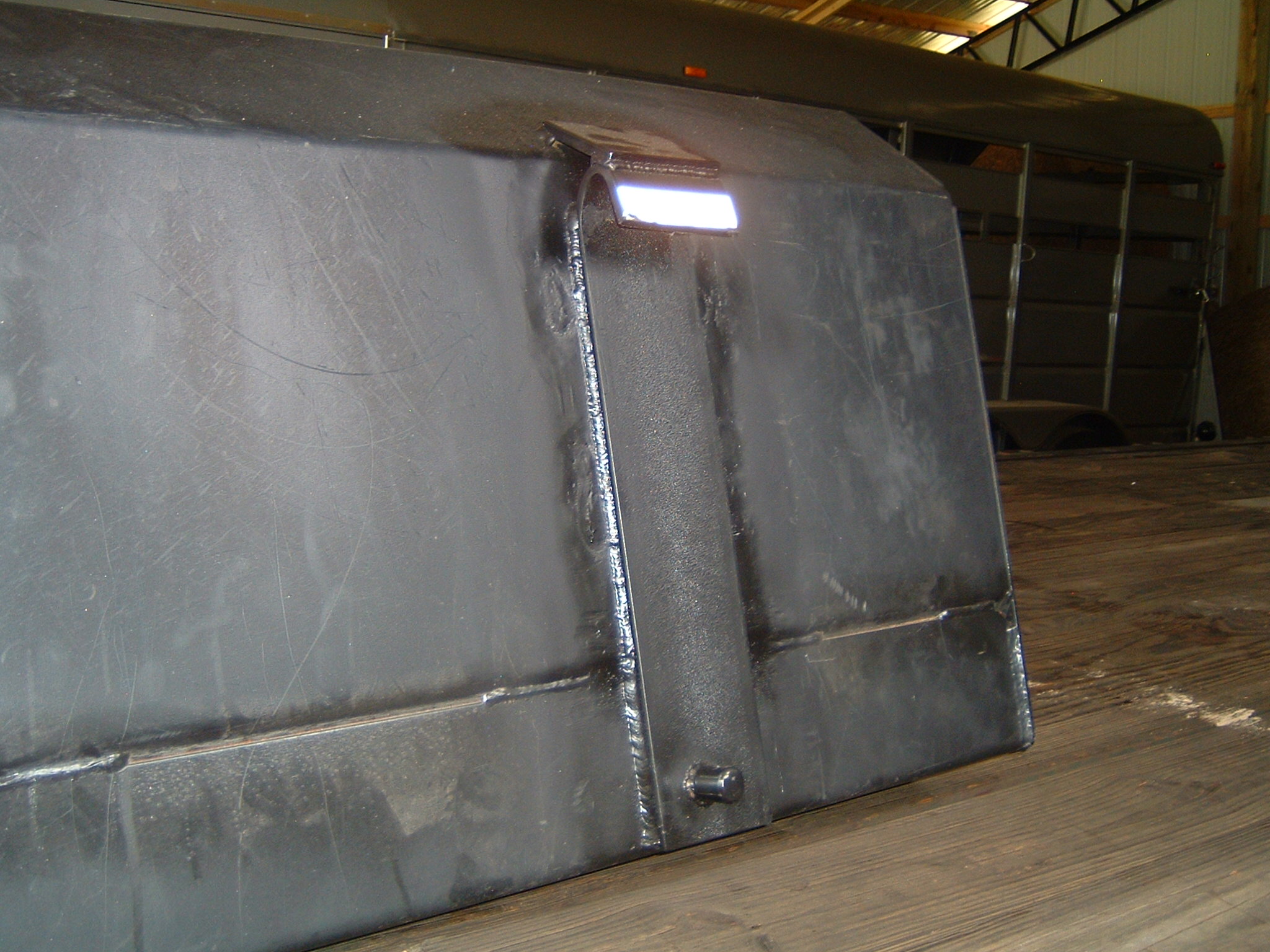

I finally got around to taking a few pictures of my homemade FEL quick attach, I'm not the best welder so don't beat me up too bad about the ugly welds. My previous tractor was a John Deere so I built this one to fit my hay spears and such that I already had.

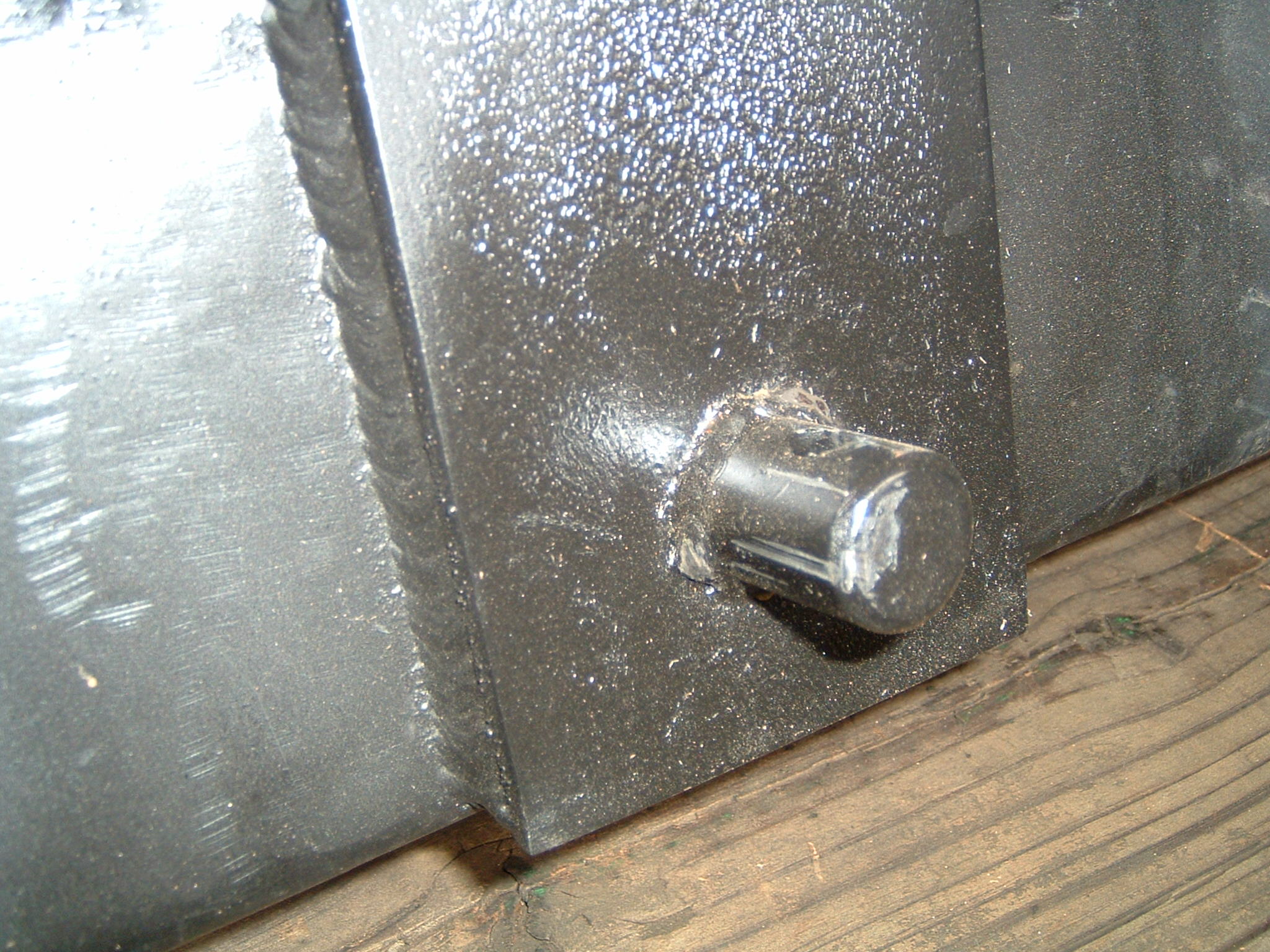

What locks the bottom pin in place?
/ Homemade FEL quick attachment
There is a hole drilled through it to put in a 3/8" lynch pin.
Here is a picture of the pin with the hole in it.

I think the welding looks fine to me..Better than Ive done ..Ive oftent hought of getting the 'guts' to make something similiar. its a big decision to cut and change .. Great job..

The only proplem I see is if you already have John Deere attaschments your pin attachment hole is in the wrong place as JD is off to the side , nice job though a lot better then I can do.
/ Homemade FEL quick attachment #10
You have nothing to apologize about with those beads. I would be concerned that the top might want to straighten out with time and heavy loads. Also, I often have the front wheels pick up when backdragging and that is an awful amount of force to put on a lynch pin.
#11
It was easier to cut the pins off of the attachments and re-locate them than it was to re-design a hitch, thanks for the compliments.
#12
I hope the top does not straighten out, it is 3/8" plate 4.5 inches wide, I picked up a roll of hay with the very tip of the spear and watched the flex as I lowered it and stopped suddenly and it did not move, I'll double the thickness if it fails.
