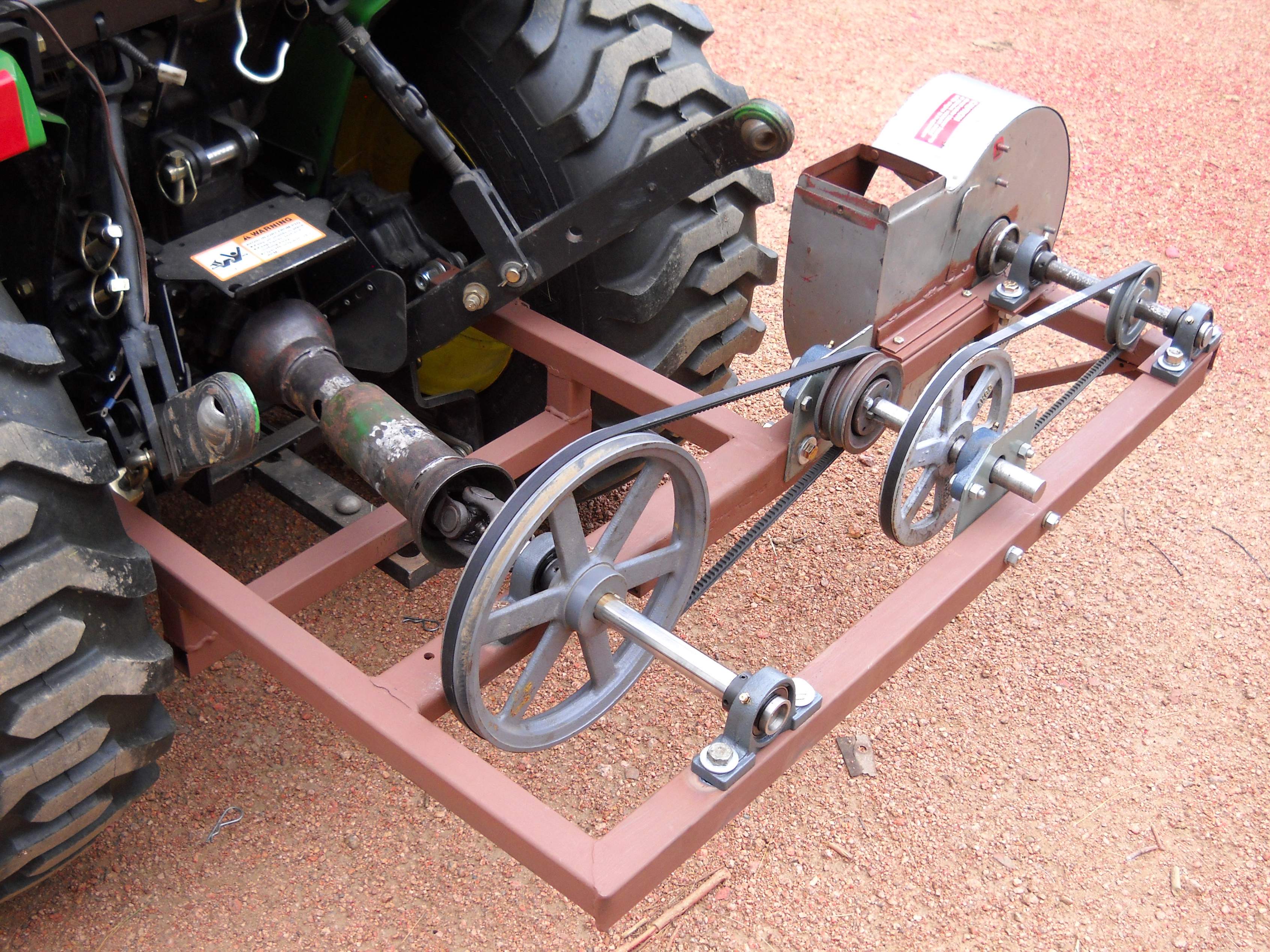

I already have most of the equipment I need to build my vacuum. I have a 4' wide trailer that my son picked up somewhere and left here. I am going to install 3 metal wall studs on the trailer, then wrap it with 25 gauge sheet metal, using one piece for a gate. I will then mount a bagger top to the top of the box. After this I will install a 6hp engine & fan on the front of the trailer. To this I will connect the plastic tube from the bagger. I will have to buy some 8" hose to connect from the deck to the fan. I will post pics as I build it.

Tested the fan blower with the PTO today. Was pleasently surprised at the amount of air flow it created. The fan spins at 3375 rpm with no vibrations or problems noticed. The front of the fan has a 10" opening which will be reduced to 8" of flex pipe. The five inch square exit will be modified to eight inch round collar to use the same flex pipe. Now that I know the blower system is functional I can build the platform for the containers and transition for the mid mounted mower.
