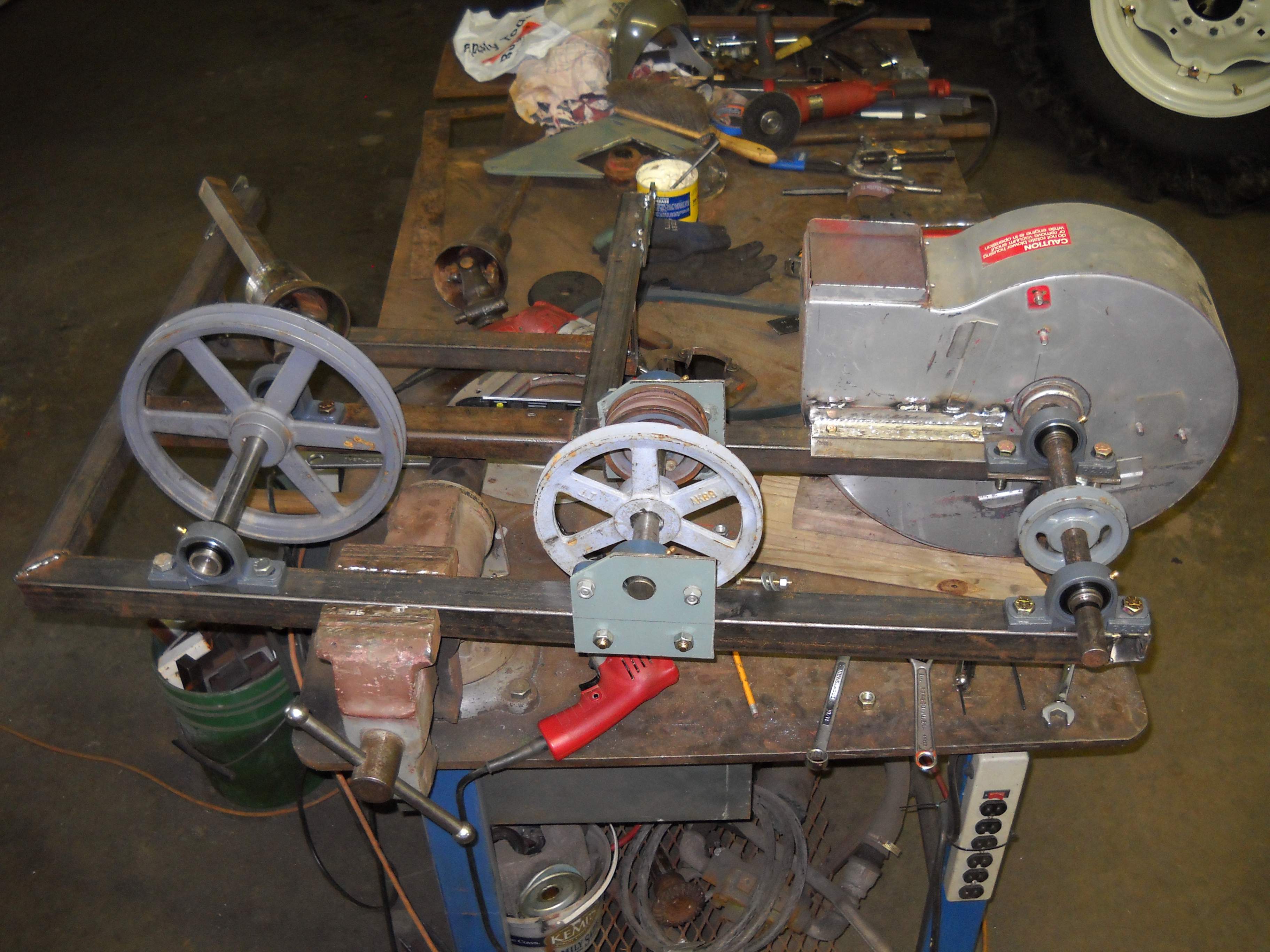

I would like to build my own lawn vac out of a 4' trailer. I would take three metal wall studs and bend them for a frame, then use 25 gauge sheetmetal for the body. I already have a bagger top from an old lawnmower, I need to locate the fan and housing to fit a horizontal engine. Anyone have any suggestions?

Sounds like your really on the ecomony kick. Someone mentioned a snowblower fan and modified housing would work out well. Besides they are easy to find and reasonable containing the shaft / bearing you will need. Good luck on your project and post some pictures. It will give others incentive to build a machine they normally would not buy due to the high cost of a very specialized task.
I am building a PTO version lawn vac for pine needles. So far $62.00 in material ( bearings, belts, steel, ) with the major expense remaining in 8" flex hose. It is taking a while as I develope a plan as I build and have made several changes along the way. I want it as compact as possible. The bin or debris container will be designed when the blower and MMM adopter transition are complete. Actually a fun project.

If you live near cotton country look for an old cotton picker fan. Its a suction fan for the stripper heads. Its already got the fan and housing, bearings and pulley. I have afriend that has one his late brother made from such a fan. Im looking for one now.

what would happen if you ran a PTO shaft to trailer, and then used large pulley coming from PTO shaft, and then smaller pulley on fan blade. to get the RPMs up on the fan blade?
would a 3pt hitch "carry all" as the main bottom frame and then just build you a plywood box on top of the 3pt hitch carry all work?
word of caution plz make some sort of metal cage or like on both sides of the fan blade. stuff can really get a moving and do some pretty good damage to yourself, someone else, or something else.

NH.... Does the 50 bucks include the trailer and tractor:D. ? I doubt the MMM has the vacuum to blow the leafs all the way up to the top of the trailer inlet. The saging corrigated tube doesn't provide the best of slippery surfaces.
If it works for him great. I know it wouldn't transfer my pine needles the distance.
