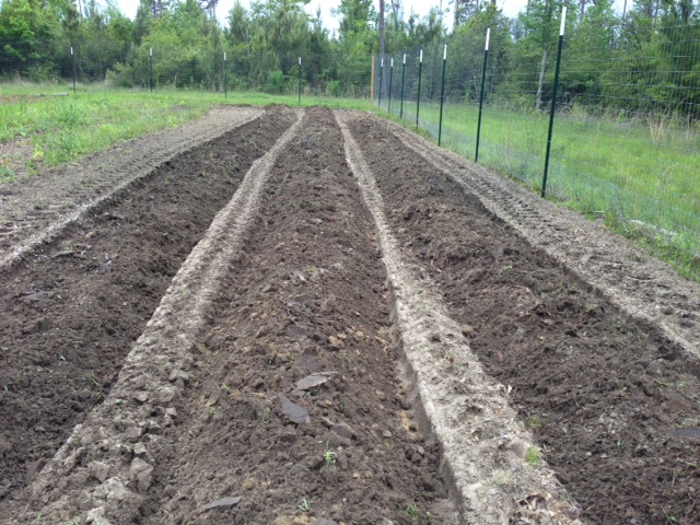

pbulling, nice pictures, thanks for taking the time to share. Nice straight rows. How do you do that? :D

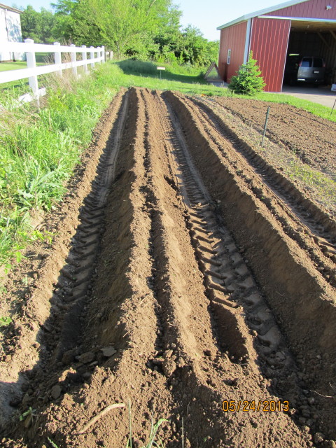

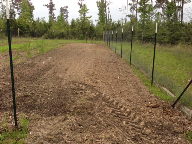

Just a quick update. I used my hiller yesterday. I set the discs at the same width as the rear tires, angled them in and drove backward down the rows -- this moves the nicely tilled dirt before I run it over with the tires. I adjusted the hillers inward a few inches each and ran down the rows a second time. The 2nd run didn't do a lot, but it did build the hills a little higher and reduced the trough down the middle. Anyway, I'm very pleased with the result -- see pic. :thumbsup: IMG_3184_1.JPG
/ Home built hiller #89
Just a quick update. I used my hiller yesterday. I set the discs at the same width as the rear tires, angled them in and drove backward down the rows -- this moves the nicely tilled dirt before I run it over with the tires. I adjusted the hillers inward a few inches each and ran down the rows a second time. The 2nd run didn't do a lot, but it did build the hills a little higher and reduced the trough down the middle. Anyway, I'm very pleased with the result -- see pic. :thumbsup:View attachment 319303
Good looking row. :thumbsup:
