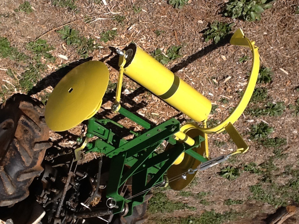

Terry, that's good as snuff and not half as dusty...lol.
I like it when someone recycles old stuff into new usuable stuff. It looks like it would work fine. After you figure out your angles you might want to weld them in place (hillers). I see the tires inside of the PVC pipe for a roller. Did you fill it with concrete for weight? Another great idea that'll get the job done.
On the sweep on the rear, you will probably find you're going to have to replace that aircraft cable with a piece of flatbar or angle to hold your plow down on the ground. It looks like it will kick up when lowered into the dirt. Have you used it yet ?

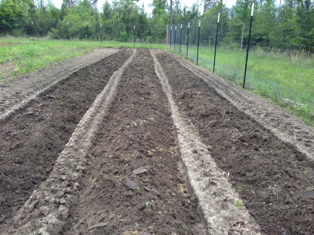

IMG_1219 (1280x960).jpgIMG_1230 (1280x960).jpgIMG_1233 (1280x960).jpgIMG_1213 (1280x960).jpg

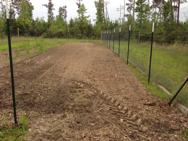

Ok I did get in and finish the garden and planted corn and beans last nite darn good I did too because we got .40 and some pea hail and its light rain and 39 when I came to work. This is some crazy weather and tonite 28 low which I was aware of so I shut the water down and drained my pvc also last nite. :confused2:
I found I need to modify the flattener for next year or maybe I get lucky and can do 2 corn crops and try it this year anyway it needs a flat piece at the back to spread the dirt. What I saw was the 1 1/8 sq tubing was cutting thru the dirt ok but wasn't really making a flat surface I could drive my little earthway seeder down.
I still did it ok but it was somewhat off to the side of the crown of the hills it will work fine just thinking ahead and talking out loud for the next guy. You will notice my latest adopted us kitty helping me get the crop off to a good start haha she will be a constant companion over there all summer she was last year.
The hiller works great overall I will be looking for a couple spring shanks might even get away with solid shanks? And a couple small shovels to create my irrigation ditches. As of now I will water down the dip created by the disc and clean it with a hoe as the water cuts it out once everything gets going good thats the plan today it may well change as time goes on. :thumbsup:

I did add concrete to the pipe. You were right about the cable , plow came out of the ground. I added a bigger plow and weight to hold the plow in the ground. Was able to play with it a little Works a lot better. Should be able to do some adjusting later this week if it doesn't rain.Its been really dry so will take all the rain we can get. This is a great site have learned a lot . Am working on a cultivator from ideas from this web site. So many ideas so little time.
/ Home built hiller #72
Car Doc, thanks for taking the time to share your hiller with us. Looks like it is going to work out great. I sort of like Terrydt100's floating roller idea. Don't know I will modify but I might if I get a little bored.

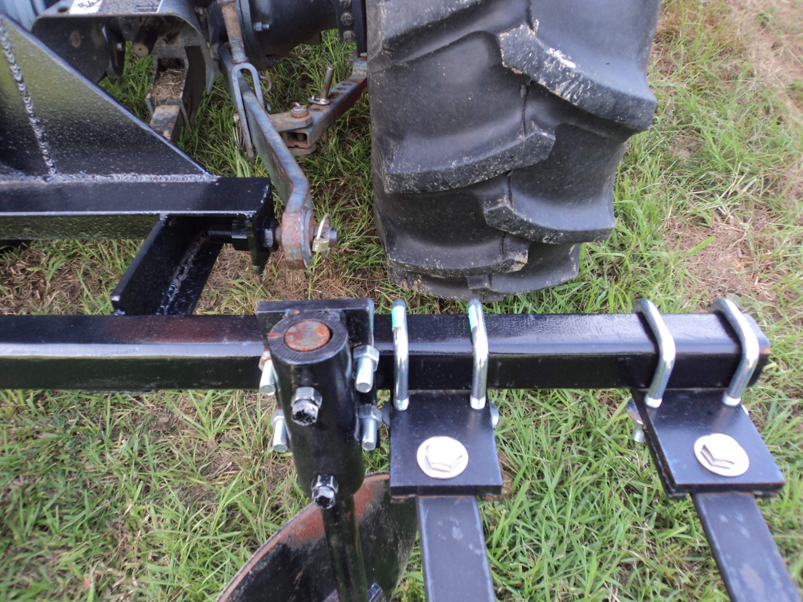

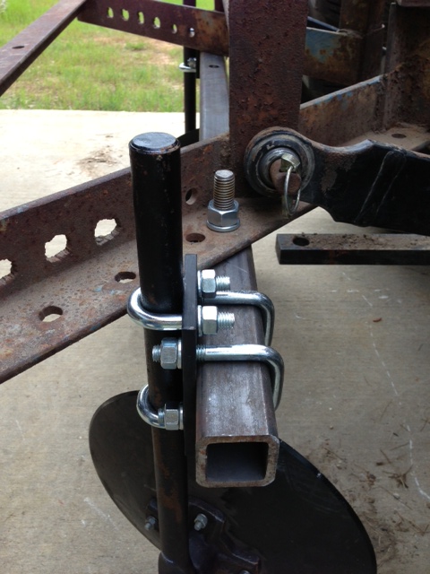

Paul -- sorry, haven't been on for a few days... I did buy those brackets for 2" square to 1 3/16" round. I got them at a place in Ohio called Buckeye Tractor. Here's there website: Buckeye Tractor Co They list them as 2" square to 1 1/4" round, but they work just great with the Agri-supply hillers that have 1 3/16" round shanks. They're not free, $18.69 each (part # 17500), so you might be able to make some for yourself using their simple design.
Bought those brackets from Buckeye. Regular delivery to south La. took only 3 days. Thanks again for the advice.
/ Home built hiller #78
Paul -- Glad it worked out for you. I was glad I found them myself. I was debating about either making some brackets or buying ones that were double that price, but when I found those at Buckeye Tractor, I decided I'd rather spend buy those and use my time to work on other things. :thumbsup:

Was an easier decision for me because I don't know how to make them. But, if I keep looking at this site I might learn how. Welding interests me but I really don't have a clue. Re Buckeye, I like their stuff and was pleased with delivery/service. Thanks again.

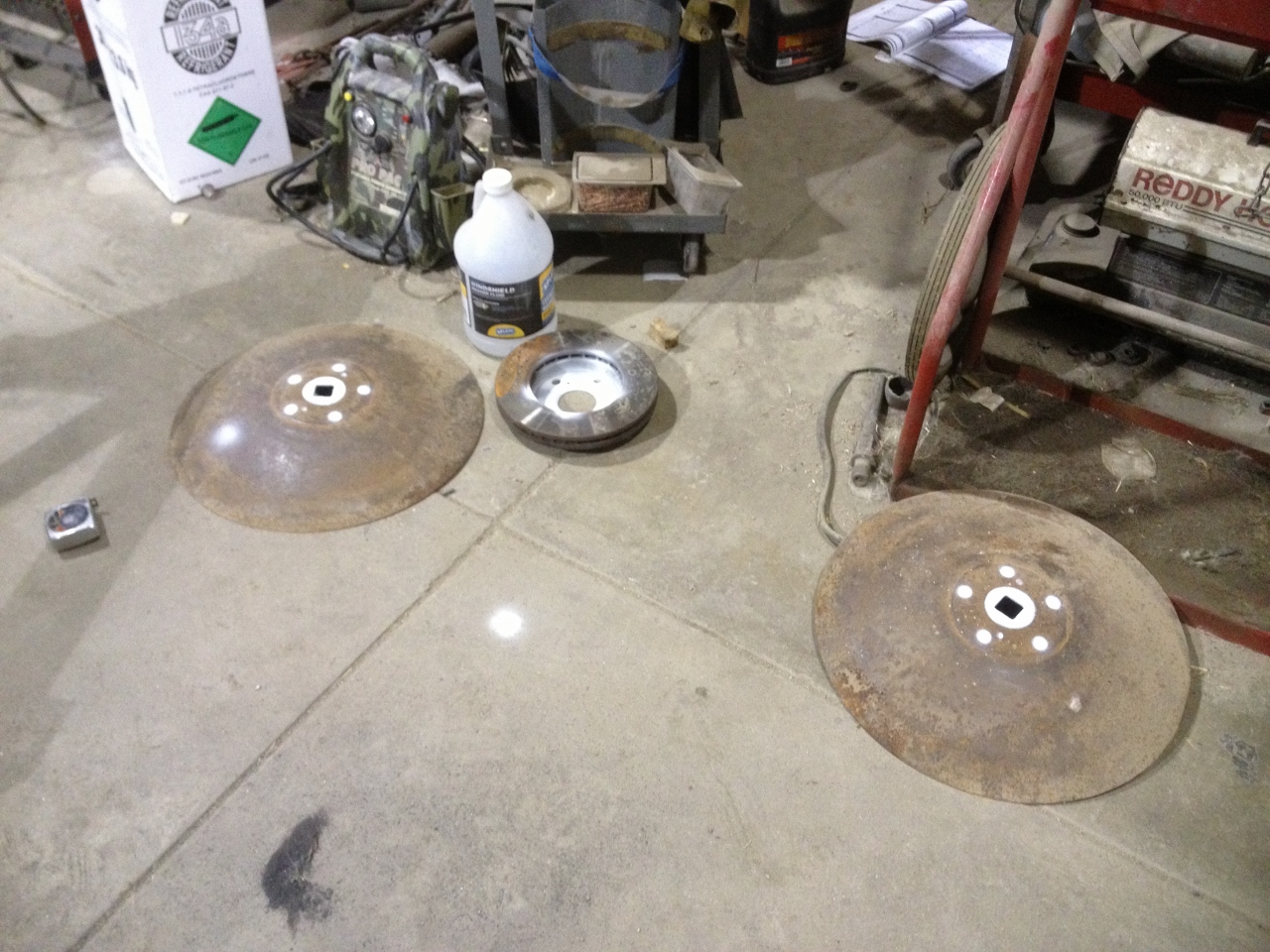

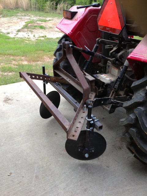

Pics of my hiller.hiller pieces.JPGafter.JPGbefore 2.JPGcloseup.jpghiller bar attached.JPGside view.jpg
Okra is finally in the ground. Thanks for all the help,
Paul
