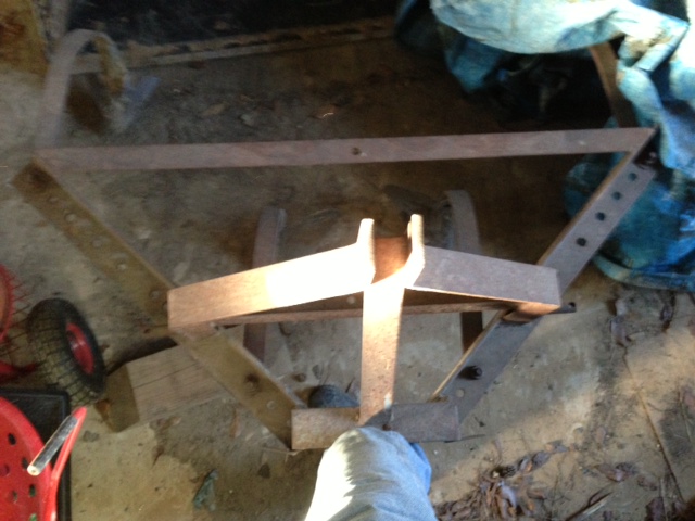

I did check out the Ginormous pics. That was good advice. I have the same 2" bar that he has. My plan is to bolt the bar to an old 3pt. cultivator (photo attached), and then attach the blade shanks to the bar. Looks like Ginormous used rounded ubolts with a square bracket. Know if anyone sells a little bracket or bracket/ubolt set like that? Agri-Supply says the diameter of the shank is 1 3/16". If I can't find that, I'm sure the welder down the highway will fix me up.

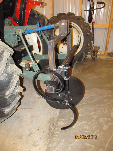

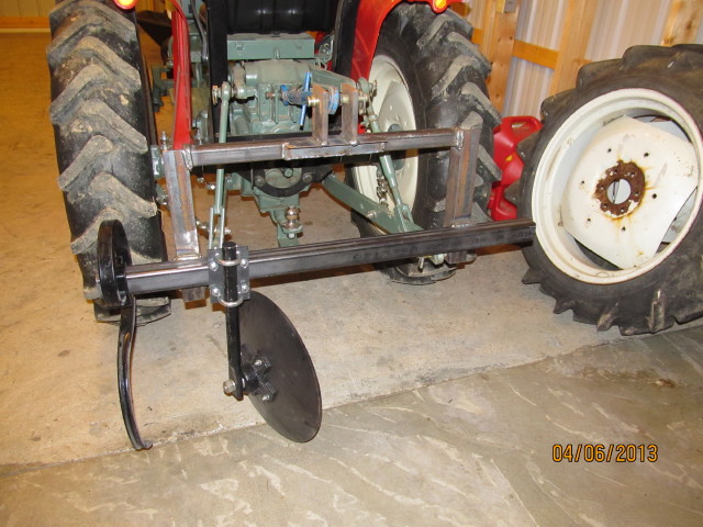

Paul -- sorry, haven't been on for a few days... I did buy those brackets for 2" square to 1 3/16" round. I got them at a place in Ohio called Buckeye Tractor. Here's there website: Buckeye Tractor Co They list them as 2" square to 1 1/4" round, but they work just great with the Agri-supply hillers that have 1 3/16" round shanks. They're not free, $18.69 each (part # 17500), so you might be able to make some for yourself using their simple design.

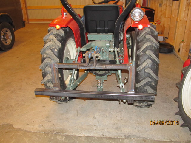

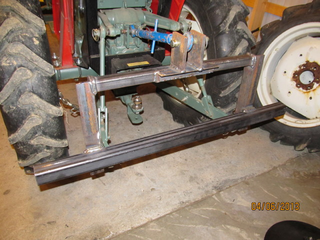

Here are some updated pics of the toolbar frame I made with a nice coat of paint -- you'll have to image the hillers attached. :thumbsup:
Cheers!

BTW, these people sell a clamp to attach a flat shank to a 2" toolbar. This could be used to make a subsoiler, middle buster, or furrower attachment. shop.woodwardcrossingscountrybasics.com/Build-Your-Own-3-Pt-Hitches-Toolbars-Garden-Attachments_c13.htm
ps. they also sell 18" spacers that can be used to add a second 2" toolbar row.
