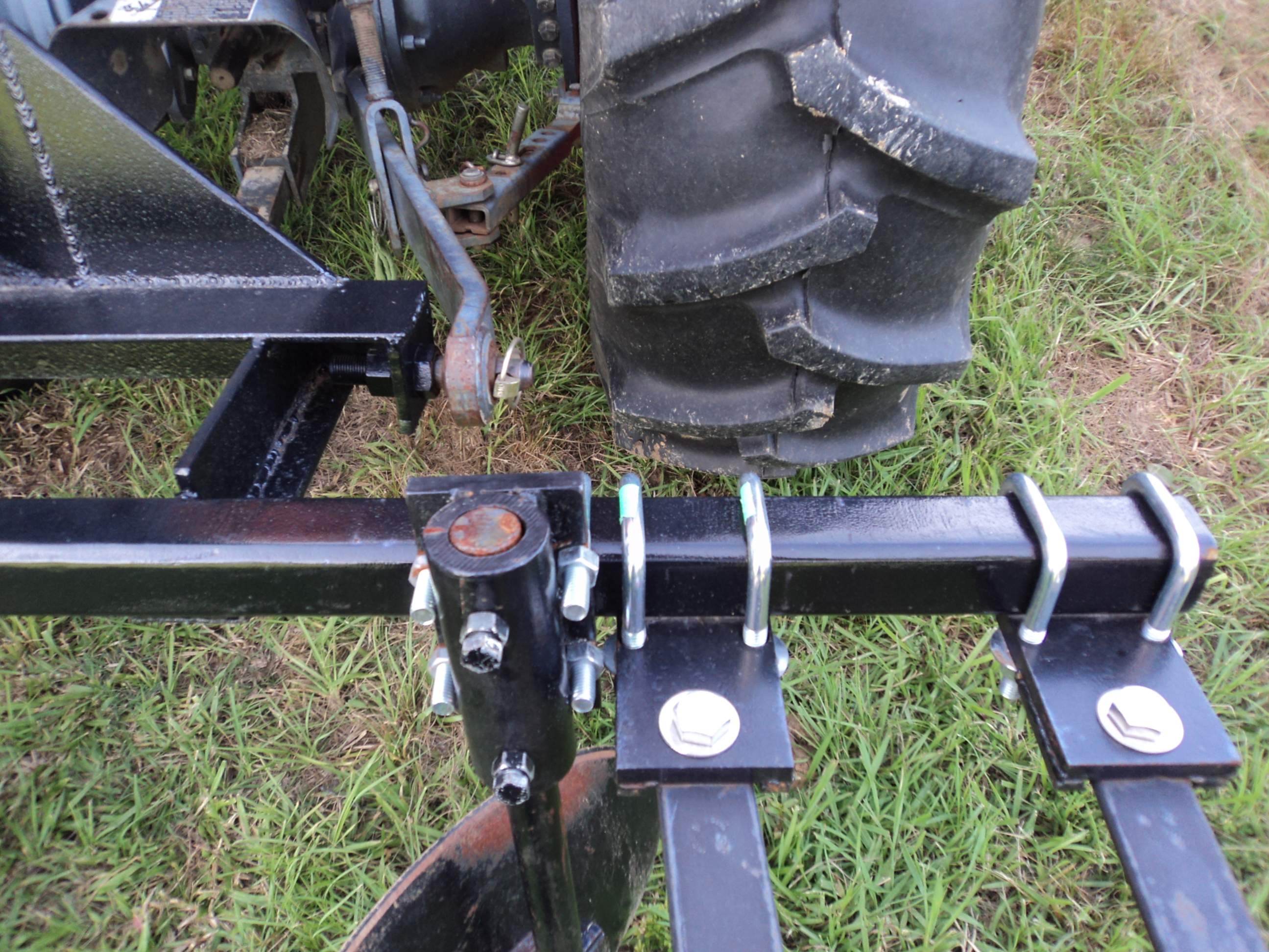

Here are some pics of my 3pt frame/toolbar I welded together yesterday to mount my hillers on and also to use as a cultivator. I loosely attached a hiller and set an s-tine on the bar to help the imagination. I think I'm going to paint it first, so I don't want to attach things and then have to take them off to paint. It's still too early for much gardening here in Ohio, so I have some time.

Just wondering why you welded the tool bar to the 3ph frame? With clamps you can have different tool setups on toolbars and just unclamp one and clamp on the next without breaking setup an readjusting each tool. Saves time and work when you mount a simple pipe stand to support tool when unclamped

Are you referring to Ginormous? I cant answer for him but I plan on welding my front (main) tool bar to the 3pt hitch assy also it will be a lot easier than building brackets and drilling holes etc. I may use spreader bars and add a second tool bar later that will be all bolt on but I plan on doing pretty close to what he did if that answers your question? (I do follow your train of thought btw but its not how I intended to do this one fwtw)

sorry about that, I got caught in the middle of thought and had to cut it short. What we did on a one row I-H was build the 3rd point hitch with clamps for the tool bar.That way we just mounted diff tools on separate tool bars with simple pipe stands to hold them upright when unhitched.It acts like a quick hitch, you drive away from one setup and back into the next with only installing the clamps. No more manhandling tools or needing a tape measure to put shanks or sweeps back in the right spaceing. It is much easier to slide a tool bar into a heavy tool than it is to slide a heavy tool onto a tool bar. Second thought was his welds look to be profesional so don't think I was badmouthing his work, but, without heat treating the bar after welding the weakest point on the bar is just outside the weld. If you were to hook a rock or some other immoveable object you could end up with a bent or broken bar. Then it's back to the drawing board. We had everthing from plow to planters to cultivators set up like this and could change tools in under 10 min.

What type of toolbar clamps did you find? I'm looking for a bracket/clamp/sleeve to attach two 22" shanks, with Blanton style disks, to a 2 x 2" toolbar. The shanks are 1 3/16" diameter. Anyone know where I could order something online? Thanks much.

We used a stock U bolts made to clamp 2 in. Springs to trailer axle. Square socket on 3 ph for bar rest in with 2 holes on each side for clamps.

The clamp I'm looking for is the square to round in the attached picture.DSC01566.jpg

My bad, what I was refering to was to clamp the tool bar to the 3ph adaptor rather than weld it solid. A square socket or notch to prevent bar from turning up or down under load.

If you look close at pics posted by Ginormous his setup looks to be about the best one I've seen for round to square. Simple design, and no welding required. The old I-H single row tractors, such as the A's and Super A's came mostly with a tool bar instead of 3ph. All the clamps that I've used or seen for them were cast iron and used a giant lug wrench to loosen or tighten. If you get around Palmetto drive toward Bayou Rouge and you will probably see one or two old tractors up in the weeds. You might just find some treasures.
