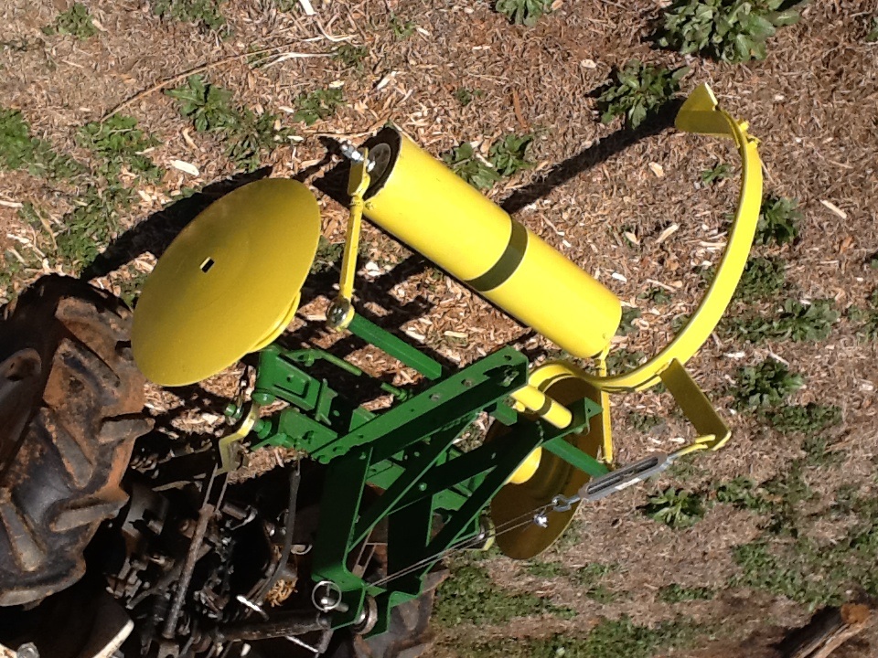

Terry, that's good as snuff and not half as dusty...lol.
I like it when someone recycles old stuff into new usuable stuff. It looks like it would work fine. After you figure out your angles you might want to weld them in place (hillers). I see the tires inside of the PVC pipe for a roller. Did you fill it with concrete for weight? Another great idea that'll get the job done.
On the sweep on the rear, you will probably find you're going to have to replace that aircraft cable with a piece of flatbar or angle to hold your plow down on the ground. It looks like it will kick up when lowered into the dirt. Have you used it yet ?

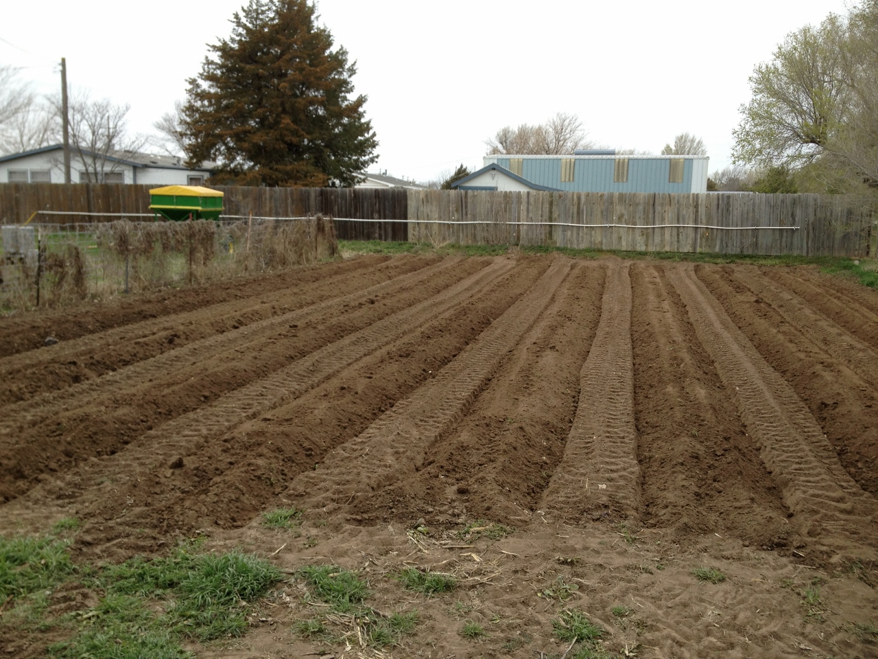

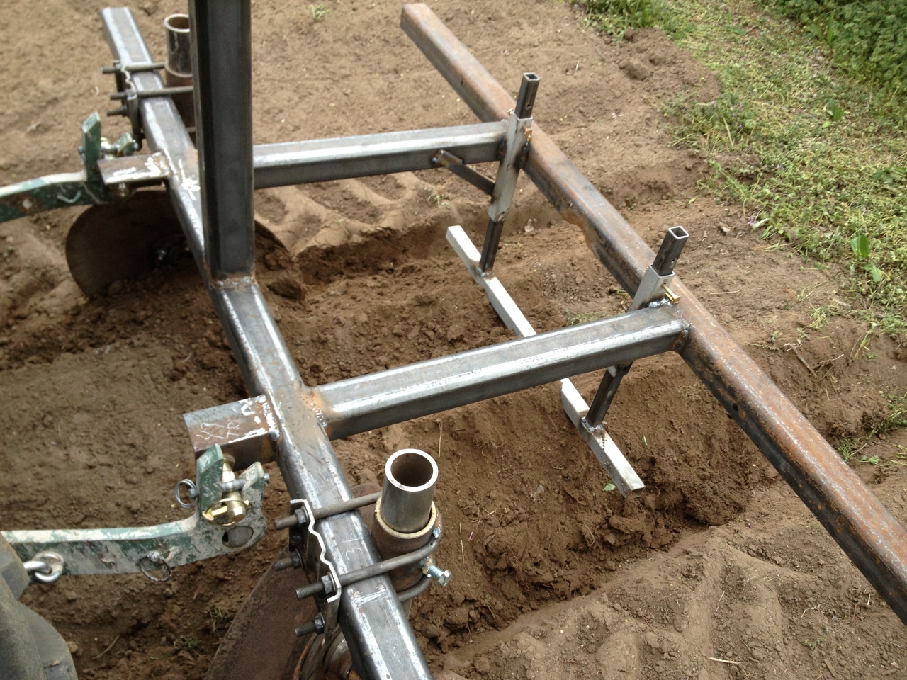

Ok I did get in and finish the garden and planted corn and beans last nite darn good I did too because we got .40 and some pea hail and its light rain and 39 when I came to work. This is some crazy weather and tonite 28 low which I was aware of so I shut the water down and drained my pvc also last nite. :confused2:

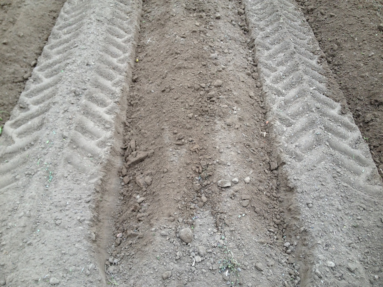

I found I need to modify the flattener for next year or maybe I get lucky and can do 2 corn crops and try it this year anyway it needs a flat piece at the back to spread the dirt. What I saw was the 1 1/8 sq tubing was cutting thru the dirt ok but wasn't really making a flat surface I could drive my little earthway seeder down.
I still did it ok but it was somewhat off to the side of the crown of the hills it will work fine just thinking ahead and talking out loud for the next guy. You will notice my latest adopted us kitty helping me get the crop off to a good start haha she will be a constant companion over there all summer she was last year.
The hiller works great overall I will be looking for a couple spring shanks might even get away with solid shanks? And a couple small shovels to create my irrigation ditches. As of now I will water down the dip created by the disc and clean it with a hoe as the water cuts it out once everything gets going good thats the plan today it may well change as time goes on. :thumbsup:
