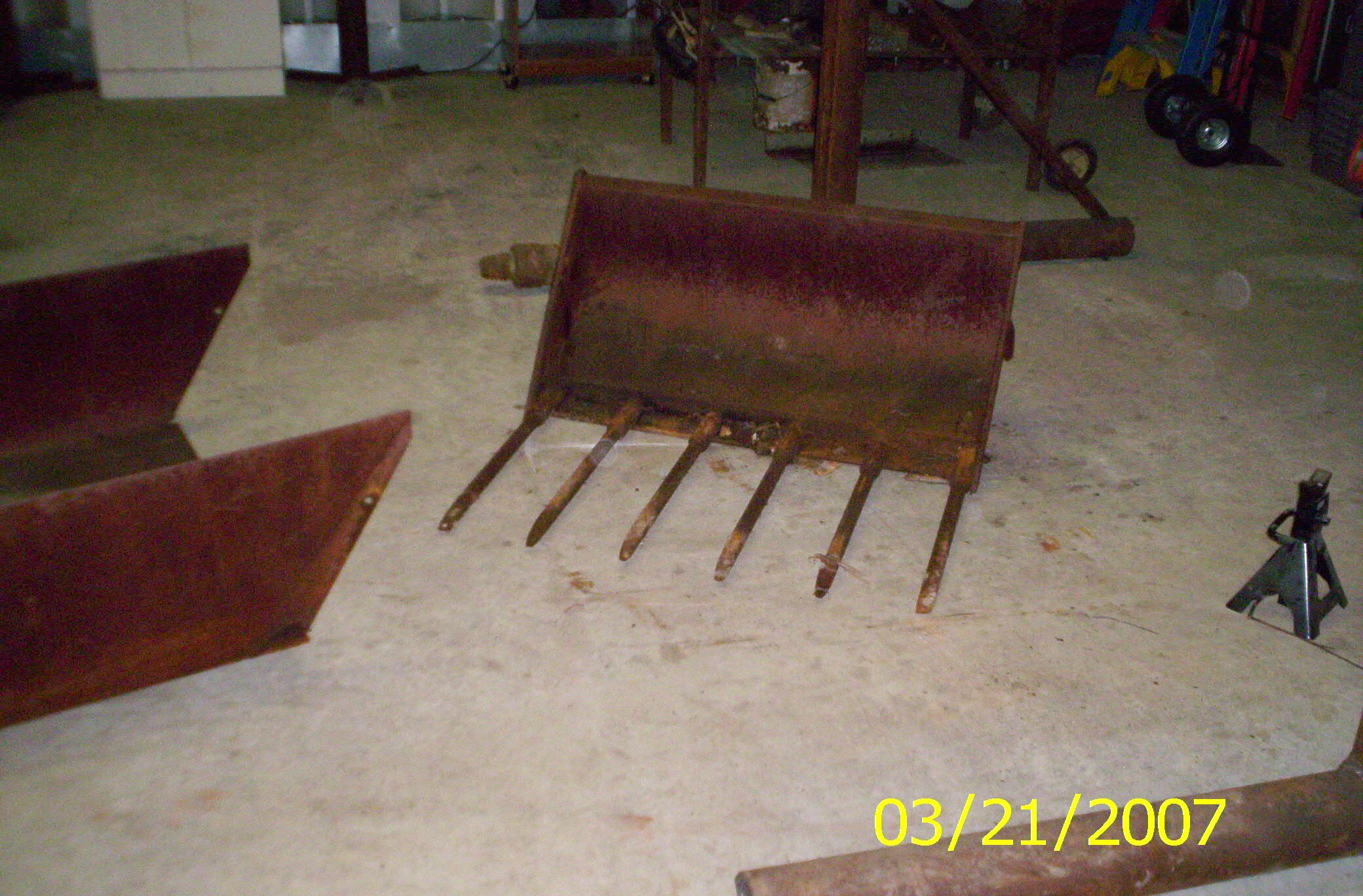

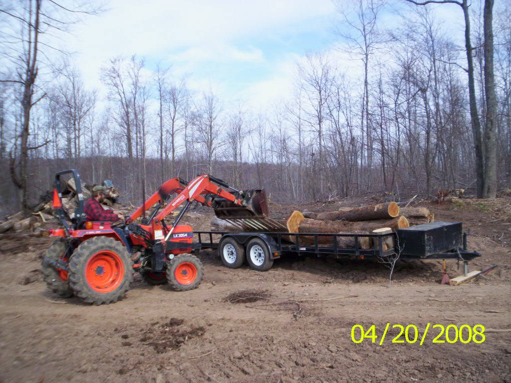

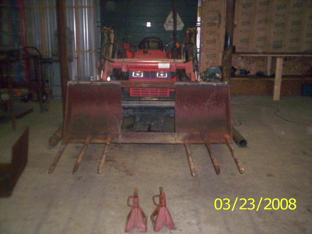

I made one out of an old manure scoop.It was 48" widened to 60'' i plan on making a grapple for it soon.

Dirtnut,
I have to ask....
With nothing on the 3PH how is the pucker factor when lifting those logs?
J
/ home built debris forks #7
I have loaded tires wich really makes a big differance on the tractor.I can do most loader work without a counter weight but i still use a counter weight as much as possible anyways. The reason i dont have it on hear is so i can hook up to my trailer.
