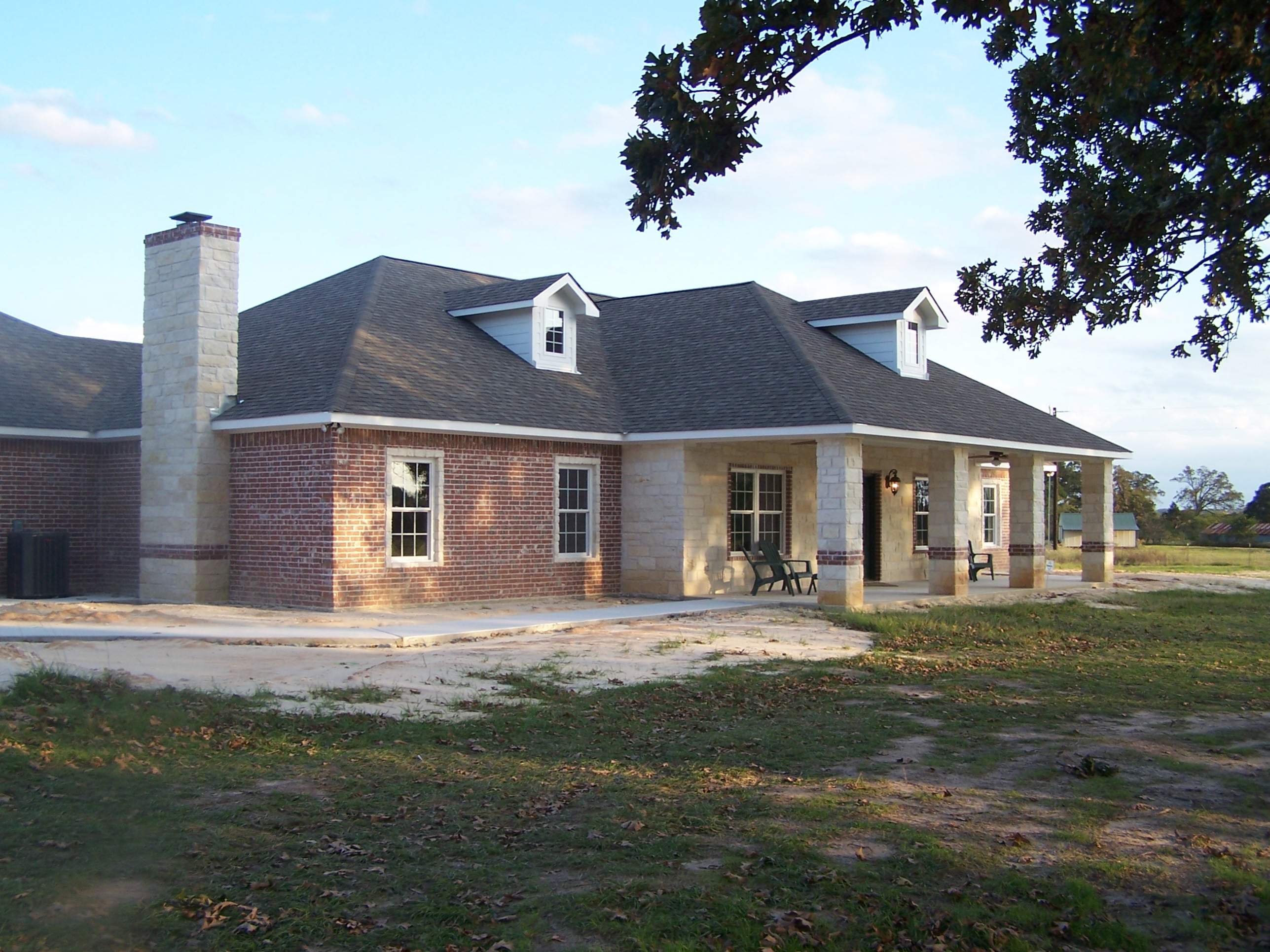

My answer to #1 - ours included driveway (gravel), septic, well, HVAC, water heater, expansion tank for well, Kitchen appliances (allowance), faucets (allowance), lights (allowance), guttering, burying the gutter runoffs, sidewalks, screens for the windows, 1 yr warranty, gas logs.. We paid extra for the shower doors and garbage disposal because we didnt think to include those in the quote.. We also had to buy our own toilet paper holders, towel bars/hooks, bathroom mirrors, medicine cabinet..
We have a detached 24x36 garage, walk up unfinished attic (1300 sq ft - i think it would be considered a 1.5 story house), and a 2000 sq ft living space.. Based on talking to other ppl in the building industry i 'think' our cost was about $110/ft main living, $50/ft for garage, and $30/ft for unfinished upstairs. These prices include any extras/upgrades we did that were paid out of pocket.
