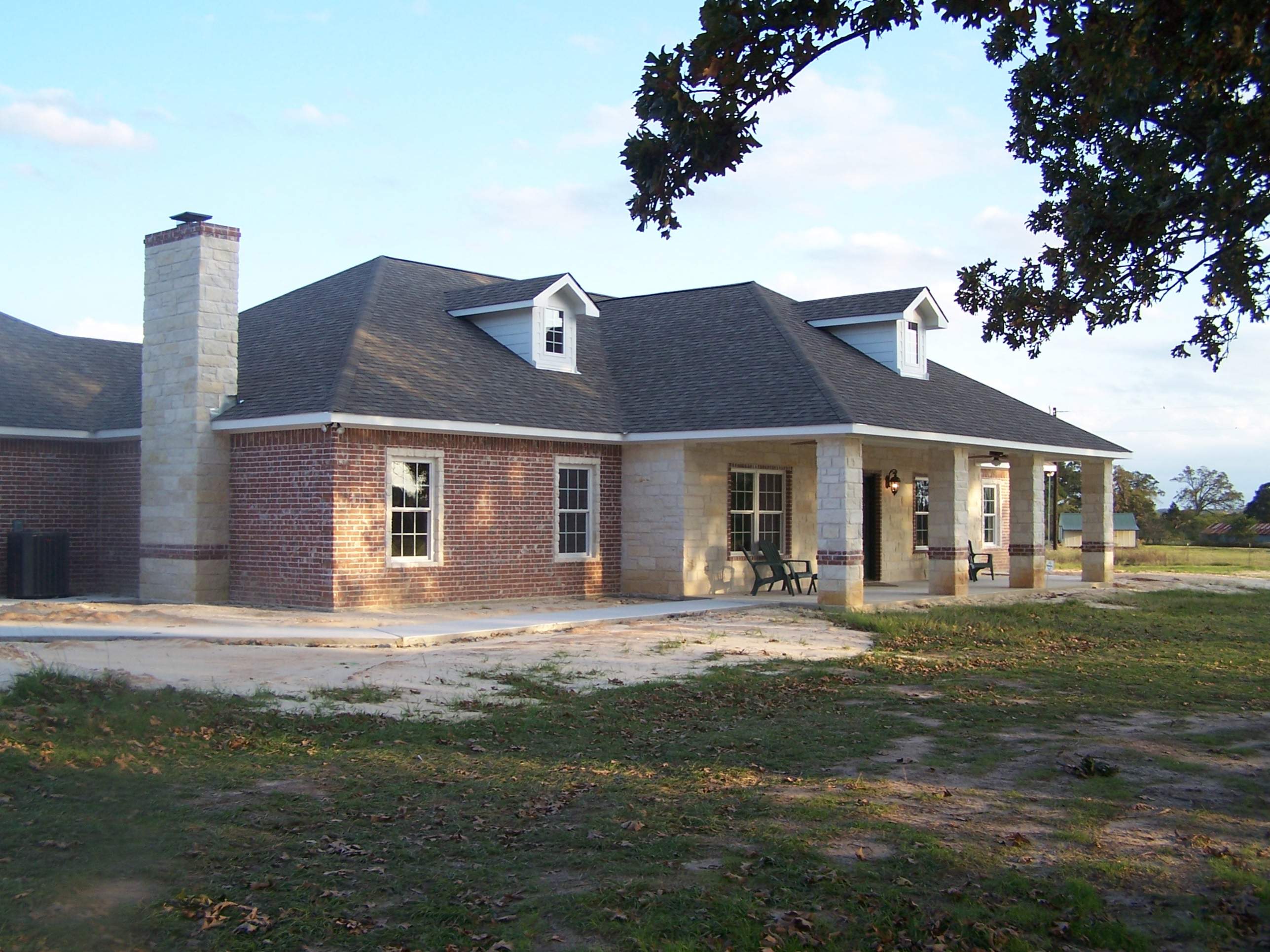

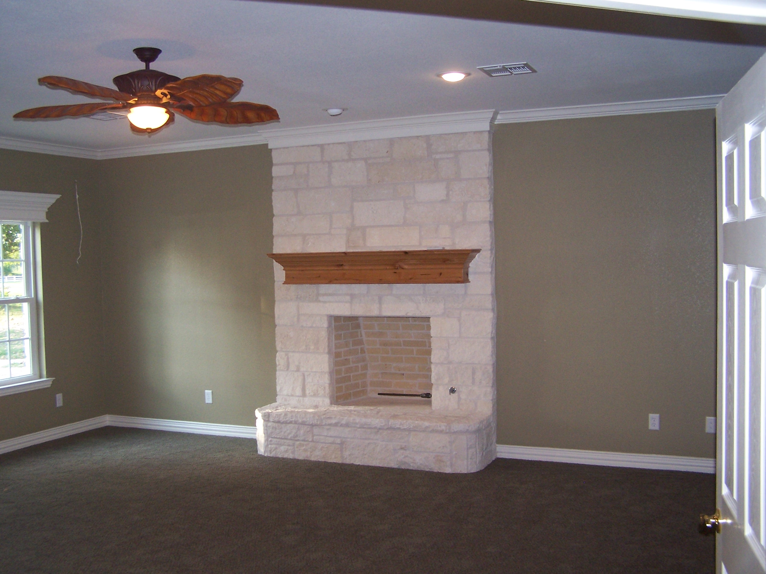

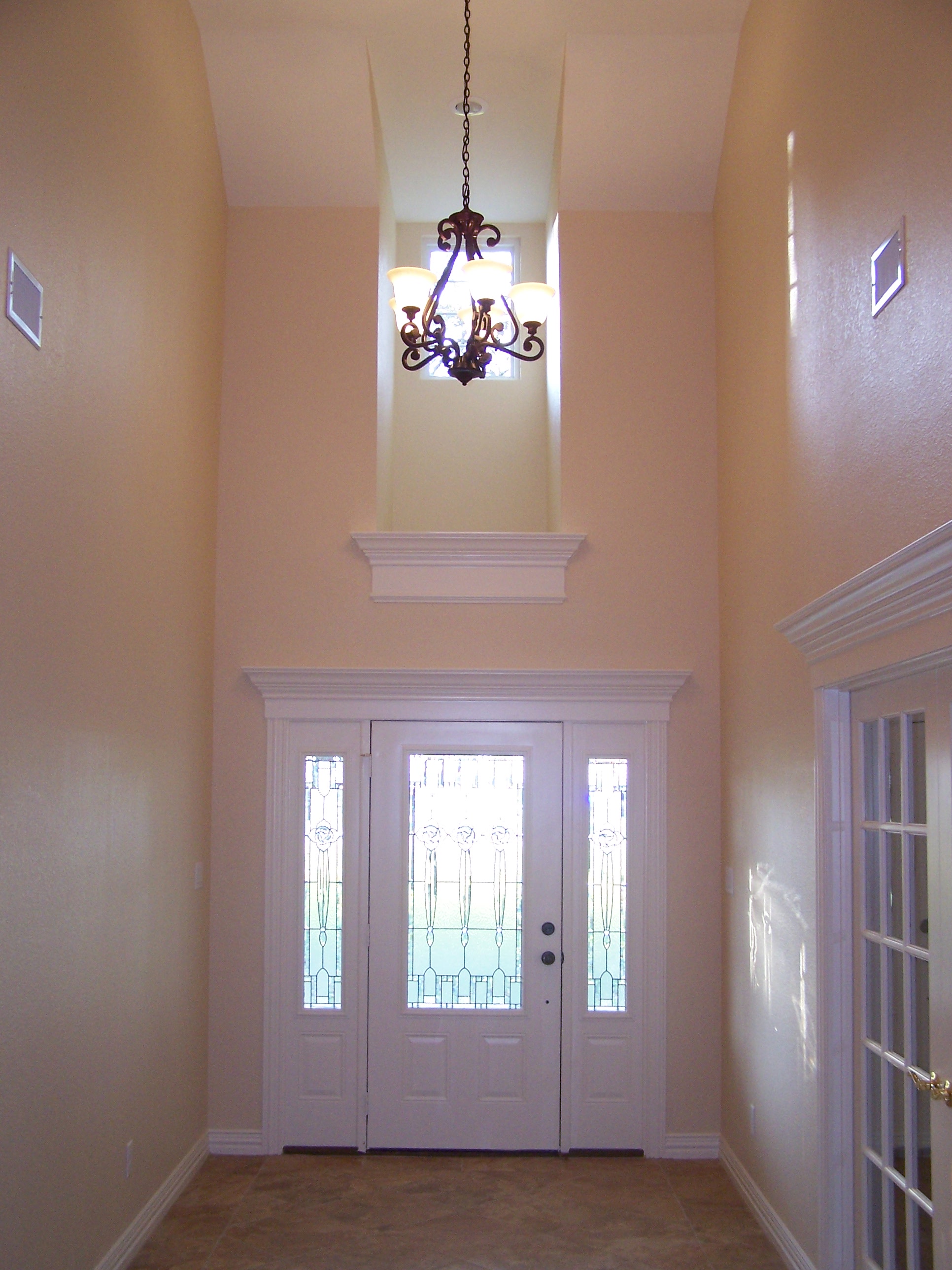

We finished our house a year ago. We started by looking at plans on the Internet. We decided on what we wanted and hired a designer to draw up the plans. Spent 3 months going back and forth till we got what we wanted. Took those plans, had copies made, and started meeting with contractors. We ended up using the same contractor that built our first house and were very happy with the results.
Two ways to hire a contractor. First is he will give you a price based on allowances for things like lighting, flooring, etc. If you want to spend more than the allowance to upgrade you pay the difference. If he estimated a part of the project high and it comes in cheaper he makes more profit.
Second is cost plus commission. You get an estimate of what it costs for each part of construction. You pay the actual cost plus a percentage, usually between 10% - 15%. Nice part about this is if the price is below the estimate you save money.
Here is what we ended up with. 3200 square feet heated and cooled, 5200 square feet under roof.
