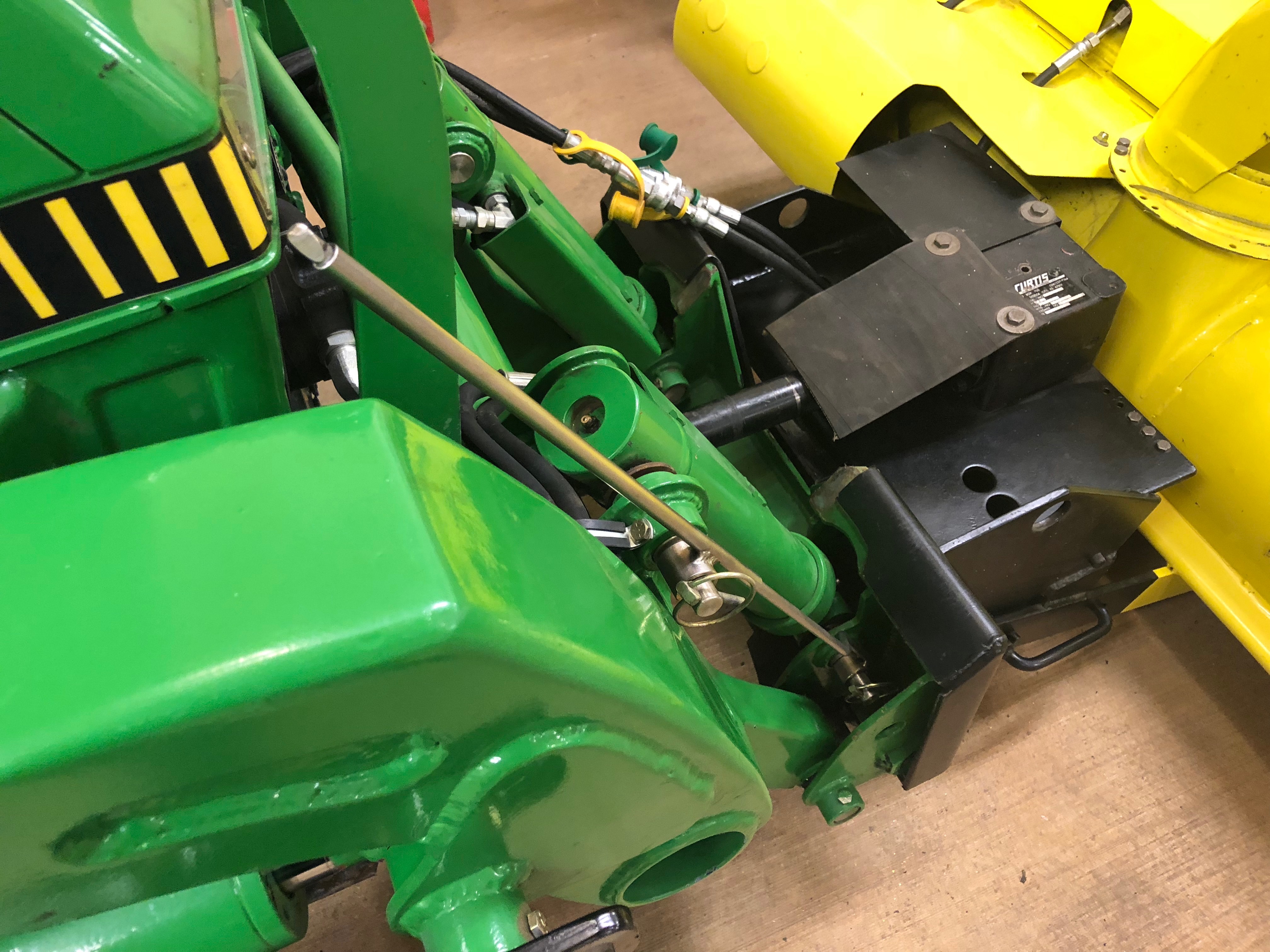

That's why I might want an electronic one. I never need to be exactly level, but I'd like to know when stuff might sluff into or out of the bucket.
Electronic one is not going to tell you anything different than pure mechanical one.... Electronic may be pretty with "der blinkin lights", but it is only more complex with switches and bulbs to go bad.......
Dale
   / Home Brew Bucket Level? #22
I agree. I'd have no use for electronic.
I also liked you pic posted to 4570. Pic is worth a thousand words. :)
#23
Electronic will (should?) tell me true level, not just even with the machine plane. Now, do I need to know that? Not entirely sure.
   / Home Brew Bucket Level? #24
True level, or "bubble level" will be worthless knowledge almost every time when using the bucket.
It would have some value with forks or a bale stabber.
   / Home Brew Bucket Level? #25
It’s still not that hard to do without one. I can easily pick up logs off the grass with pallet forks and not dig up the grass. Taking a even cut with the bucket is a little harder to do. It has to be a little past level or or won’t cut but too much and it digs in. Scooping out of a pile is also easy without the level indicator
   / Home Brew Bucket Level? #26
I believe being level with the incline of the tractor is what would be most useful....but having less than 20 hours on a tractor makes my opinion next to useless. But most of the places I will use tge FEL are level or close to level....so it may not matter.
I wish I could get enough tractor time to be more like 4570man, but I am in my late sixties and will be dead before that happens. So I will be adding a rod type unit. I saw the thread by Waxman on the electronic unit he made a decade ago. Very impressed with his talent but seems more than I can justify.
   / Home Brew Bucket Level? #27
Do you use a spinner knob?
   / Home Brew Bucket Level? #28
As has been suggested, what is "level"? Level to the ground, or parallel to the tractor? What do you want it for? How would you use it?
Personally I feel the most useful thing would be a live video display showing the bucket from a front-quarter view. How you would do that (practically), I have no idea.
   / Home Brew Bucket Level? #29
You do that with a front mounted camera, like many of us have.
   / Home Brew Bucket Level? #30
If you want pure level you need a series of sensors like one finds on cell phone or tablets where it can give you angle or bubble level or some such gimcrackery.... You going to strap a $500 Android tablet to your bucket where you can not see it....
If tractor is not on a pure level, bucket is not at pure level ... You are missing the point of tractor/bucket being parallel to ground...Bucket and ground form a parallelogram.... If bucket lip is "UP" (curl) bucket will push up over whatever you are trying to load, if bucket lip is down (dump) it will try to go into earth at downward angel below whatever you are trying to load.... When bucket is parallel it will skim across ground and only pick up what ever is above the "level surface of ground....
