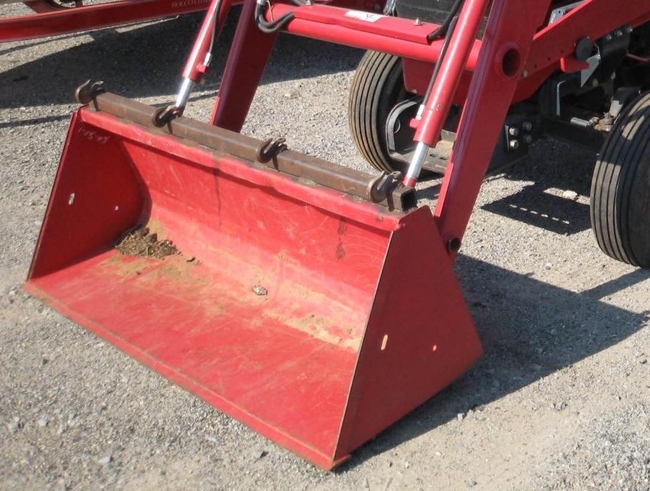

Although I was being a little silly, I think something to help indicate the bucket is level vs square to the tractor might be helpful. Especially when using pallet forks.
I don't have any type of indicator and haven't had any problems, but something like that might be useful.

Put your cell phone or android tablet on bucket and use angle/level indicator app (but hard to see from seat).... But if you really need to see where pallet forks are in relationship to what you are picking up would be camera on bucket and display on dash (backup camera facing forward)...

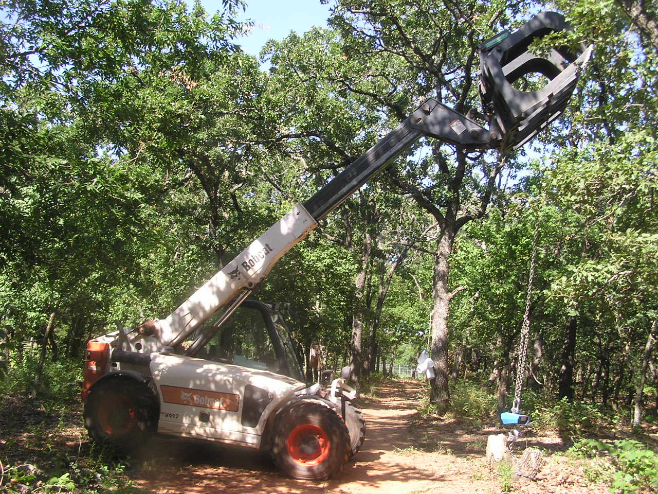

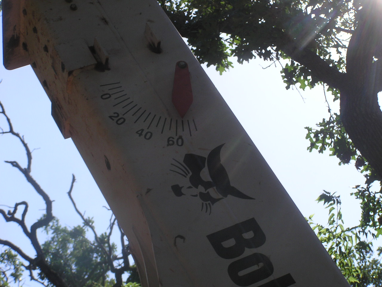

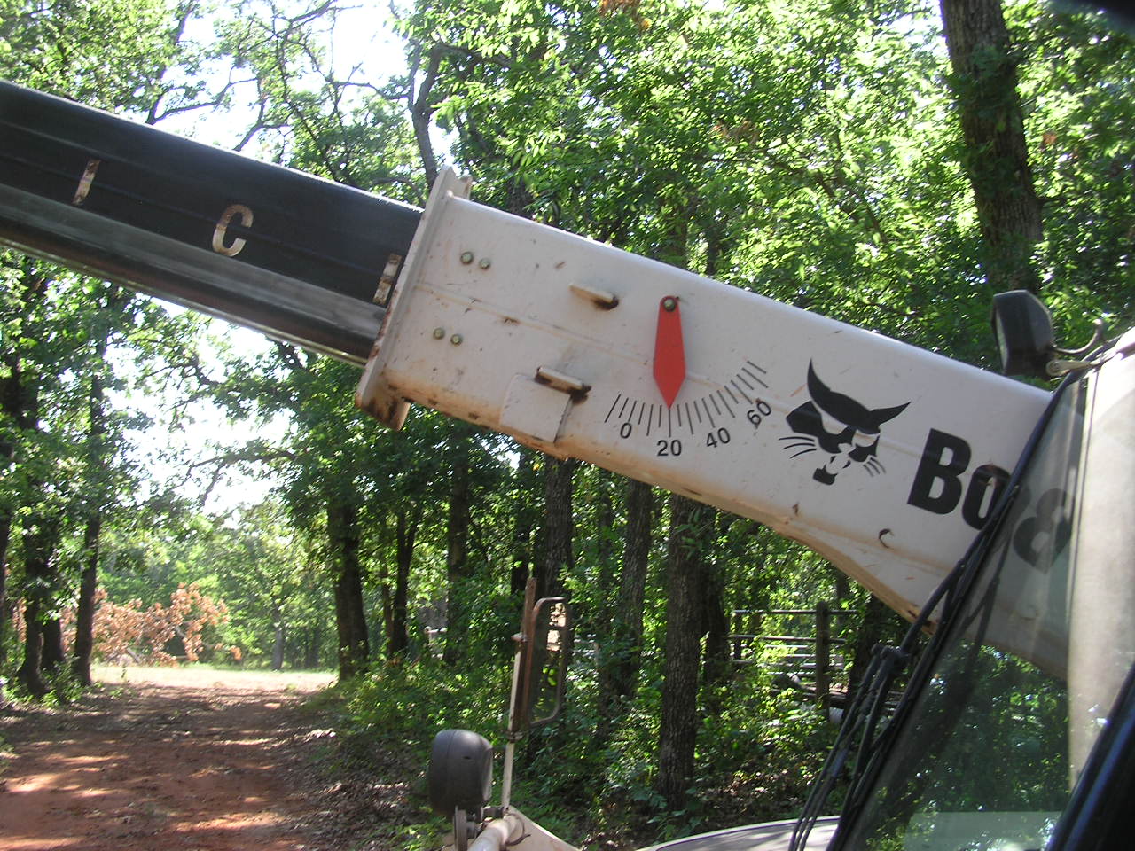

My compact telehandler uses a gravity pointer for boom angle also:
But does it indicate when bucket (or forks) are parallel to ground?
Dale
No, it just indicates boom angle relative to the center of the earth.
I use the top of the bucket to know what angle the bottom is at:
And can see the bottom of the forks from the seat:
