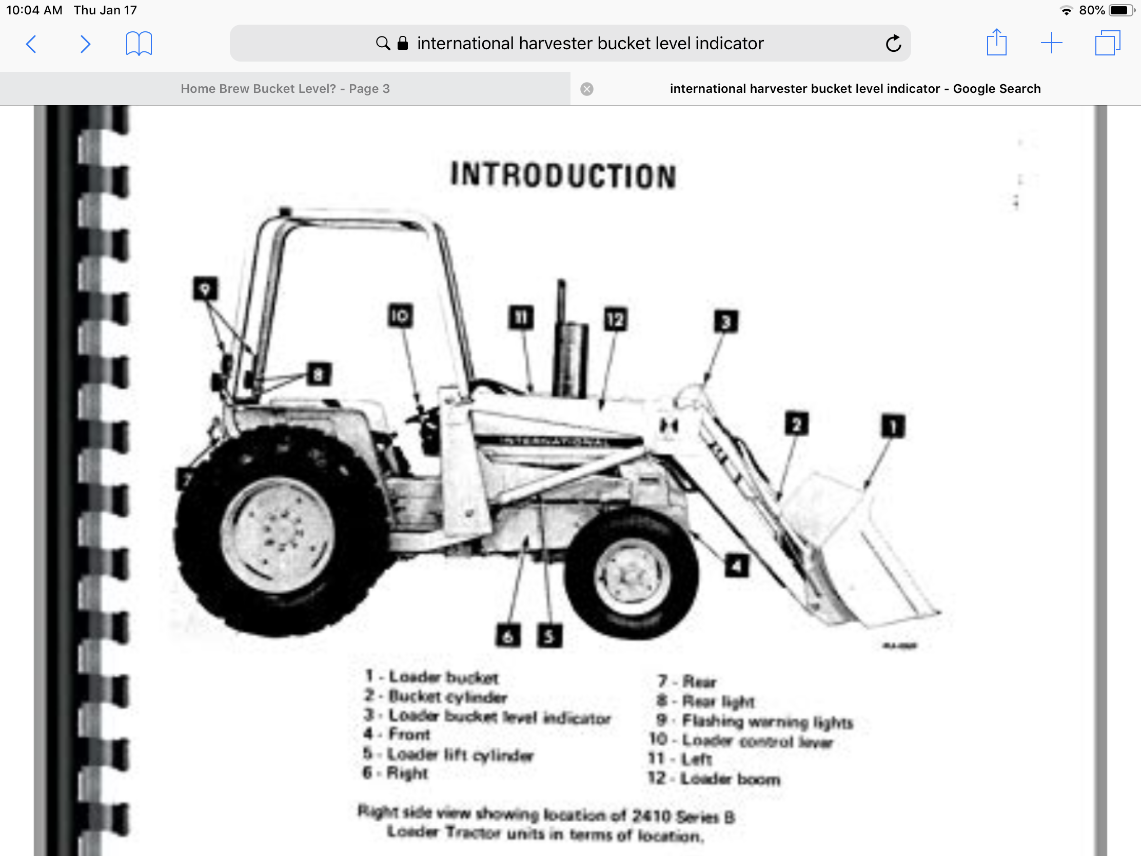

I had a bucket level indicator on our old IH2500b. There was a half-round piece of metal with indicator marks on a pivot hanging on the side of the FEL arm at the bend. There was a pointer for the marks fixed to the arm. There was a rod connected to one edge of the round piece and the other end was on the bucket bracket above where the right dump/curl cylinder attached, so the rod was parallel to the arm.
When you'd dump/curl the bucket, the rod would make the disk rotate on the pivot, and the marks would move behind the pointer. It was pretty handy.

HA! For kicks I googled it and found a grainy image from an IH manual that shows one on a different model, but it's the same thing. Item #3 in the picture.

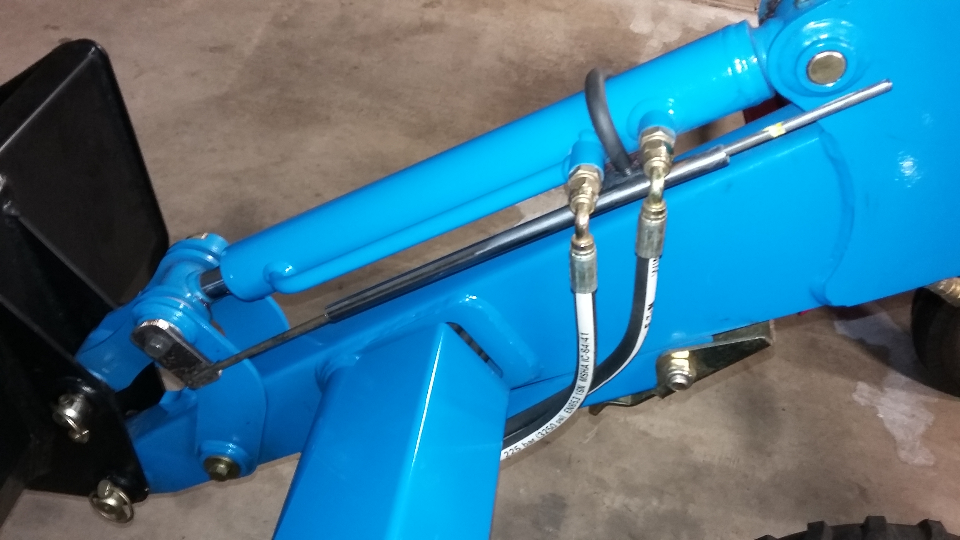

I have the tube with rod. I have thought about cutting a slot into the tube so that I could see the end of the rod. For the hay spear to be level, the rod is below the end of the tube. However, after loading, moving and unloading 90 rolls of hay, I think I will wait. After the first 20 rolls, I never looked at the rod.

I have a self leveling loader on my tractor, it's nice but has annoying characteristics as well, since the tractor is 45+ years old and the loader is 30+ years old there are a LOT of pivot points to flop around, a couple have the wrong size pins in them which doesn't help, but the self leveling linkages hurt the bucket travel, I can't tilt it back very far... I'm sure the geometry leaves some to be desired as the bucket tilt won't lift much either...
I get used to the "level" of the bucket when working, but an indicator would be nice at times, just haven't gotten to making one yet.
