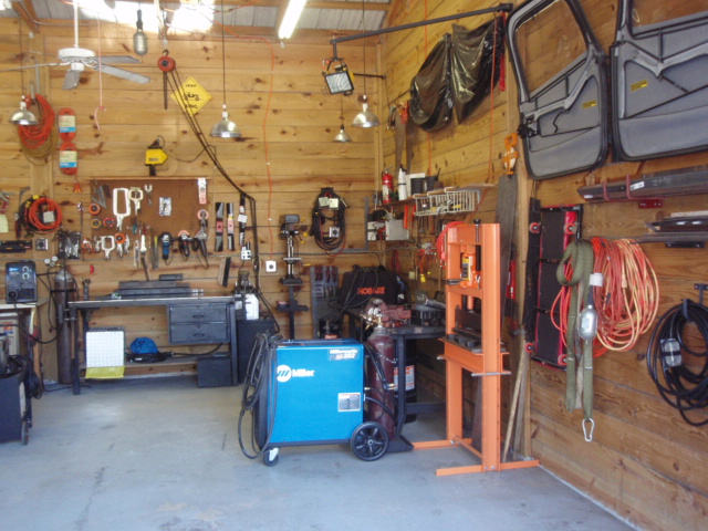

The problem with getting the HH140 is that this will start............. and there are No pills for this... Ok view.JPG

The problem with getting the HH140 is that this will start............. and there are No pills for this...<img src="http://www.tractorbynet.com/forums/files/welding/411364-hobart-handler-140-mig-welder-ok-view-jpg"/>
Not true. There are pills that will stop it, but unfortunately you won't be around to enjoy your tools. :(
Terry

The problem with getting the HH140 is that this will start............. and there are No pills for this...View attachment 411364
That's so funny & TRUE!! I got along for 30 yrs. without a welder just fine, but I bought a tractor, then some attachments, then a stick welder, then a dry-cut saw to cut steel, then 2 welding helmets, grinders, respirators, gloves, shields, carts, cables, stingers, ext. cord,welding blankets, clamps, cheap welding table, and some other stuff I can't even think of, all in the last 1.5 yrs.;)
