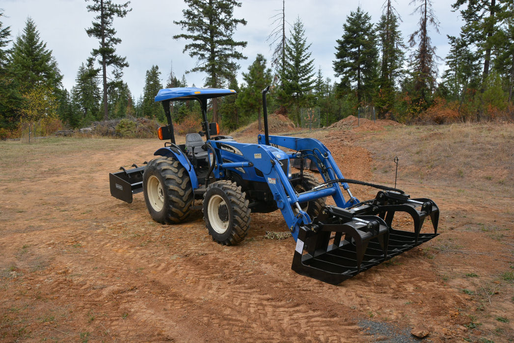

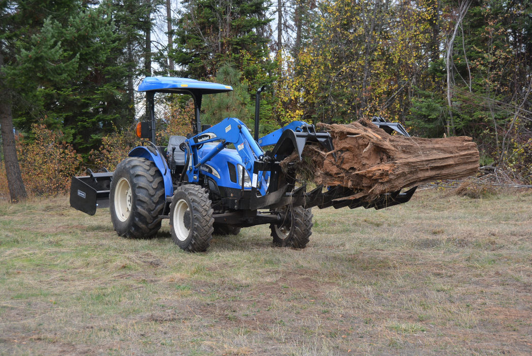

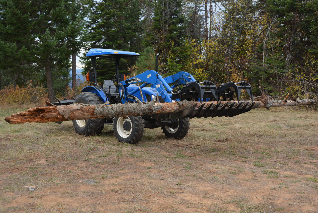

I received my tractor a while back so now it's time to post some pictures. I ended up with the TN75A with a 2G2 Gearmore hydraulic box blade, a Landpride 72" rotary cutter, a heavy duty bucket (SSQA), pallet forks and a 72" grapple. Grapple1.jpgGrapple2.jpgGrapple3.jpg

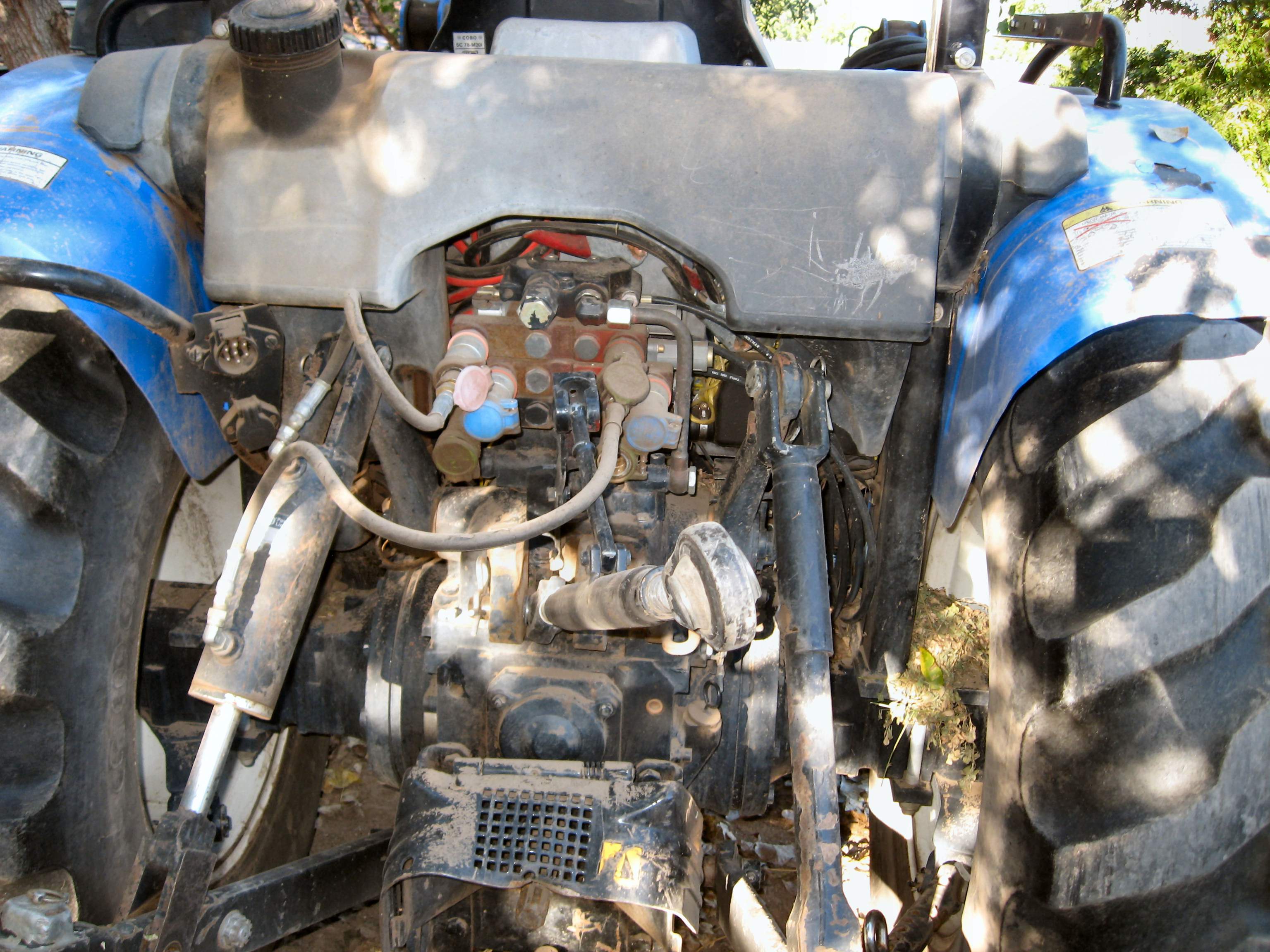

Hey Pappy. My rear remotes don't have any visible collar. They have a spring-loaded protective cover, but I don't see a collar like on a typical female quick connect. Is the NH unique, or am I totally missing something? Thanks,
Super nice set up you have there. Please post more pictures if you get the chance. Very nice.
Some of them are push/pull breakaway connectors. Perhaps yours are that way?
Yes you have push-pull couplers. For disconnecting, you push in and then pull out all in one quick motion. For connecting, just push the male end in. No outer sleeves to fool with. If you forget to disconnect from an implement, the hoses will disconnect on their own and no damage should be done to either end.
