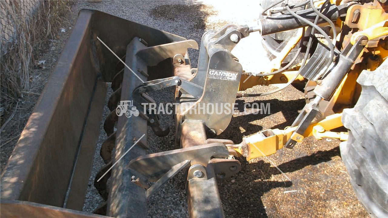

I do have the option to buy his used Gannon Box Blade with hydraulic 3-way. I forget the size, but he said the blade is $4K+ new and the cylinders are $1K/set to replace. I can pick this up (not literally) for $1800.
Gannon Box Blade with hydraulic 3-way doesn't make sense. Is it a box blade or a rear scraper blade?
If it is a box blade, it will have one hydraulic cylinder for raising and lowering the ripper mechanism. 3-way hydraulics would be on a rear scraper blade for angle, offset and tilt.
And, just to state the obvious, the hydraulic cylinder on the box blade requires one set of rear remotes, while the 3 cylinders on the scraper blade require 3 sets of remotes.
/ Help with Tractor purchase - newbie #70
I think that the seller may have a top & tilt set that should be going with the tractor anyway, and is considering those the other 2 cylinders. :confused3:
Yes, that is correct (at least that I see in the picture). Only one cylinder really runs the box (or rippers). The side plates on this look like 1/2", versus the 3/16" on the Landpride BB12 series. I had no idea how expensive all the implements are for these 'Swiss army knives'... Seems like you could make a box blade pretty easy if you are good at welding and know someone with a 2D plasma cutter.

I'm buying the Gannon (per you guys recommendation). Hydraulic control and I think 7'. Looks very heavy. 1a.jpg
/ Help with Tractor purchase - newbie #79
Looks like a heck of a good buy.
