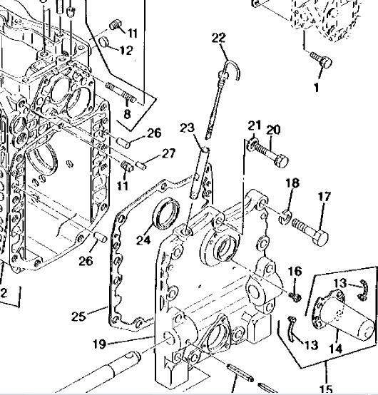

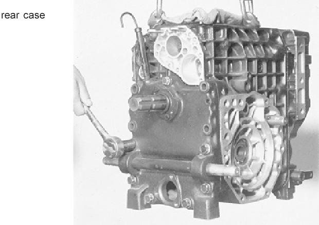

The dipstick on the transaxle that beenthere described is the dipstick to use to check the hydraulic oil level. The 855 uses a shared reservoir for the hydraulic implement pump and the transmission. Other than the engine oil dipstick, the only other oil level to check would be the front axle if it's a 4WD model. The recommended hydraulic oil is Lo-Viscosity Hy-Gaurd. Hold on to your shorts if you go to buy some... it's not cheap. I just priced a 5 gallon pail a couple weeks ago and it was about $100. The reservoir capacity is 4.5 gallons.

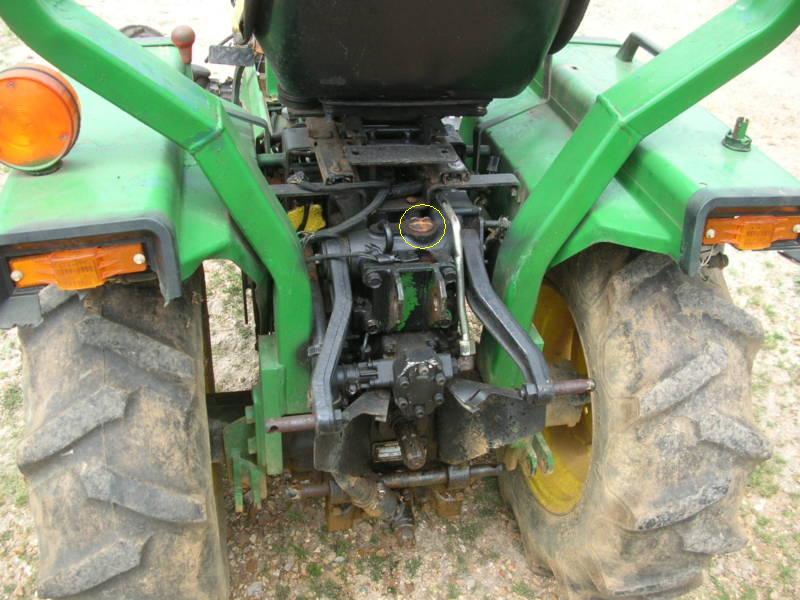

just picked up a JD 855 today. The aforementioned dipstick was showing empty. so I guess i have to figure out where to by lo viscosity hy-guard and add it through the dip stick hole? also want to change oil and whatever else I can do myself, and I don't have a manual yet. any tips on something simple like an oil change? first time tractor owner.
/ Help with JD 855 #13
JD will have all the fluids you need for it, if there is a dealer near you. There should be another port with a screw cap on it to fill the hydraulic fluid. I am pretty sure it doesn't go in through where the dipstick is at. Maybe someone else here can say for sure where it's located at, or your dealer can tell you.

Thank you. gotta find the place to add the hydraulic fluid. all foreign to me because it is first tractor. guy gave me tons of extra filters, but just discovered they are all for a different tractor! bummer! I must have 10 different filters for oil, and gas, and they are all worthless to me. well gotta find a store near me to buy hydraulic fluid now. wish me luck.
/ Help with JD 855 #15
If it's the same as a 955, it's at the back, directly in the centre and under the seat area. I had a cab, so I can't say exactly what to look for, but that's the area you'll find it in.
/ Help with JD 855 #18
to fill the oil.
/ Help with JD 855 #19
You can ignore the lower one on the side. It does the same thing as the one on the top.
