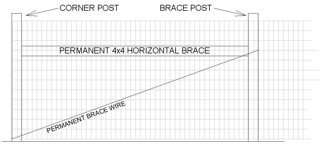

We are fencing in 6 acres for horses this summer. It's a big project and we're rookies, so I'm trying to ask advice from those who have done projects like this! We're in northern Michigan with mostly sandy soil. Our plan is to rent a post hole auger for our Ford 3600. Line and corner posts are 5"x5"x8' black locusy. They'll go 3' deep. Gate posts are 6"x6"x10' locust. They'll go 4' deep, I think. Boards are 5/4"x6"x8' white oak. We're going to screw those in.
Anyway, I'm not clear on how to brace the corner posts. I can't seem to find any drawings or advice on how to do this. Also, I did not order bigger 6"x6" posts for the corners, just the 5"x5". Will the 5x5"s suffice for the corners?
Also, I've read conflicting advice on whether or not to put cement in to secure the gate posts. Some folks say this will tend to gather water and rot the posts. Others say you really should cement them. Others say just tamping well will do. I've also heard adding crushed gravel or pea gravel will make a more solid bed for the posts. Any thoughts on this?

Since your soil is sandy, I'd concrete the braced corner sections' posts & the posts on all intermediate fence sections (in stronger soil I probably wouldn't use concrete at all).
Here's a drawing I did that was based on my using 4x4's for all corners, brace sections, line posts & the actual horizontal brace itself.
I did use 6x6's for my main gate posts, but only for looks. Concreted 4x4's with the horizontal brace member & diagonal brace wire shown are very strong.

Beppington-thanks for the drawing!
