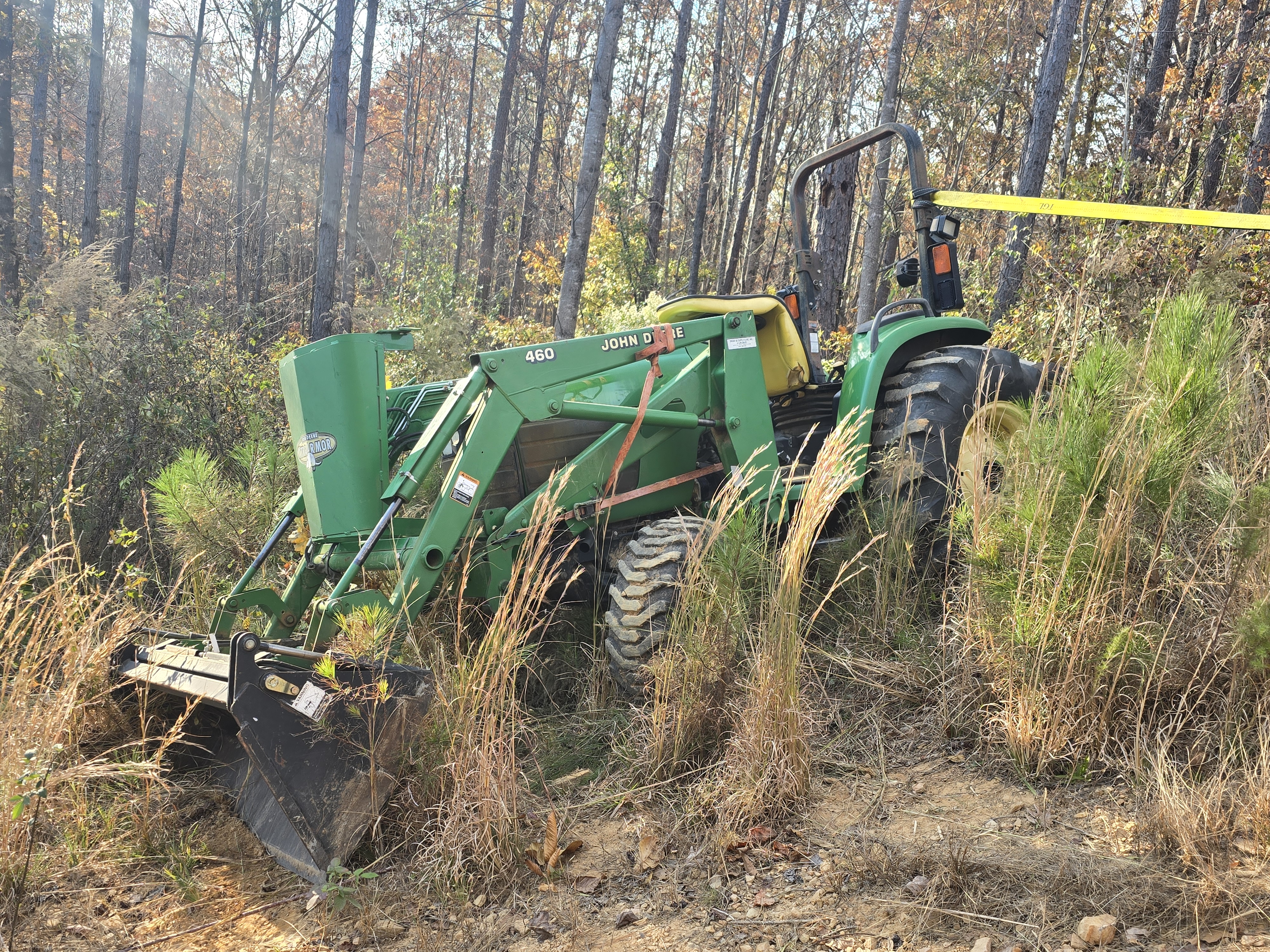

I'm glad you survived. Before you try to crank it, let it sit upright a while. It'll have engine oil on top of the pistons. If you try to crank it, it'll probably hydraulic the engine and bend a rod. I'd start by barring the engine over by hand until you get at least two full turns.
If that doesn't happen, then I'd loosen the injector hold downs so it can blead pressure out that way.

It is laying on it's side. How big of a winch does it take to pull it back upright? Was considering pulling on the loader mount at mid tractor.
If the winch you’re using doesn’t have enough pulling power to the weight of the tractor plus resistance, try a snatch block to double the pulling power. You’ve received some great advice from others too. I can’t add anything to their comments!!

For anyone who happens to want to know what worked to right a rolled Chinese diesel 25hp 4WD:
I've had to do it twice! The first time I called in a AAA large-size tow truck with their recovery cable led to a snatch block up on a pine tree above the tractor. No problem.
The next time my son rolled it. I wasn't there, but I told him to rig the rear mounted Harbor Fright 12,000lb electric winch to a snatch block on a tree, high enough above the tractor to pull it more upwards than sideways. He did that, and it came back up OK. There was enough battery power to the job.
One really good reason to have an AGM type sealed battery in the tractor is No battery acid leaking when it's on its side!

Using an "A" frame, along with winch or tackle, can simplify things by changing the angle of pull to a bit more upwards when trying to right things. This idea is commonly used when pulling stumps etc., but can be incorporated in righting vehicles as well. For a model, see 1 minute video:

When I was still living at home we used an H with a "loader" (manure scoop) to load round bales on truck. On one bale, the loader "swung" to the right a few inches and was just enough of a shift to make the tractor roll onto it's side. This was in a flat hayfield. We just used the truck (a 1/2 ton at that) with a bale in the back and a cable. Hooked it high on the wheel and gave a slow steady pull. Everything righted up. If you place your chain/cable up high somewhere it will come over with less force required than you might think. Might even be able to use a come-a-long with a chain or cable?
An H w/loader is probably similar in weight to your tractor.
/ Help - Rolled my JD4710. #52
Remember, you're not lifting the full #4000 Lbs, you're only rolling at most #2000 lbs.

Pull down through the rear wheel . That's your high point to low point. As mentioned, a come al9ng should pull her back on her feet.
I was going to say, strap the rear wheel, not the ROPS. If you do the ROPS you can over-pull, but it's much harder to do that with the rear wheel. Also stops the tractor from rolling forward once it's back with the rubber side down.
