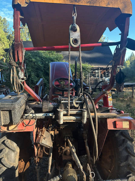

For anyone who happens to want to know what worked to right a rolled Chinese diesel 25hp 4WD:
I've had to do it twice! The first time I called in a AAA large-size tow truck with their recovery cable led to a snatch block up on a pine tree above the tractor. No problem.
The next time my son rolled it. I wasn't there, but I told him to rig the rear mounted Harbor Fright 12,000lb electric winch to a snatch block on a tree, high enough above the tractor to pull it more upwards than sideways. He did that, and it came back up OK. There was enough battery power to the job.
One really good reason to have an AGM type sealed battery in the tractor is No battery acid leaking when it's on its side!
The 12K winch mounted on my tractor. BTW a snatch block doesn't change the pulling force unless the end of the winch cable is anchored and the snatch block moves with the load. If it is anchored to a tree it only changes the direction of the pull if the winch isn't mounted to the tractor, and is coming from a separate vehicle.
