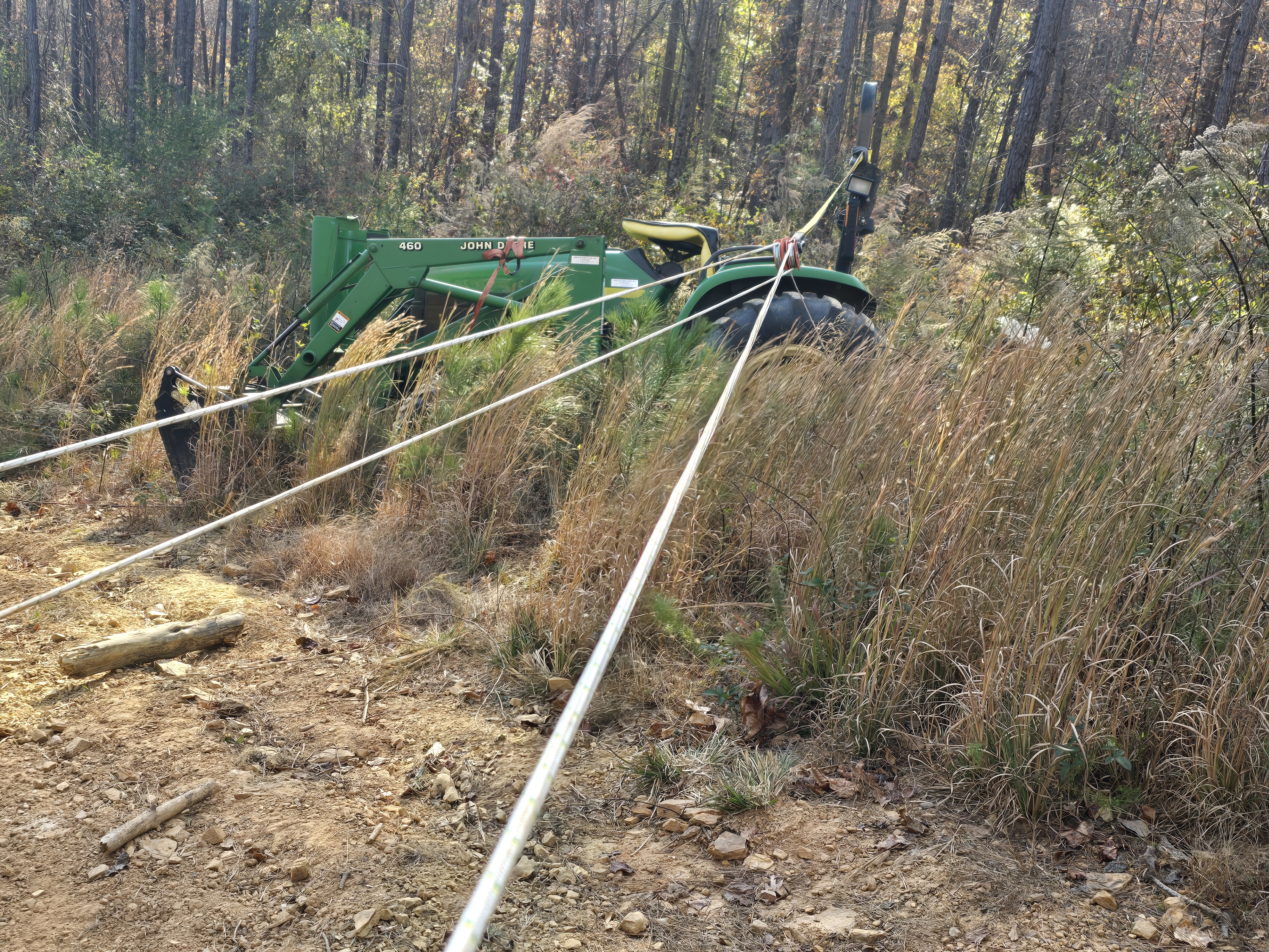

Appreciate all of the suggestions. Wouldn't have made it this far without this groups help. Couple of photos of the righted tractor and my capstan winch.
24 hours later and I got her back on her wheels. Any suggestions on the best way to slide her backend around so she's more up and down the hill where maybe I can winch her up top?

Post some photos of the right side of the tractor when you get a chance.
I'm glad you're making progress. Keep a few straps on the uphill side of the tractor until you get it in the clear.
I'd probably strap the 3 point hitch and rear blade to the ROPS to lift it up enough that it won't get in the way. You may find something to strap the bucket to, or you may be able to simply drag the tractor backward.
I haven't tried to steer my tractor much without power. I have a self propelled baler that has zero steering without power. If pulling your tractor backward, the wheels will probably follow fairly well. You can manually push on the wheels to steer, or use a strap to turn them. Or, perhaps a strap to the steering knuckle to keep the wheels turned while you pull it straight.
I have a Harbor Freight 12,000 lb APEX Synthetic line winch that so far has been doing well for me. I made a 1 1/2" custom receiver mount for my trailer attached to a large piece of channel that I made into a winch mount. I also made a couple of D loops on the back of the channel that gives me a good tie down to use the winch in portable mode, tied to trees or vehicles.
I had an earlier 12K ZXR winch that died at a most inopportune moment. So far the 12K APEX is doing well.

To pull the backend around you might just do the same thing you did to pull it upright but hooked up down lower. Move your winch setup off to the side also so it’s pulling more sideways.
I am considering running a strap through the rear rim plate for a pulling point. Hopefully that won't damage the rim.
/ Help - Rolled my JD4710. #37
I'm wondering if a few smaller logs behind the rear wheels would act as rollers and allow it to "skid" sideways a bit towards the road as you pull on it.

Instead of a few small logs, do you have flat piece of metal like a car hood? The old timers used to slide things with a car under them. Jon
