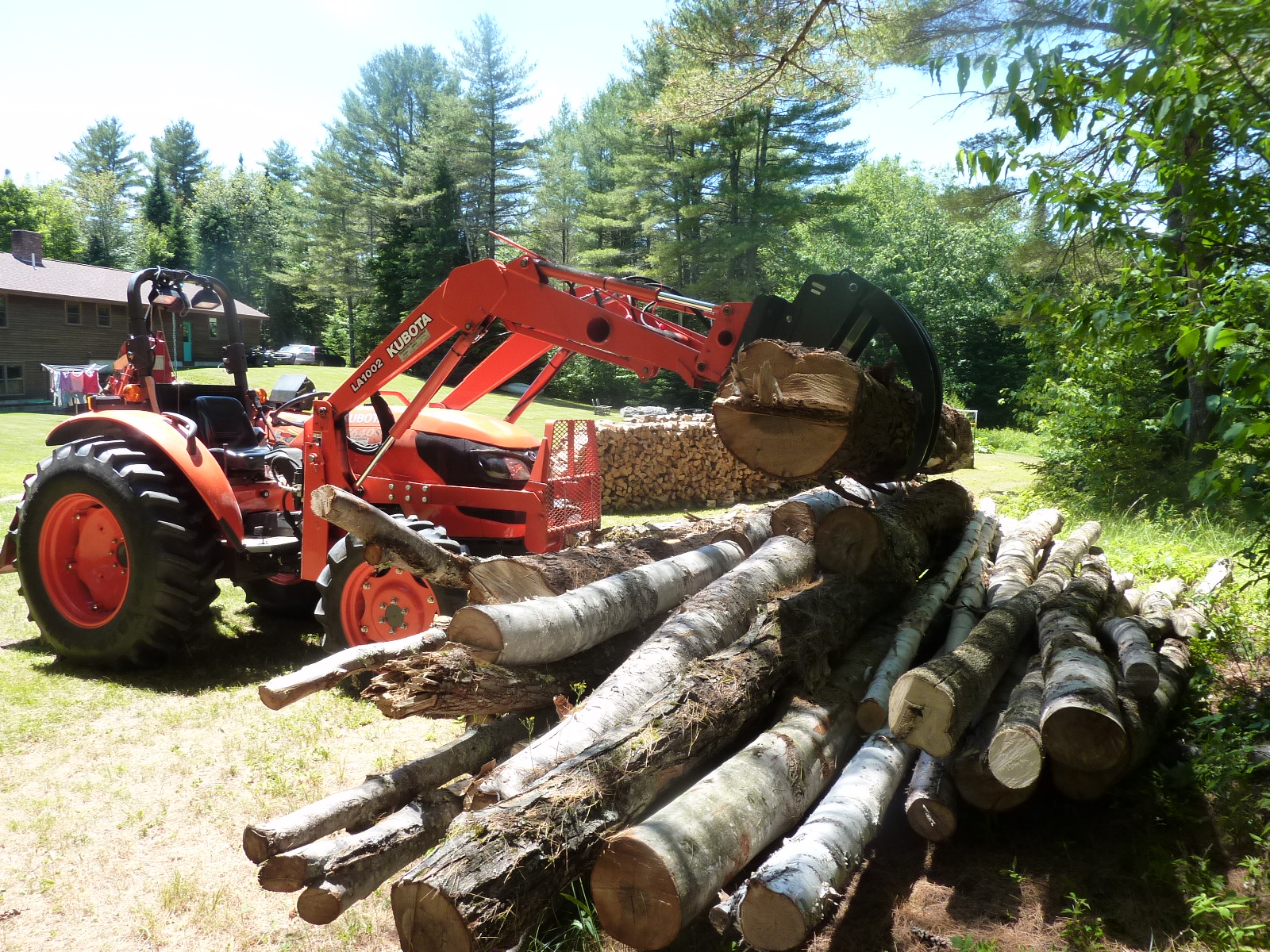

I’d love to know more about that frost bite grapple. Do you know the grade of steel? What size machine it’s rated for? Cylinder size? It looks well rinforced and I love the simplicity of the 3 point of contact design for logs and rocks. How is it for small stuff like piles of 2-3 inch branches?
I would have to research that but you probably can to. It is made in Latvia I believe and it is pretty rugged. Small wood ....

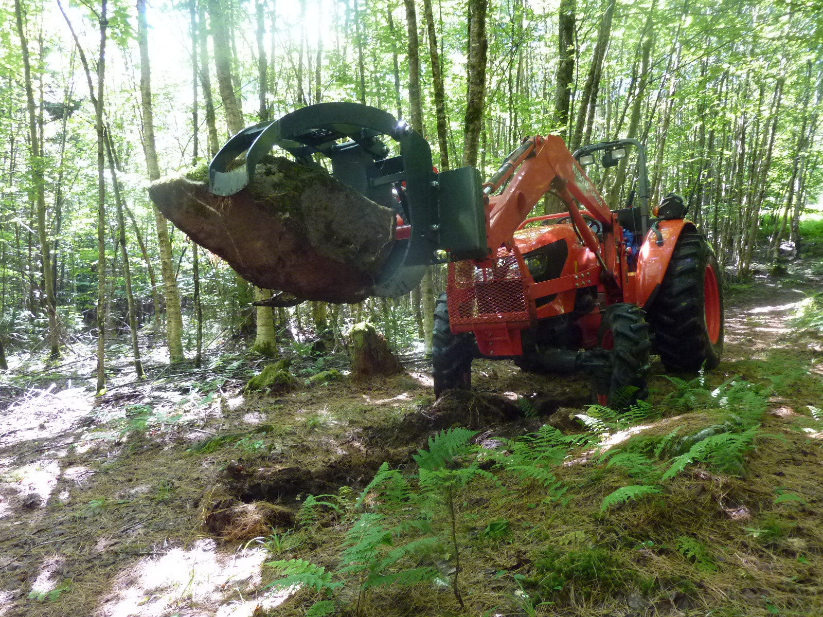

My main tines are 1/2? The in between pieces are less. Don稚 know what steel it is but probably nothing fancy. As far as impaling things, I can see that with hay bales but nothing else. I can scoop up anything. And my argument for a narrow one is it digs much better, when trying to uproot a 6 tree. Kinda like digging is easier with a spade than a snow shovel. But if you don稚 dig and only scoop, a wide one is fine. But my 48 will scoop up a bigger pile than you can see around. The other problem I would have with the unconnected tines is that when I knock down a tree, the first thing I do is push it from high. Then back up, plunge under the root ball, and curl up while inching forward. Those widely spaced tines would not allow that. The tree would wedge between them and bend them. I don稚 care what steel it is, for a big tractor will bend it.
As far as two thumbs, my narrower one doesn稚 need it. Once I grasp it, it goes no where. Now of course a wide grapple needs two.
I'm definitely going narrow and single lid. I do push over trees on occasion and my stump bucket is my favorite tool for pushing them over or digging out the ball if needed. However, if the tree is small enough to pry out of the ground in one motion then forks are my go to. It's amazing what you can pry out of the ground with a set of forks! I like to stick my forks about half way under each side of the ball and use the dump and lift function while driving forward to pry the other side of the ball out of the ground. I calculated that I'm getting something around 12,000 pounds of lift this way.
The tree in the picture came up in one motion...

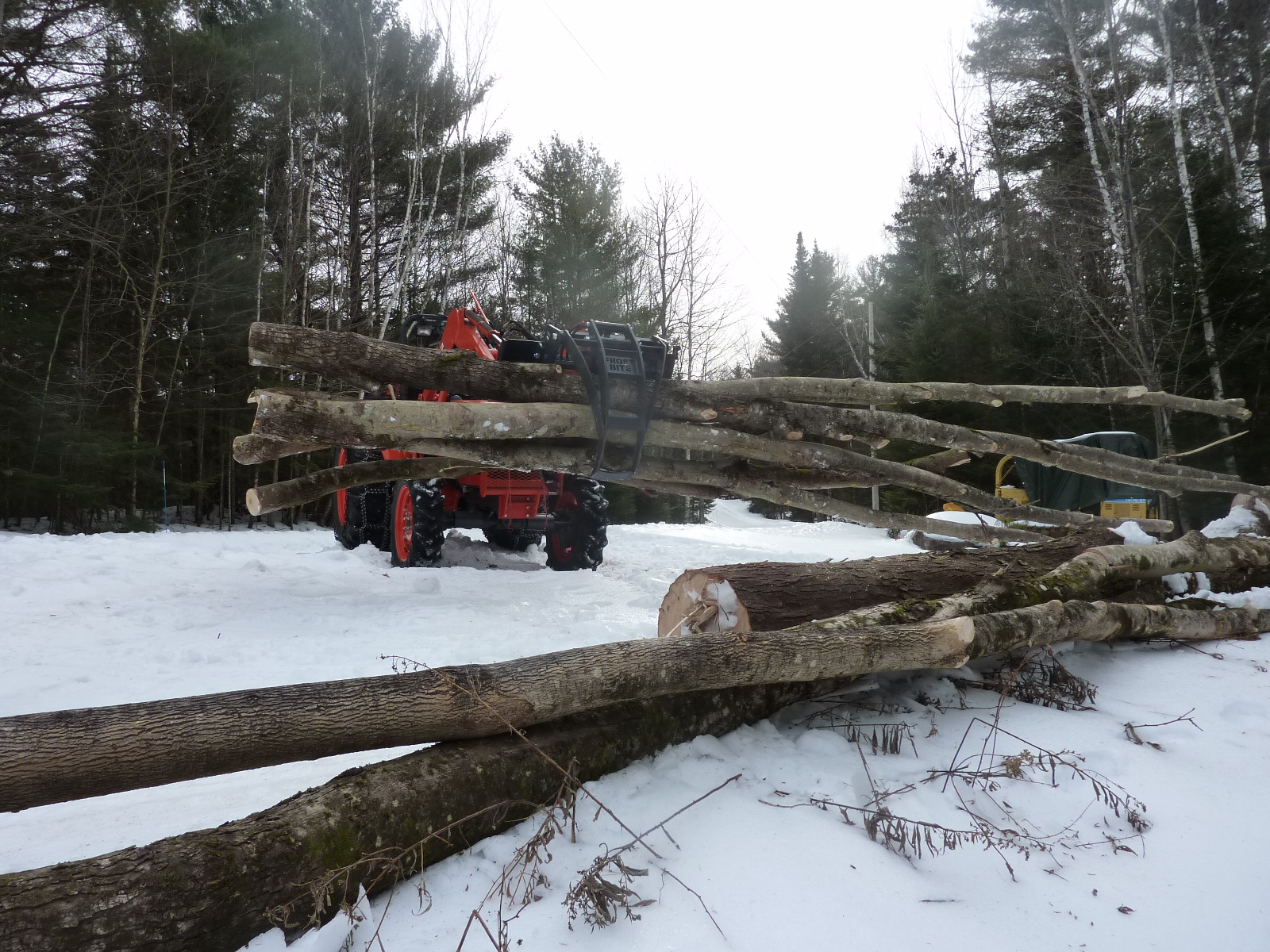

I'd strongly second the Frostbite, which is in fact a knockoff with some minor improvements on the Igland GR-20 that I've had for years now, and have never bent any part of it; have added the extension feet on the lower 'arms' and find to be basically indestructible on my tractor.
I push it so hard at times I have to be real careful to not let an entire tree take over by its weight and position, and need to watch I don't allow the forces twist the loader and flip the tractor on it's side if something goes wrong.
The GR-20 is the AR400 steel, I can't say for sure what the Frostbite uses, but it looks identical to mine except for color. Mine is flat black, the Frostbite is grey.
Here's a video of it, and it's optional 'grab plate' (and arm extensions) to put between the two lower arms for picking up smaller items, rocks etc.
Igland GR2 Grapple - YouTube
I've also got Igland's winch, which is also a monster as far as strength and durability. I actually broke off the swedged cable end on one log pull that hung up the cable and snapped the end. Easily repaired with proper cable clamp positioning, but I would have liked to keep the original end; oh well...
I find the grapple on front, the Kioti KB-2485 hoe on the rear, with Mie's 'ripper tooth and hydraulic thumb give me everything I need to rip, tear, lift, uproot and destruct any tree, rock or most other ground items in the way or wanting to be dug or carried.
I'm confident you will NOT be disappointed by your choice in the Frostbite. It has bushings I've been told, that my GR-20 does not have. To date, the grease fittings have kept my grapple in excellent shape with no loose joints. I've had it near nine years to date and not one issue with it. I did add expanded metal to keep sticks from poking into my radiator, and added same to my Kioti front grill pushbar as double layers of protection. That has served well in both cases.:thumbsup:
Check my avatar. It shows the grapple pushing logs further into my burn pile. Not highly recommended- I've burned up both tie-rod rubber boots over the years from that over zealous act. :confused3:

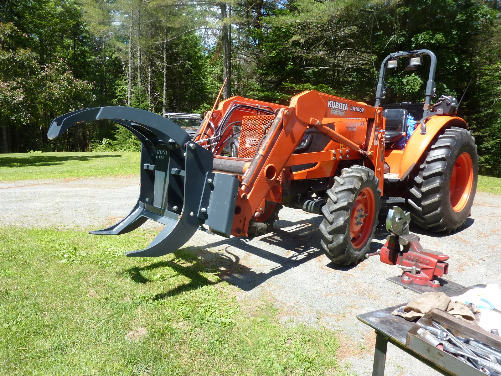

I realize this is an old thread... but I finally pulled the trigger on a Frostbite! I bought it through FrostBite Grapples - Grapple, Log Grapple and Todd was very responsive and answered all my questions. Delivery was quick about 1 week and everything looks to be as requested. I can give a positive recommendation for Todd and frostbitegrapple.com
One thing I like on the Frostbite is that the hoses are threaded so you can change to different couplers in the future if you like. Unit looks very, very strong. I doubt there is any possible way I can hurt it with my little 45hp tractor. And at under 400 pounds, plenty light for my 2700+ pound full height lift.
I still need to get hoses to run it on the loader. I'll throw it on the 3pt to see how it works once I can get away from work for a bit (have an SSQA on the 3pt too)
