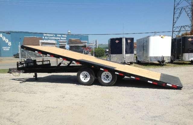

Both a deckover and drop deck will haul the TLB just fine if thats the main goal.
I think you need to look long and hard at what "other" uses you have for the trailer.
Hauling pallets, or long material (beams, logs, culvert pipe, etc) the deck over is better IMO. When hauling something that is the length of the trailer, or a tad longer....like the 25' steel beams I bought to build my crane, They would have been hard to unload with the forks on a drop deck, as the fender would be right near the mid-point where I need to get in there.
A drop deck also limits you on pallet placement if you haul stuff on pallets. Makes it harder to get a good load balance with limited side access.
On the other hand, if the trailer is used alot to haul cars, especially lower profile ones, you will find it difficult at times getting them onto the higher deck of a deck-over trailer without bottoming out and rubbing .

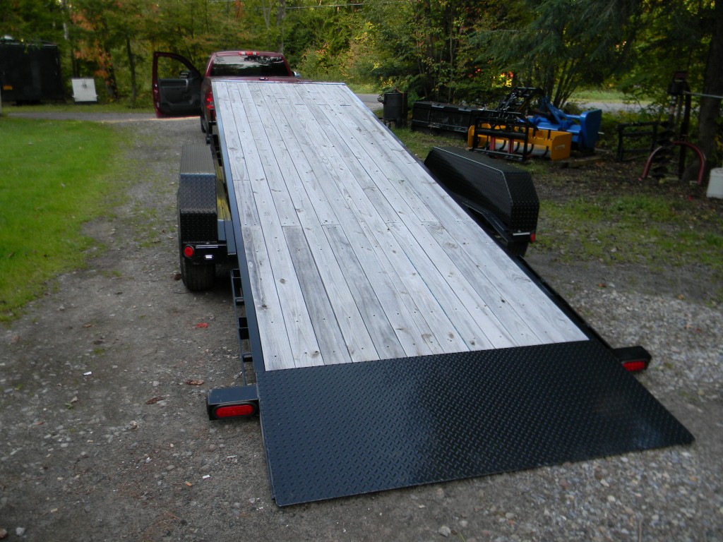

Congrats on the new trailer.

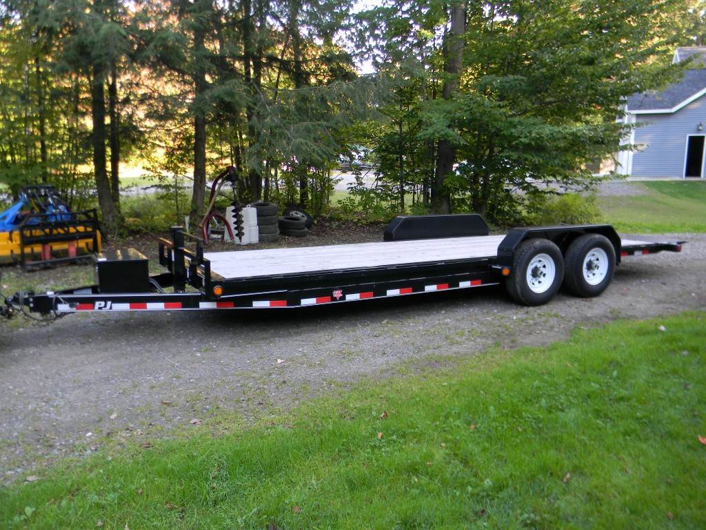

I have the PJ 22' TF model (Actual size 23'9" bed incl.tail) 14K full tilt but I know your not fond of PC trailers. 82" between the fenders.
Don't get me wrong, I don't hate PC trailers. I've owned several PJ's a was close to buying another. What really got me thinking about going paint over was when I got the quote for the options on the PJ.
I wanted them to put the hydraulic pump in a box under the deck as they do with the GN version. Then I wanted to have an additional box on the opposite side of the trailer under the deck. That sent the cost up over 10k, so I mentioned I'd just add the boxes on my own later. Then I came to the realization that welding them to frame was going to be an issue with the PC.

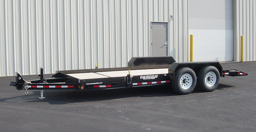

I love my low tilt trailer for hauling my tractor and heavier loads. trailer2.JPG I also have a deck over I haul my side by side, 4 wheelers and fire wood on. On the deck over I have walls and ramp made. I have hauled my smaller tractor on the deck over a Kubota b3030 but I prefer the tilt trailer trailer 1.JPG

If I had a dealer close to me I'd be looking hard at a Moritz International with the adjustable tail but there isn't a dealer within 100 miles and the one dealer I reached out two had zero interest in selling me a trailer. I'm going to place the order for the low pro Cam Superline on Monday. The trailer will do everything I need it to and I won't loose the load capacity of the other trailers I've looked hard at. Corn Pro was another manufacture I looked hard at but the closest dealer was just under 100 miles and specialized in horse trailers. They were also trying to pass off a 2014 trailer as new so that was a bit of a red flag for me.
I was able to stop by my wood pellet supplier who has several low pro tilt Cams and he was extremely satisfied with them overall, his trailers are well used and looked great except for paint. These are all 8+ old and use for 15-30 k miles per and worked hard. He loads pallets on them with a fork lift and offloads at customers with a powered pallet jack.
If a Gooseneck was an option I'd likely got with 20+5 with adjustable dovetail but I just can't get the GN in my current place. Cam's seem to hold their value so I'm sure it'll be a good investment. Thanks for all your advise!
