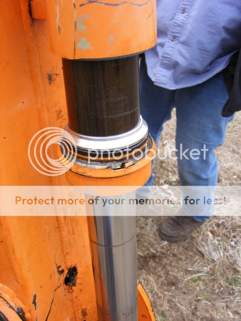

Hello all,
i wish this wasnt my first post here. I have a kubota L2800 TLB and will soon be looking at buying a CK25 or 30. However, I can't ask a bunch of questions about that now as I am being screwed by a rental company.
So here is the deal.
I rented a 35hp HST Allmand tractor with 9 ft BH when Kubota was being used by father in law. When I went to use the backhoe to dig up a small maybe 300 lb rock that was about 6" below grade the tractor began leaking fluid. Since it happened just after the first time i curled bucket i thought it was water in the bucket or something. When I jumped off I saw the bucket cylinder had broken. Thats my story and now I am being pursued and encouraged to file homeowners claim. Which would get paid at now cost to me if I was found liable, but I feel like Im being taken advantage of.
I have been told I "dead-ended" the bucket. When it was explained to me I was confused, either I pushed the BH too far or I over extended it. I'm not real clear on what he is saying.
I have put the kubota through the paces and thats a lesser BH than this one, if you push the BH it should go to bypass right?
I truely did not abuse this machine, but I dont know enough to discuss what actually could have happened.
Pic 1
Pic 2
Pic 3
Pic 4

Welcome to TBN. Looks like something fatigued and failed...... mettle on the gland, barrel or service persons at rental place. Cylinders usually have tell-tail signs of problems and sometimes just "gut them-selfs" with alot of normal use, not counting rental service. Thats how they try to get out of paying for there own negligence. One person beats the holy livn tar out of it, opon returning it the rental place inspects it mabe, washes the machine up good, mabe some paint, and then the next guy rents it and gets blamed for all. I would have some words:D

You are being screwed, dead ending a cylinder is complete BS. There is an internal bypass valve in the hydraulic system that when working properly will prevent a "dead ending" type failure. There could be problems elsewhere in the system that could have caused this type of failure. I would suggest you post this in the Hydraulics section of the forum.

Its hard to tell from the pics, but, it looks like the metal is discolored from corrosion. If it is, that has been like that for a while, and just happen to break when you used it.

"Normal" wear and tear on a rental machine to me. The head of the cylinder can get fatigued from the piston contacting it and let go in a manner such as yours. The relief should have gone to bypass if the cyllinder was at maximum extension, but there still is some force put on the head/cushion. Not your fault, just happens over time.

Looks like the retainer ring and part of the head broke. Ive had that happen on a small rental hoe that a friend bought from a backyard rental store. The whole cylinder head came out. The ring had mauledthe grove when it came out but the head was good didnt have and thing to keep it in. I cut a round washero ut of plat and left a hole for the rod and welded it back on. There no way that just happened that was abuse from many users. I saay screw the rental company to, they should have insurance for that and replace your lost time. I went through this with RSC one time over a locked fuel cap on a t190 loader. They charged me 85 for a fill up on it when I did leave them 10 gallons of fuel in buckets. THey didnt have the tank unlocked and said that was the wages on the work to refill it. I also sentthem a bill for the landscaping their pick up man ran over the lawn to,.

I really hate to disagree with some of you on why the cylinder blew out, but it is very possible that the cylinder blew out by what is called ram force. That is when the bucket, or whatever is attached to the cylinder, is used as a ram force, and can exceed the relief pressure . Ram force also occurs when you are dropping a load fast and you release the handles suddenly while dropping. The spike generated can and will destroy some things, whatever is the weakest. I am not saying that it happened, but that it could.
If you want to see this in action, just put a gage in the cylinder circuit and drop a loaded bucket and then catch it before it hits the ground. The spike generated may very well exceed the pump output pressure and or relief settings. This is no BS.
The reason that the reliefs don't protect all the time is because they are designed to relieve a small amount of fluid and can not handle the pressure/volume from a cylinder acting as a ram.

The retaining ring gave out, simple as that. There is nothing you did wrong. If there was excessive pressure in the system, either the rod would have bent or the barrel would have split first. They're trying to hose you and get you to pay for something that just happens to equipment. It gets old and breaks, simple as that.
When new cylinders are manufactured, they are usually tested to 1.5x their rated pressure for at least 5 minutes.
JJ, that theory would hold except for it's the wrong end of the cylinder. Ram force from dropping a bucket would not put any excessive pressure on the gland end of the cylinder.
