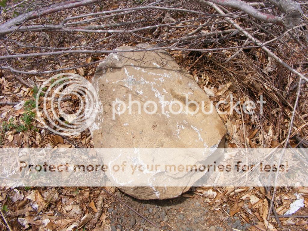

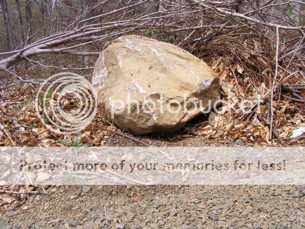

Just to clear some stuff up. I had the rental for 1 hour when I began to use the BH. I used it for less than 1-2 min and it broke. I did not abuse it. I had a project I needed to finish and had limited time off work. The rental place encouraged me to continue to use the FEL to finish my job. I ended up returning the tractor after using it for most of the day.
No one is disputing how long I used the BH. Just how it was broken.
I have a claim into my homeowners and he has one into his rental insurance company.
I know the damages are large so far, at least over $500 in labor already and that was before cylinder was sent out.
I will keep you all posted and thanks for the kind words.
