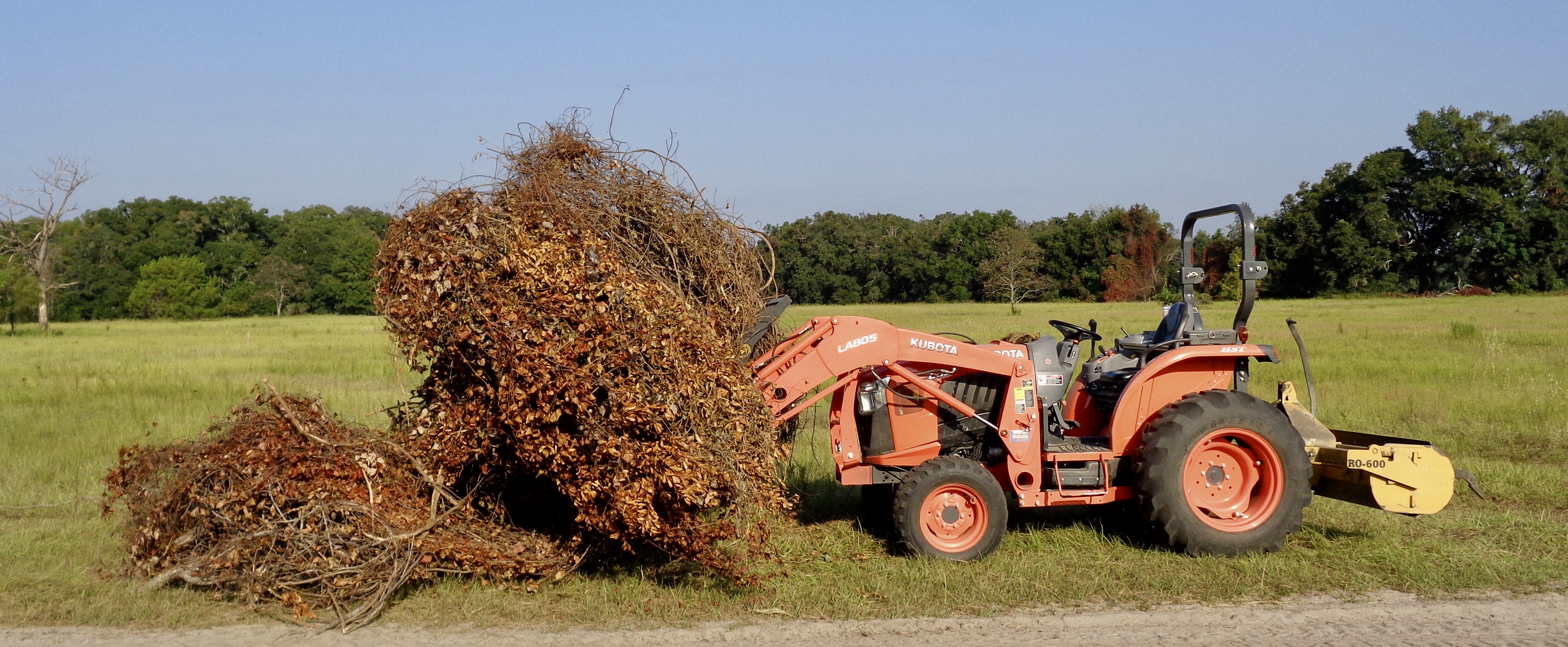

My current tractor is a Mahindra 1526 TLB. It has been a good machine and paid for itself several times over. I looked at the newer 1626 and it is the same Mitsubishi as my 1526 with a few ergonomic changes.
These Mahindra models are 2,400 pounds bare tractor weight with 25-horsepower.
The equivalent Kubota models are the L2501/L3301/L3901.
2,700 pounds bare tractor weight with 25/33/39 horsepower.
In a heavier, deluxe outfitted tractor there is the Kubota 'Grand L' L3560.
3,500 pounds bare tractor weight with 37 horsepower. For commercial operation the L3560 would be my choice. The HST/PLUS transmission substantially improves tractor efficiency where an HST transmission is the appropriate transmission choice.
"Kubota Grand Ls are full featured tractor models. The HST+ transmission is the best that's currently being made for compact tractors. Telescoping lower links and sway bars. Worth a lot when hooking up, and will reduce your swear word vocabulary. Air-ride seat, more ergonomic loader control stick location at the operator position. Not that the standard L's are bad, just the Grand L's are more refined."
Within subcompact and compact tractor categories, a significant tractor capability increase requires a bare tractor weight increase of 50%. It takes a 100% increase in bare tractor weight to elicit MY-OH-MY!
When considering a tractor purchase bare tractor weight first, tractor horsepower second, rear axle width third, rear wheel/tire ballast fourth.
