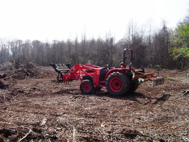

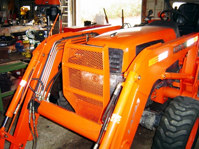

I also welded expanded metal to the brush guard after a branch pushed through and almost hit the radiator. It made me paranoid. After using the grapple some more, I welded about 4 extra angle iron slats to the back portion of the grapple to help hold the debris in, especially when pushing. I think it helps to keep limbs from pushing through and the dirt and small stuff can fall through as before. Mine's a WRLong root rake grapple. Great design, by the way.

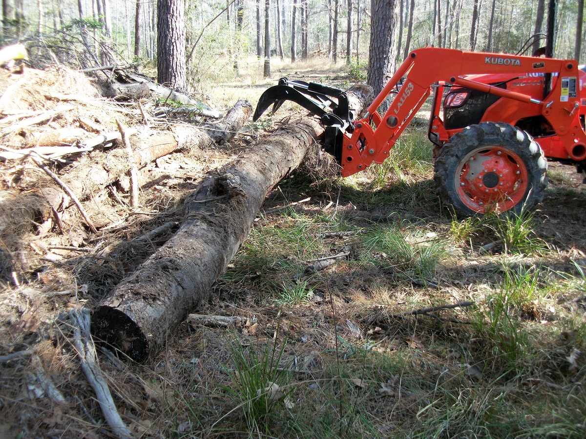

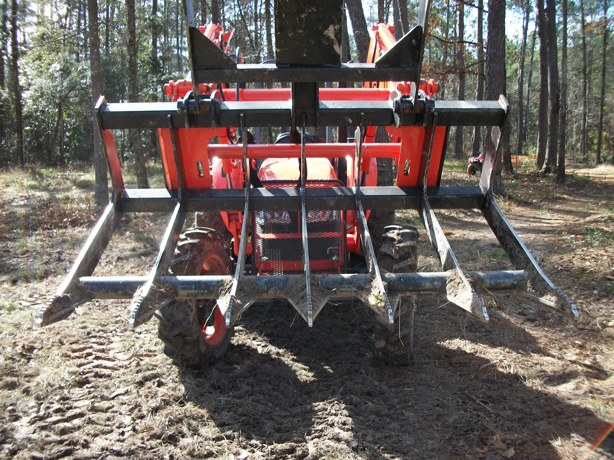

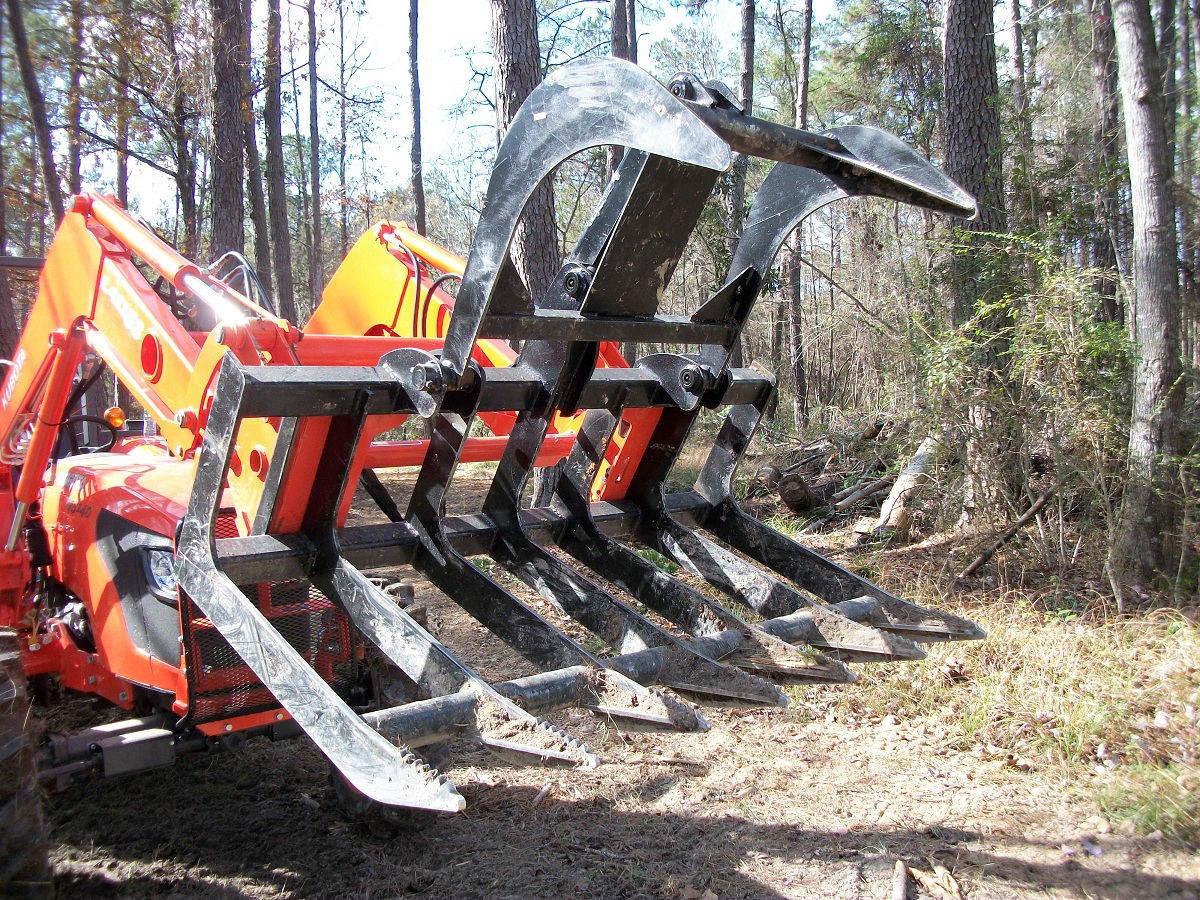

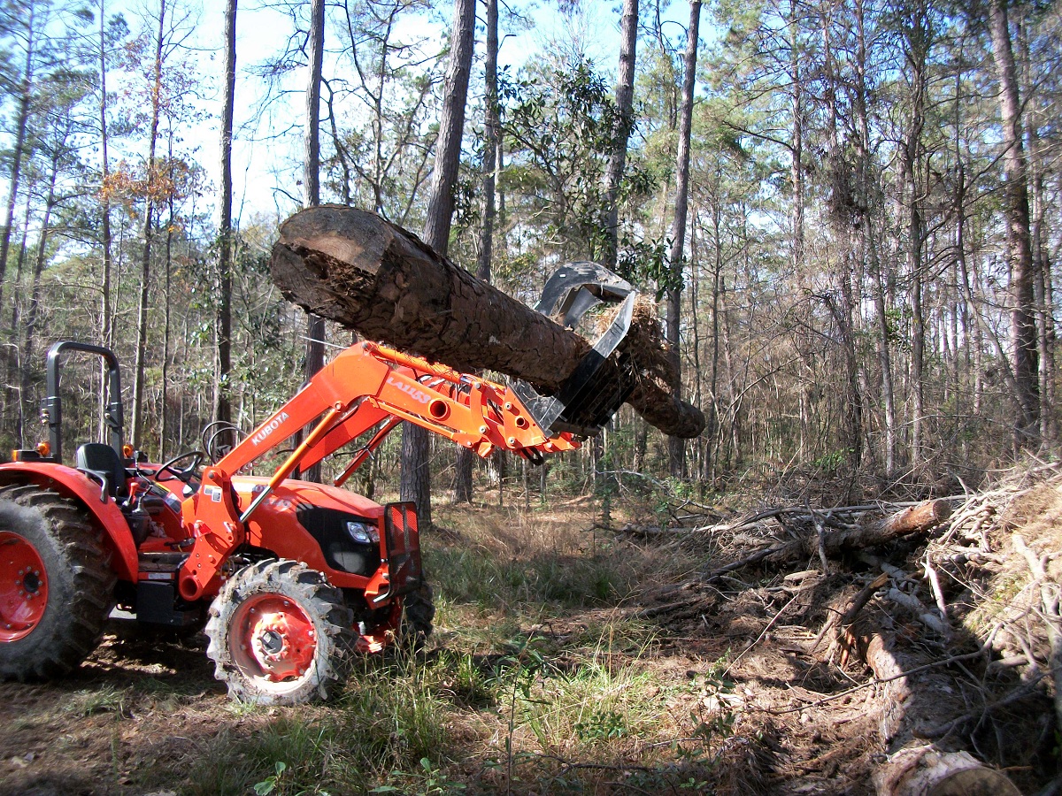

I feel like I've just added 10 years to my life span with the purchase of the gator grapple. I'm mad at myself for not purchasing one five years ago. Thanks again, to all the fine gentlemen here at TBN that helped me decide on which grapple would best suit my needs.
